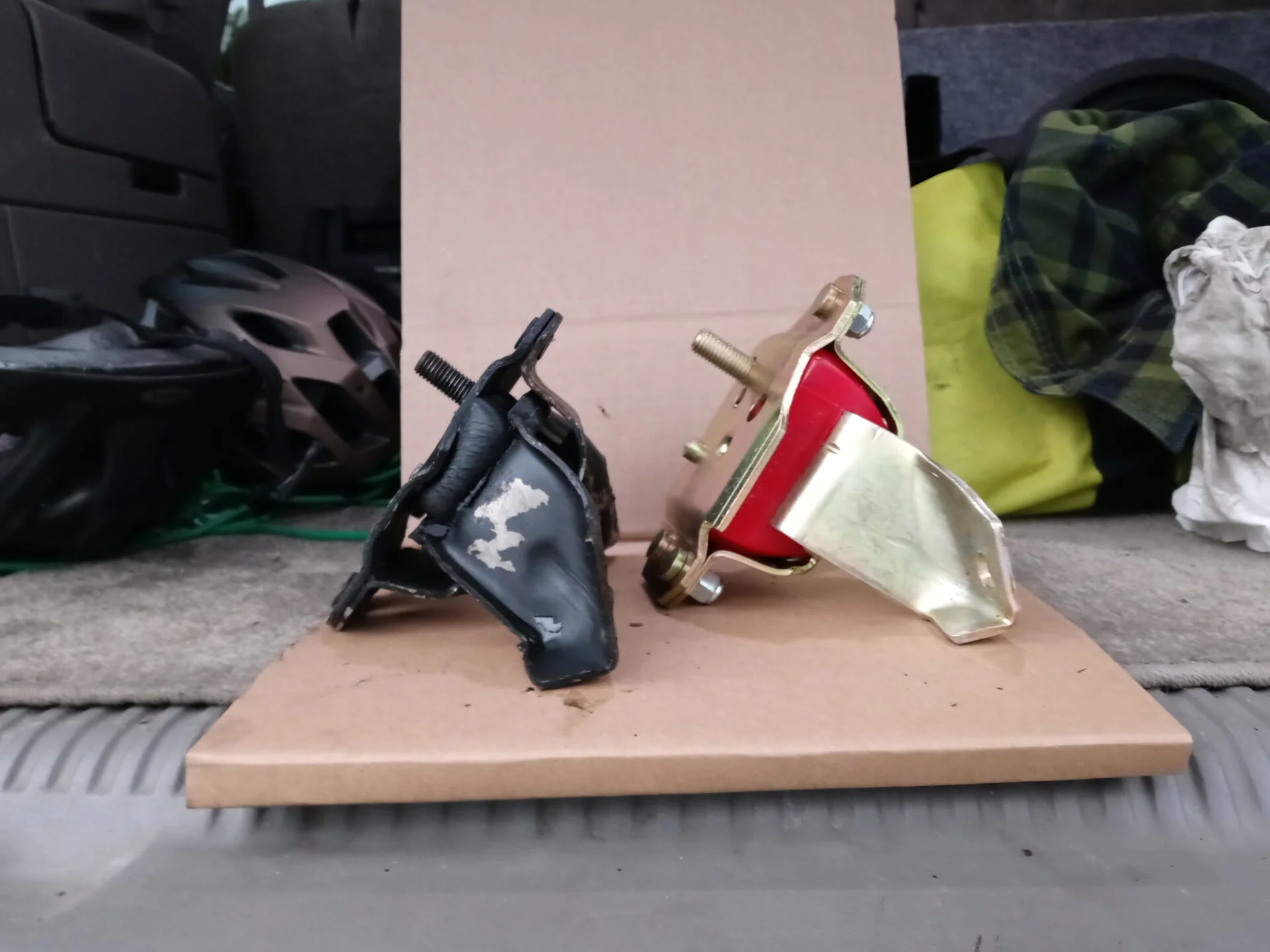

I just changed mine energy suspension engine and trans sits up nice and straight .... I’ll have the car started in a week but I’m quite sure I’ll be happy with them ....the rubber ones did seem flimsy

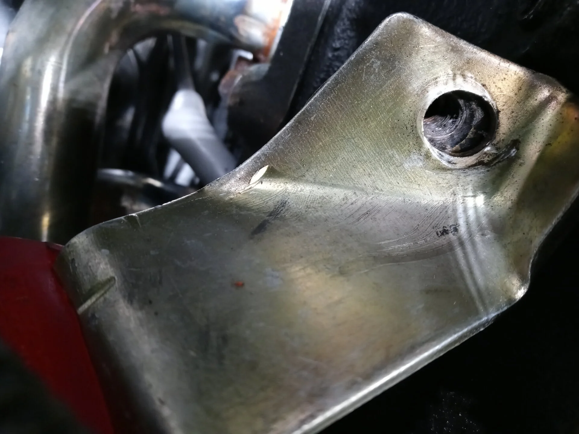

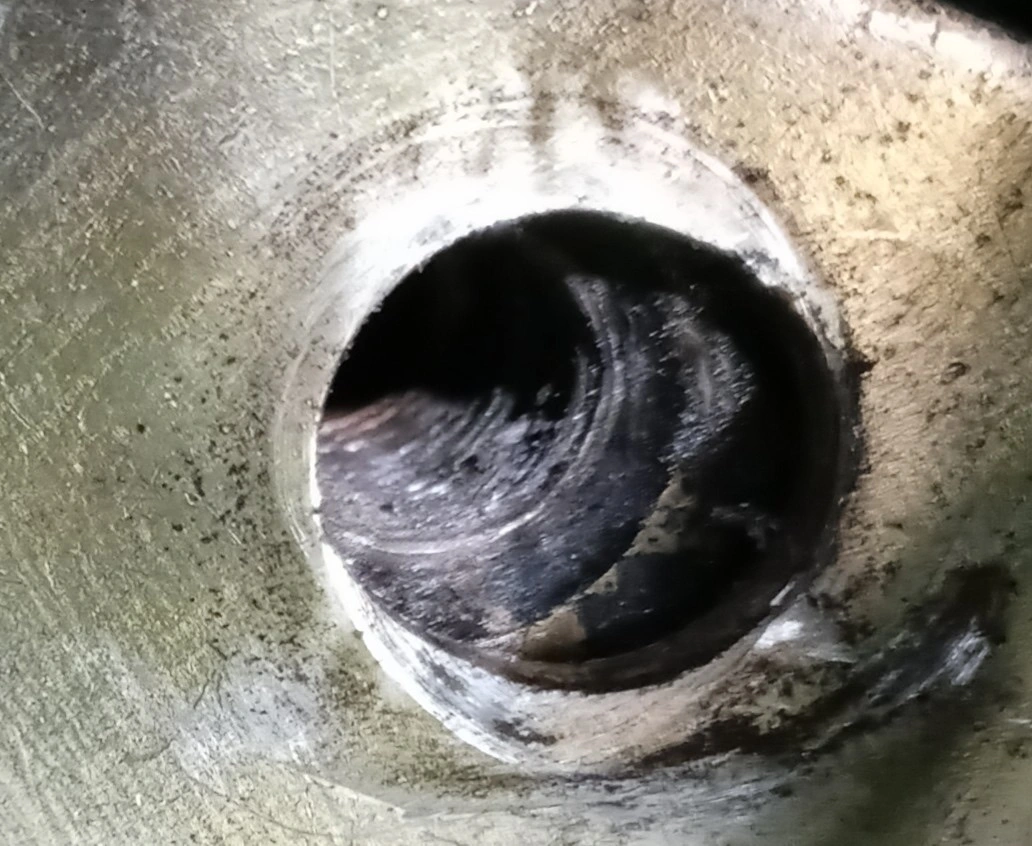

One of the bolt holes engine mount was stripped now I have to heli coil or time sert the stripped threads :mad::mad::mad:
Into steel, I would use a helicoil. Another car group I belong to debated which was best to repair aluminum block threads for head studs. A machinist did destruction testing on various repair gadgets into aluminum, and the Timecert was the strongest. But with sideways (sheer) force rather than pulling forces on this bolt hole, steel to steel seems like a better choice. Besides, no electrolysis will be involved.

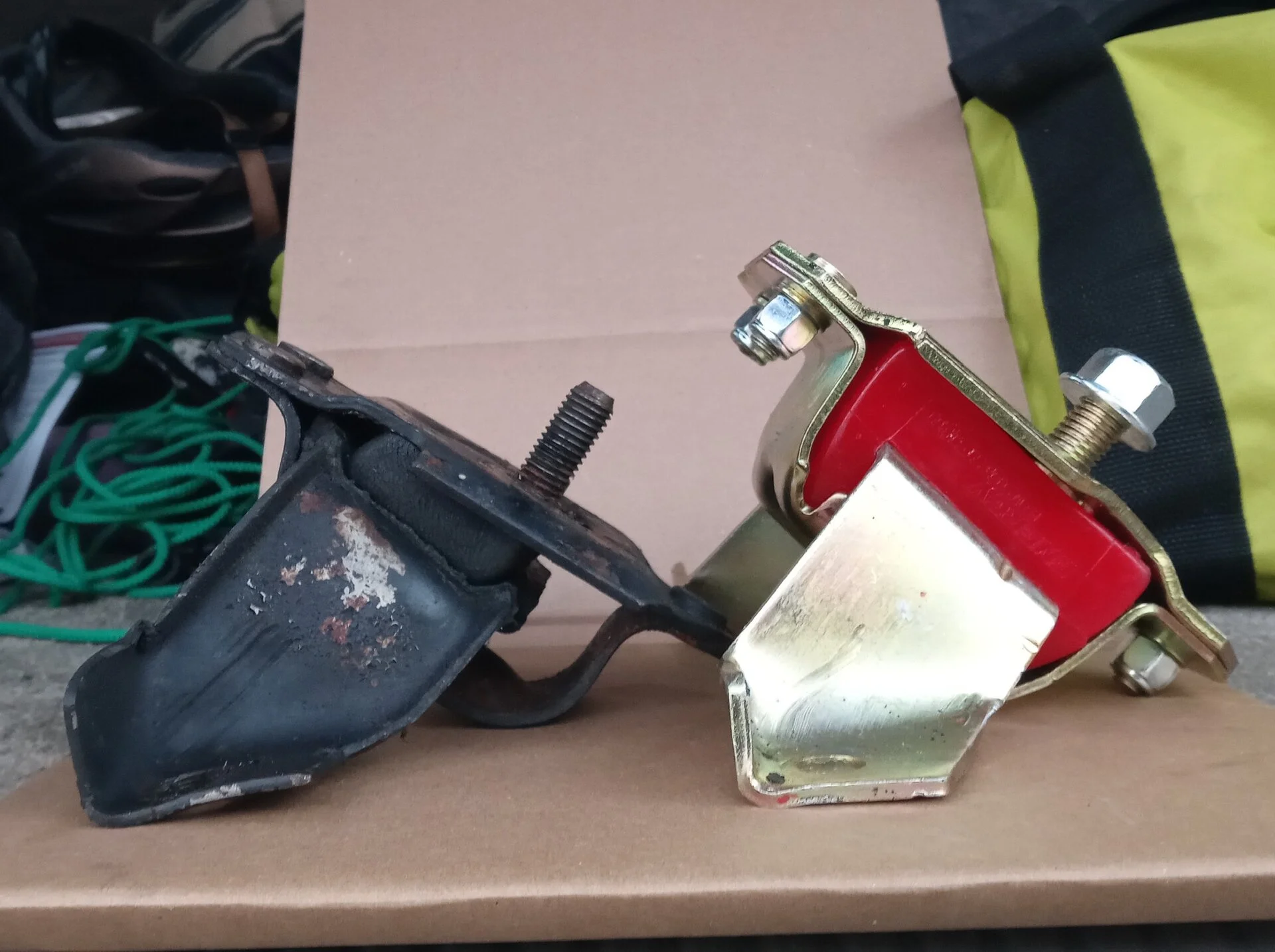

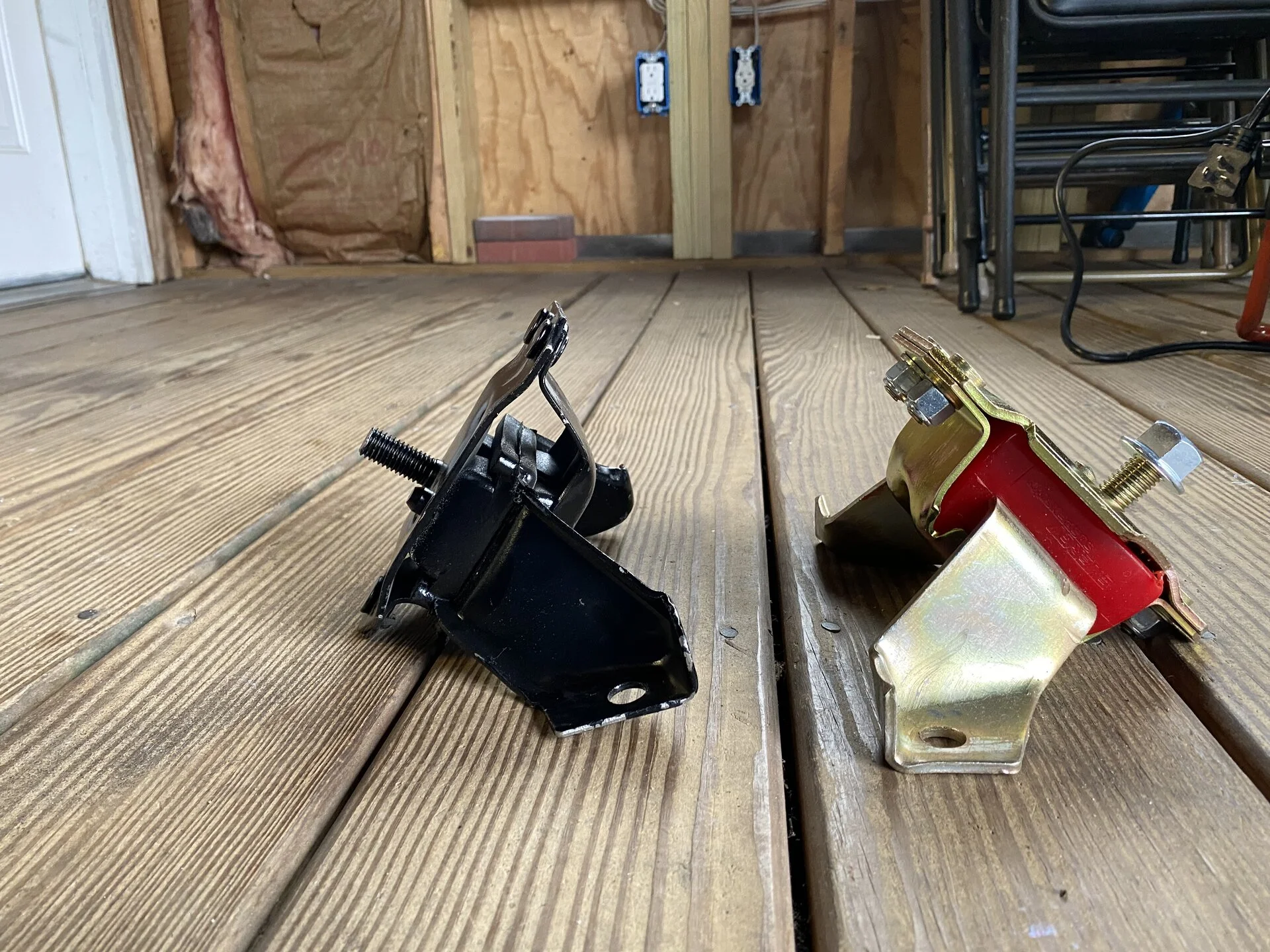

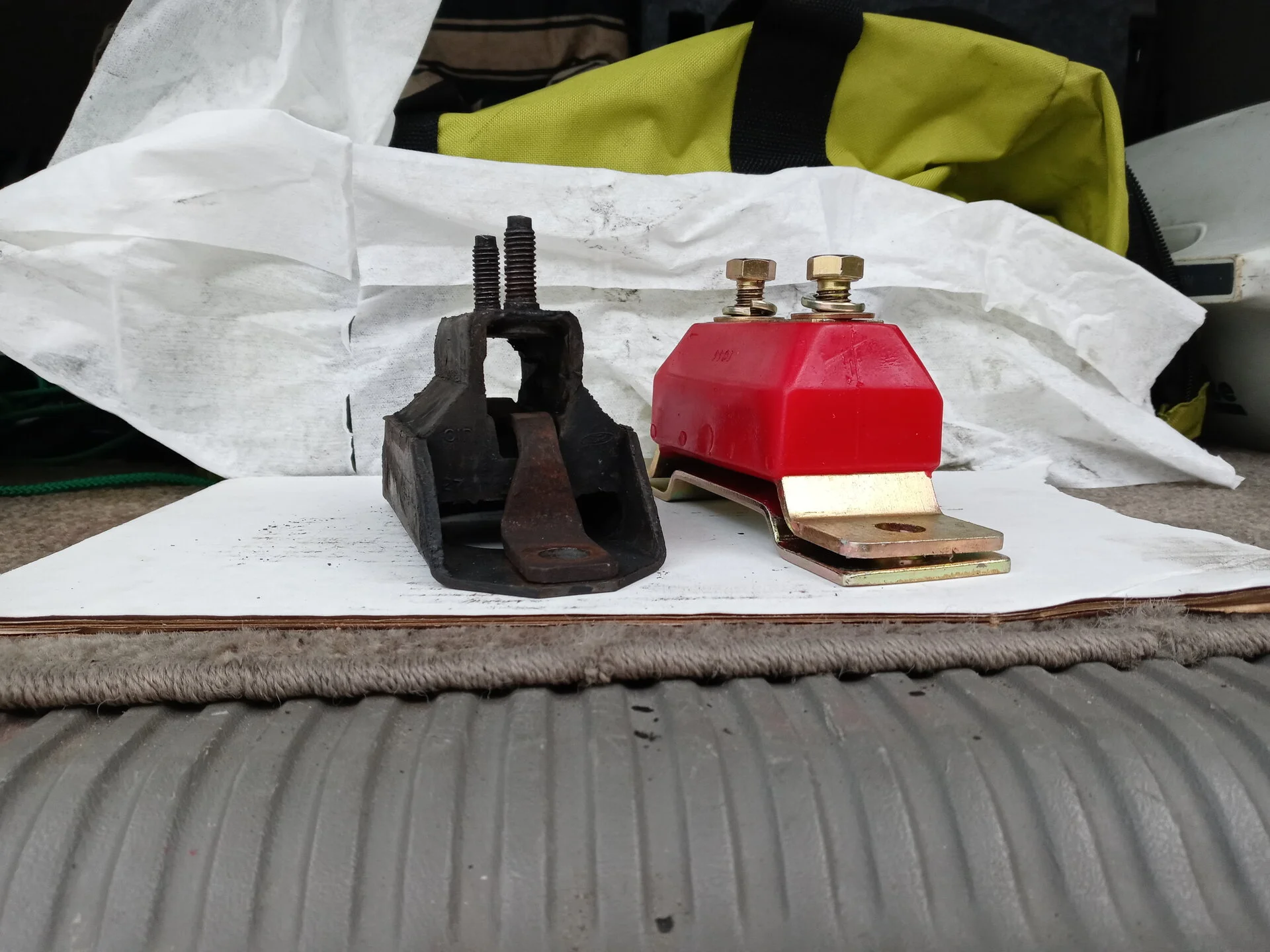

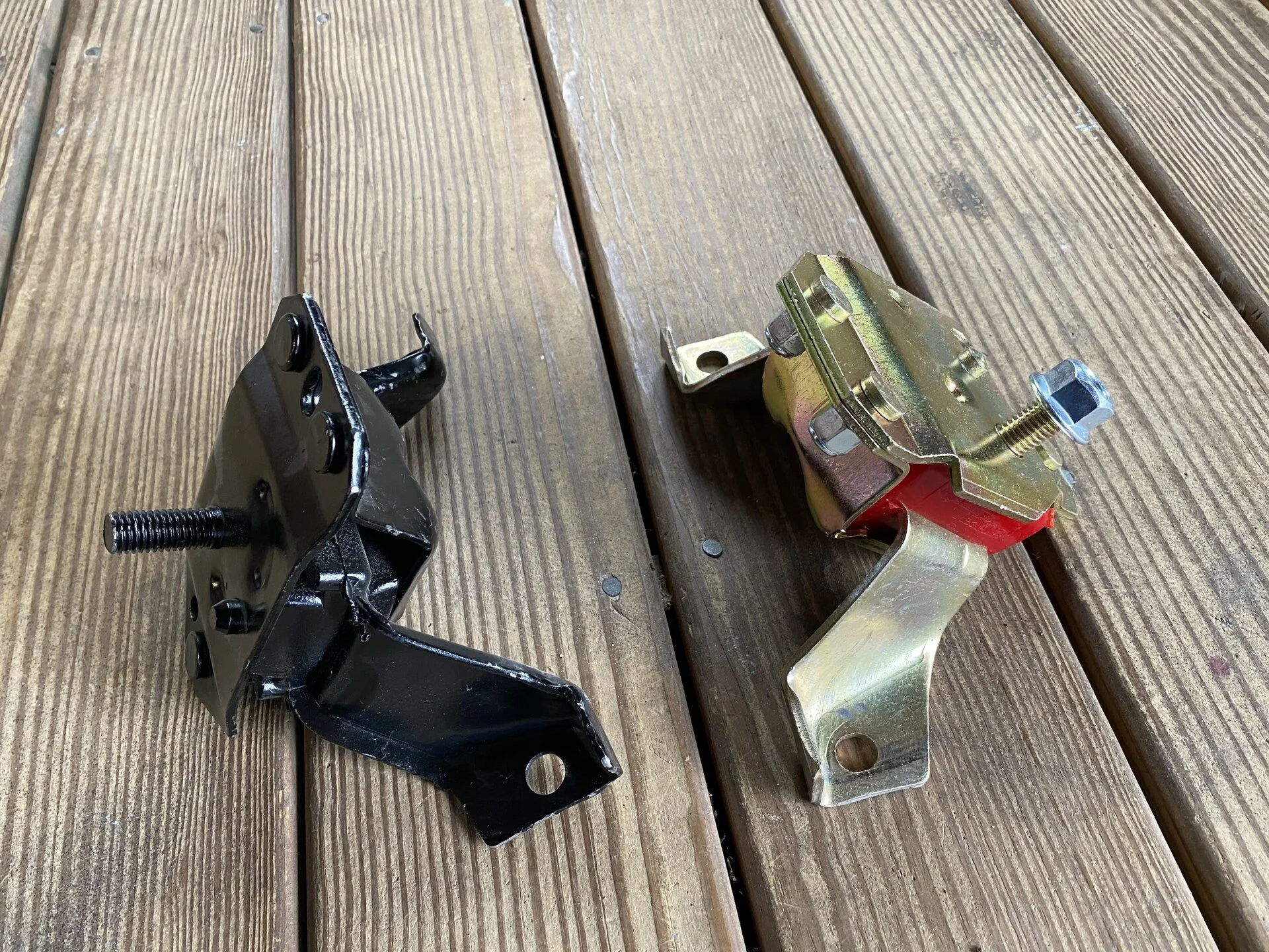

Both sets came in. The ES pieves are nice and heavy and well made. The parts store mounts seem cheap. They don’t even fit well. Both sides will need tweaking just to bolt onto the engine. One even looks like it was used.
if I could get oem Ford rubber mounts, I’d likely run those. But I can’t
fortunately I bought the rubber ones on Amazon so back they go. I’ll be using the poly
