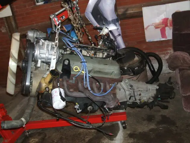

sounds like you answeed your own question dude. its likeyou said, there is nothing to it. Just crack the nut on the a/c and let the thing drain out. here is a pic, when i pulle my stocker combo out
