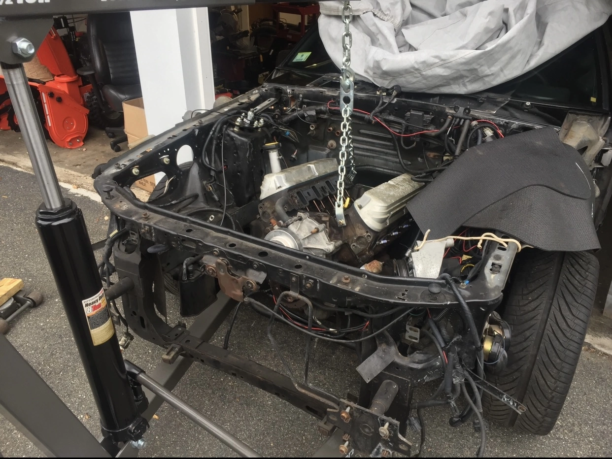

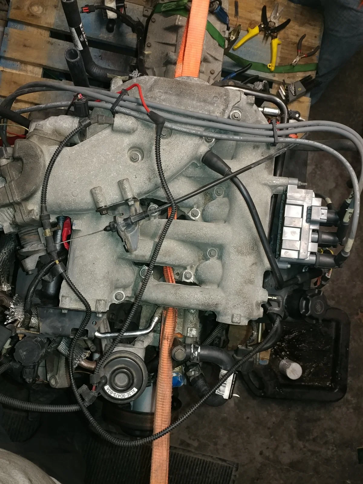

I put the hoist as close to the intake as possible and ran a ratchet strap through the open spots under it and then lifted it that way.
I have always pulled the intake. Then run the chain from accessory bolt hole on the head to same on opposite rear. Chain basically sits flat across the lifter valley. When lifting, hook of hoist is about same height as top of valve cover (basically hooking chain below the intake). Never had an issue. This is how my brother did his big block Buick.

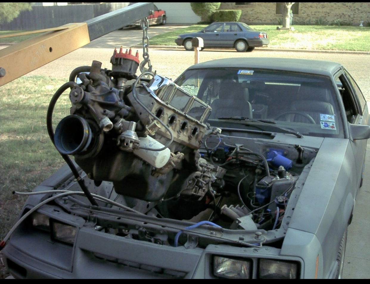

I've done it both ways... accessory bolts and using the lift plate, iirc I drilled a couple of extra holes
in the lift plate to insert a few more bolts.
I think the only time anyone ever uses the factory lift loops is the first time because they never go back on ... lol
I think the only time anyone ever uses the factory lift loops is the first time because they never go back on ... lolgrabbed
I've actually stored my loop and put it back on sometimes during engine pulls.

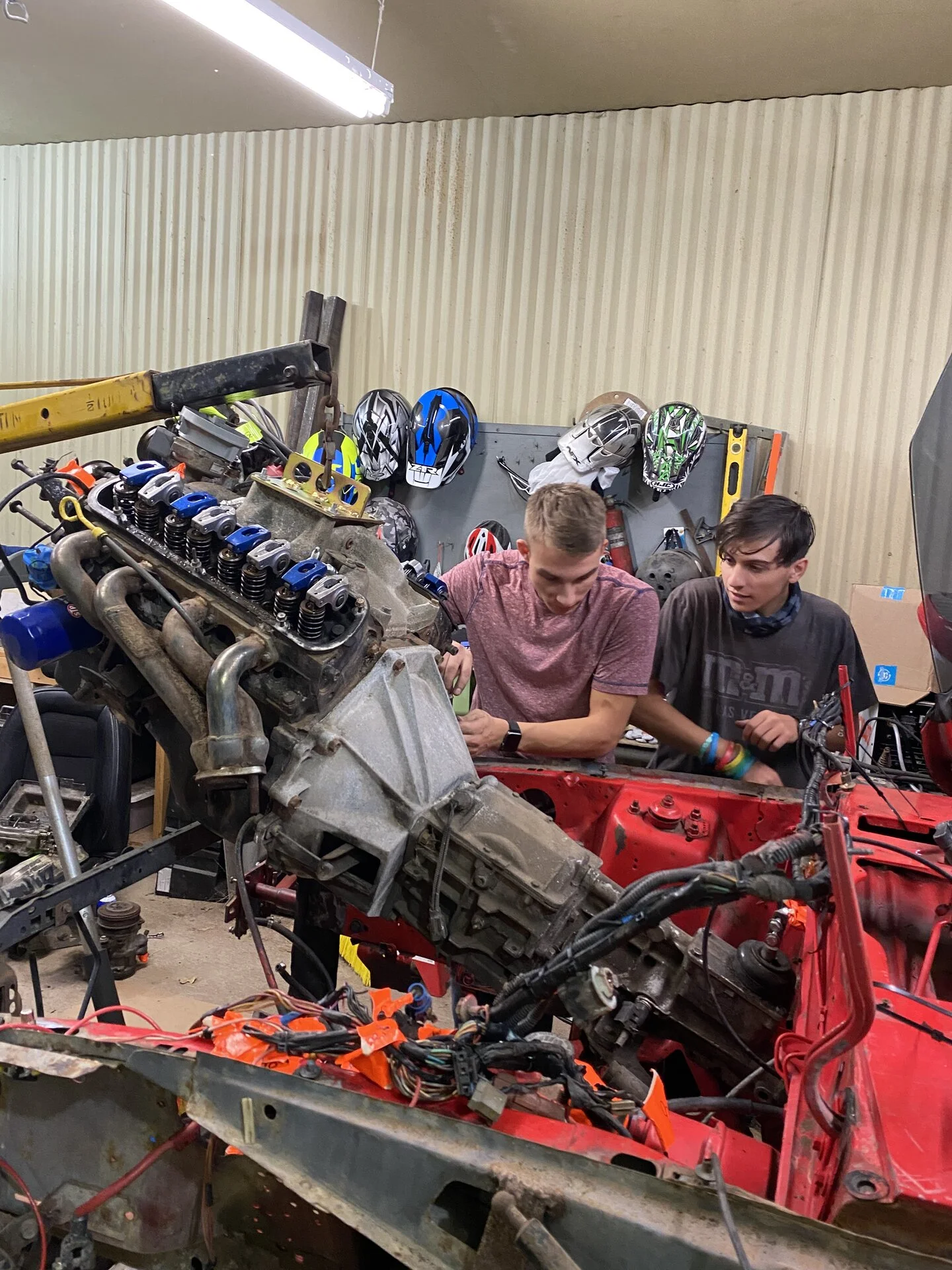

Thanks for all the feedback and pics. I'm pulling from a 4X4 and need to get the engine as high as possible. When I originally installed it, it took three of us as the engine would not clear the front of the engine compartment on its own. We had to lift by hoist and by hand. It was a real killer. I'm hoping to avoid the same thing this time around.
