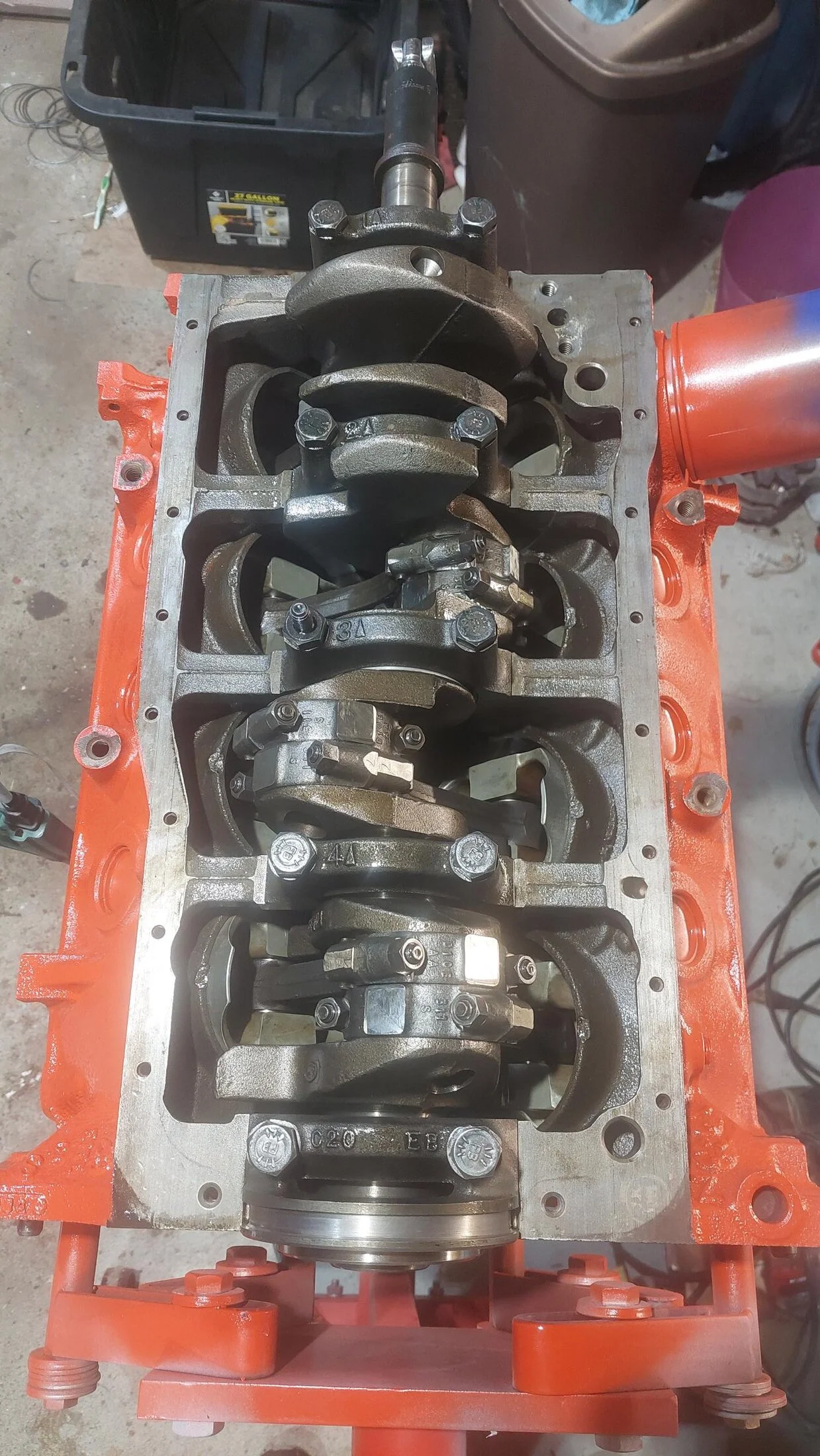

Alright, the pistons are in. That was a bigger PITA then I expected. The ring compression tool from HF wasn't as easy as the tool looked in the videos. Also, I'd say 6 out of 8 pistons had the rod bearing move out of position as I was tapping the piston head to get it on the crank. 1 or 2 pistons I had to pull out and reset the bearing, the rest I kind of pushed the bearing in place with a screwdriver making sure not to scratch anything. Other than that, everything still spins freely, so on to the next step which I'm thinking is the timing gear.

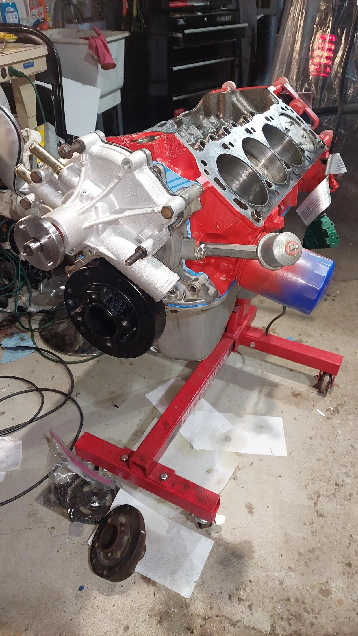

Who knew of the whole engine build, the water pump assembly and mounting would be the hardest

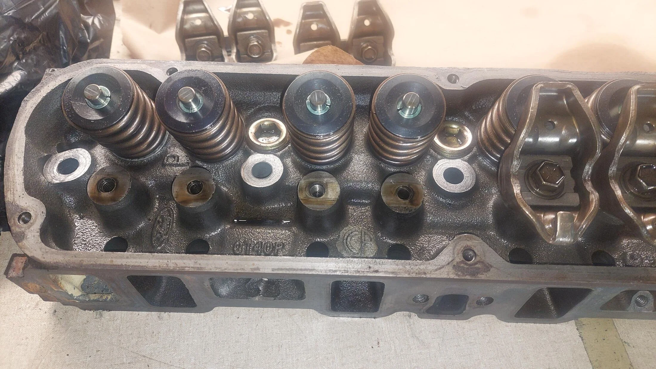

Finally found myself some time to work on the engine. Moved on to cleaning up the heads I bought (GT40P). They already came with the stiffer valve springs. My plan was to pull off the springs/valve and clean first. However, I can't get the keepers out. I've tried compressing different springs, with the same result. The spring compresses, I can move the valve up and down but the top plate and the keepers that go inside of it don't move on the valve stem. I use the cheap overhead valve compressor (it does fine compressing the spring). I even tried pulling the keepers out with a small screwdriver and pic, nothing. I've thought about using a socket over the spring once it's compressed to get things loose, but I'm afraid to bend the valve head or stem.
Anyone have any advice? Thank you!

A magnet should pull them out with the spring compressed. I use a little pocket screw driver with a magnet on the back.

yea, my problem is I bought that simple jaw compressor It compresses the spring against the top retainer where the keepers are and the keepers don't move within their place. Magnet doesn't pull them out. Even tried a small screwdriver. I just bought the c-style compressor tool that I'm going to try. That one compresses the spring towards the valve head-- hopefully freeing up the keepers. Will post my results when I have them.

That compressor will work, I've used it on a set of GT40s to swap to a set of Trick Flow springs. The handle isn't very friendly once you start compressing the springs though - you'll want some good gloves. I used my insulated leather welding gloves. Get the spring compressed, push the valve up from the chamber side while holding the compressor and spring down to the casting, then remove the keepers with a magnet like @90sickfox suggested. Easy-peasy!

sounds like when you did it, the retainer compressed down as the spring compressed. For me, the retainer doesn't move-- thus doesn't release/expose the keepers that remain seated- like it's stuck on the valve end tip. The head already has the TFS stronger springs. I just want to take it apart so I can clean and paint it. Maybe I need to shoot some PB Blaster in to the keepers to help them come loose. If you have any other ideas, I'll take them-- otherwise, hoping the different style of spring compressor will get the retainer to move down on the valve stem which will release the keepers.
