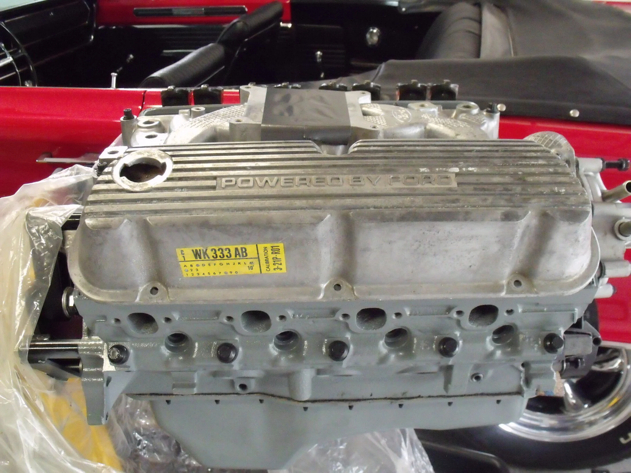

That was the color on the can of engine paint I used... Ford Grey
I was told this is the correct color to use.??
From what I have read it appears that from 79-early 82 the engines were blue from pan to valve covers, from mid 82 to mid late 92 they were gray from pan to valve covers, and from 93 and up the pan and valve covers were black and the block was bare.
