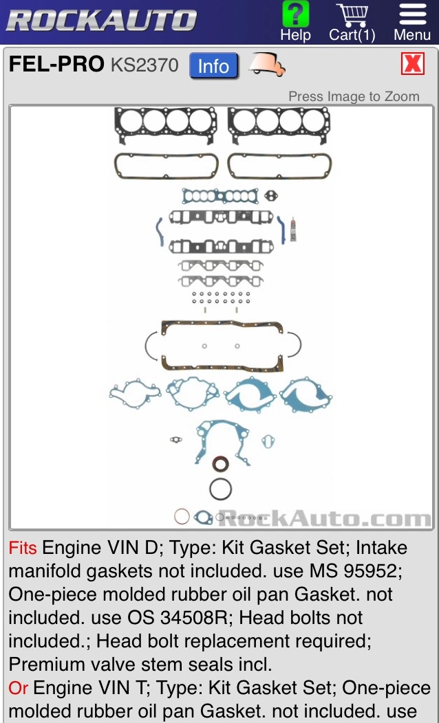

•Fel Pro gasket set.
(Recommendations?)

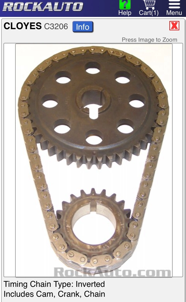

•Cloyes timing chain.

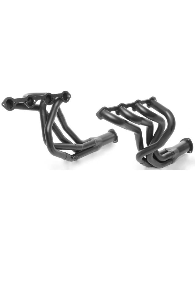

I also plan to put on a set of long tube headers.
(Owned,not these pictured,but very similar.)

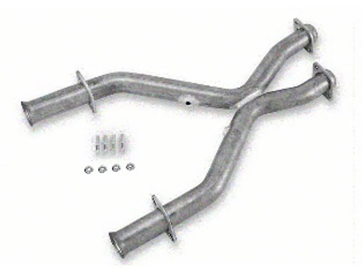

Looking at an X pipe .
(Recommendations?)

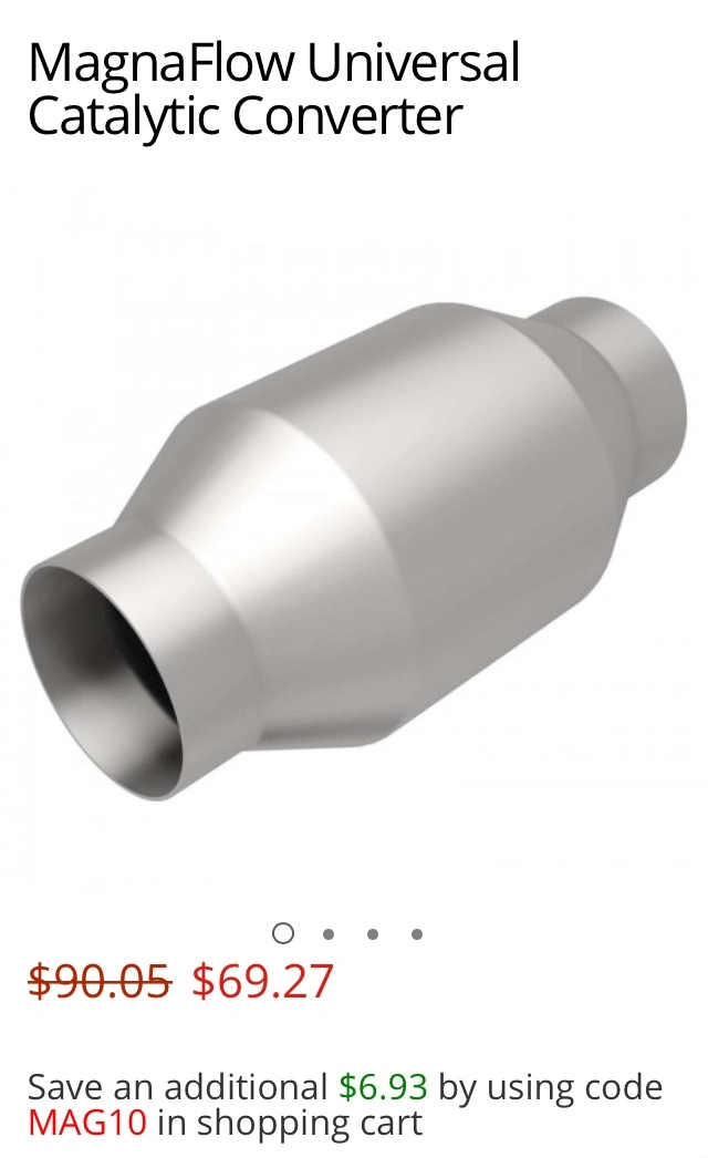

And I would like to add in a set of High flow converters.

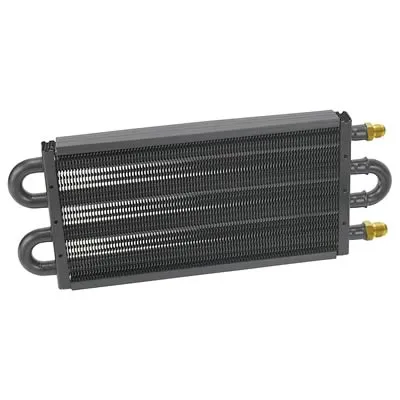

And when I get the freshly rebuilt aode back,id like to add an external cooler.

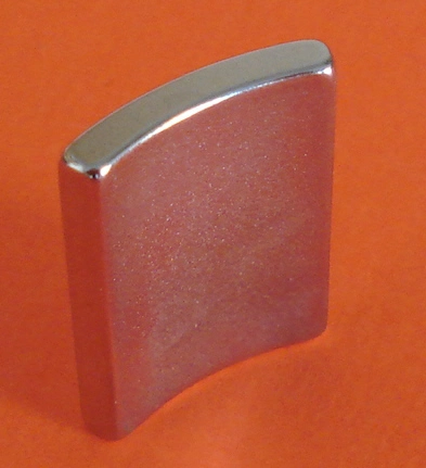

I remember reading somewhere on here about adding high heat resistant magnets in the oil pan to help keep debri in check-maybe @jrichker said it ?? I’d like to add a couple if I can find ‘em.

9333pt1 for head gaskets .
1pc oil pan gasket
Ptfe style rear main seal
I like Harland sharp rockers . Scorpions I know guys use too and work but may be on the noisy side .
Frpp lifters work I have had them over 7k rpm
Also I'd get the rubber style valve cover gaskets over the cork ones in that kit

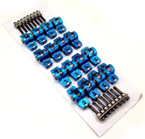

would you recommend these rockers? https://www.summitracing.com/parts/csp-s4003/overview/make/ford
and this valve spring kit? https://www.alexsparts.com/sb-ford-gt40p-drop-in-valve-springs-kit-hyd-roller-580-lift/
Thanks jeff
Reactions: RaggedGT

For me rockers have always required that the stock pedestals be milled away, and then you use studs, guide plates, and hardened pushrods.
But that would be the forward thinking Raggedy, planning one day to change over to an aluminum head. The rationale being that Having all this stuff now makes the future conversion so much easier on the budget.
But,....
If all you ever envision is a certain power limit using those GT 40 heads, and you stick with it, then save the money, buy the pedestal rockers, and build to that end.
Whatever you do,...do not use the stock timing chain you have pictured. It'll be a worn out timing chain well before you decide to change out the cam.
And I'm the one with the magnets in the pan,..and Jrichker is the guy that'll tell you where to get them.
Probably better to just get pedastal mount rockers on stock heads. They are easier to install, and less hassle.
Kurt
Thanks man,I’ve found a few different pedestal mount 1.6 sets,including the Harand Sharps Jeff recommends. Pretty sure that’s the route I’m going to go.
Like Revhead said you'll want a pedestal mount instead of a stud mount rocker it will be much easier .
I think those springs should do the trick
Thanks again

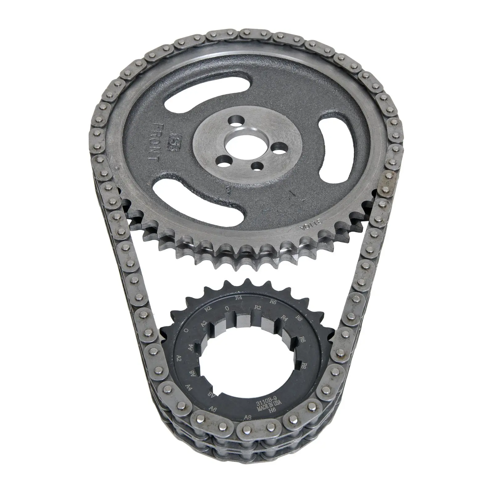

Any of a number of double true roller chain sets..
Reactions: RaggedGT
Double roller. That one you pictured isn't a double roller. Cloyes makes a really good one

id avoid the gasket "kits" and just piece together what you need, the kits dont always (ever really) come with the best available quality for every surface. fel-pro 9333 for heads, 93334 or 1250s3 for the lower intake, os34508r pan, vs13264t valve covers, either fel-pro timing gasket.

timing chain, ive used billet ones from tfs (was in the top end kit) and one from cloyes, the cloyes fit better and tighter, very burr-tastic though. you want double roller (even in a stock setup), timing advance/retard is......meh, up to you, and how much effort you want to put into double checking and measuring.

I found a cloyes double roller set I’m goung to order,and I gave up on the gasket set. Will piece one together.
