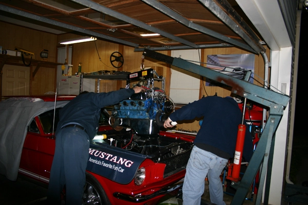

Heres some pics that show the engine coming out.
