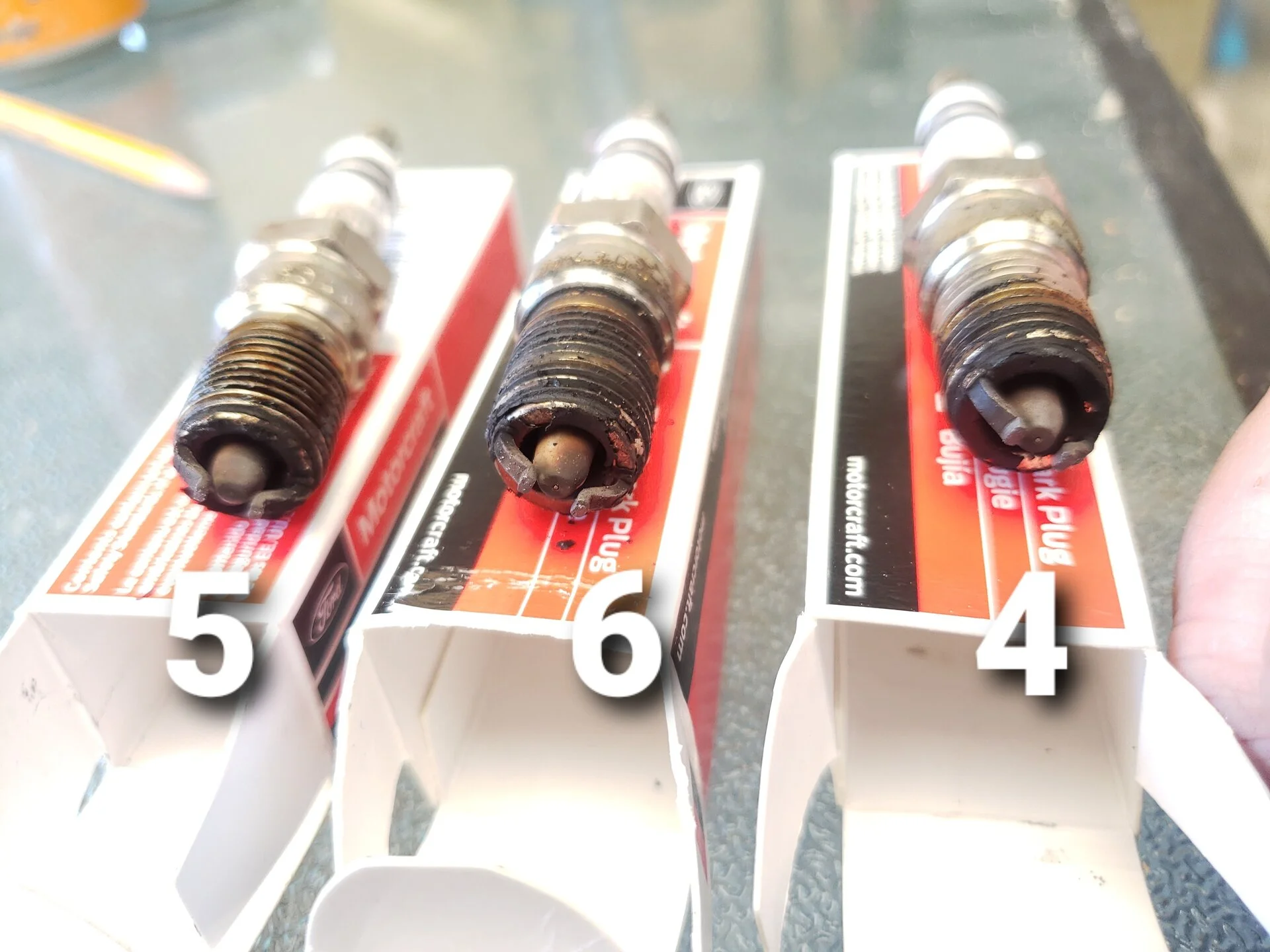

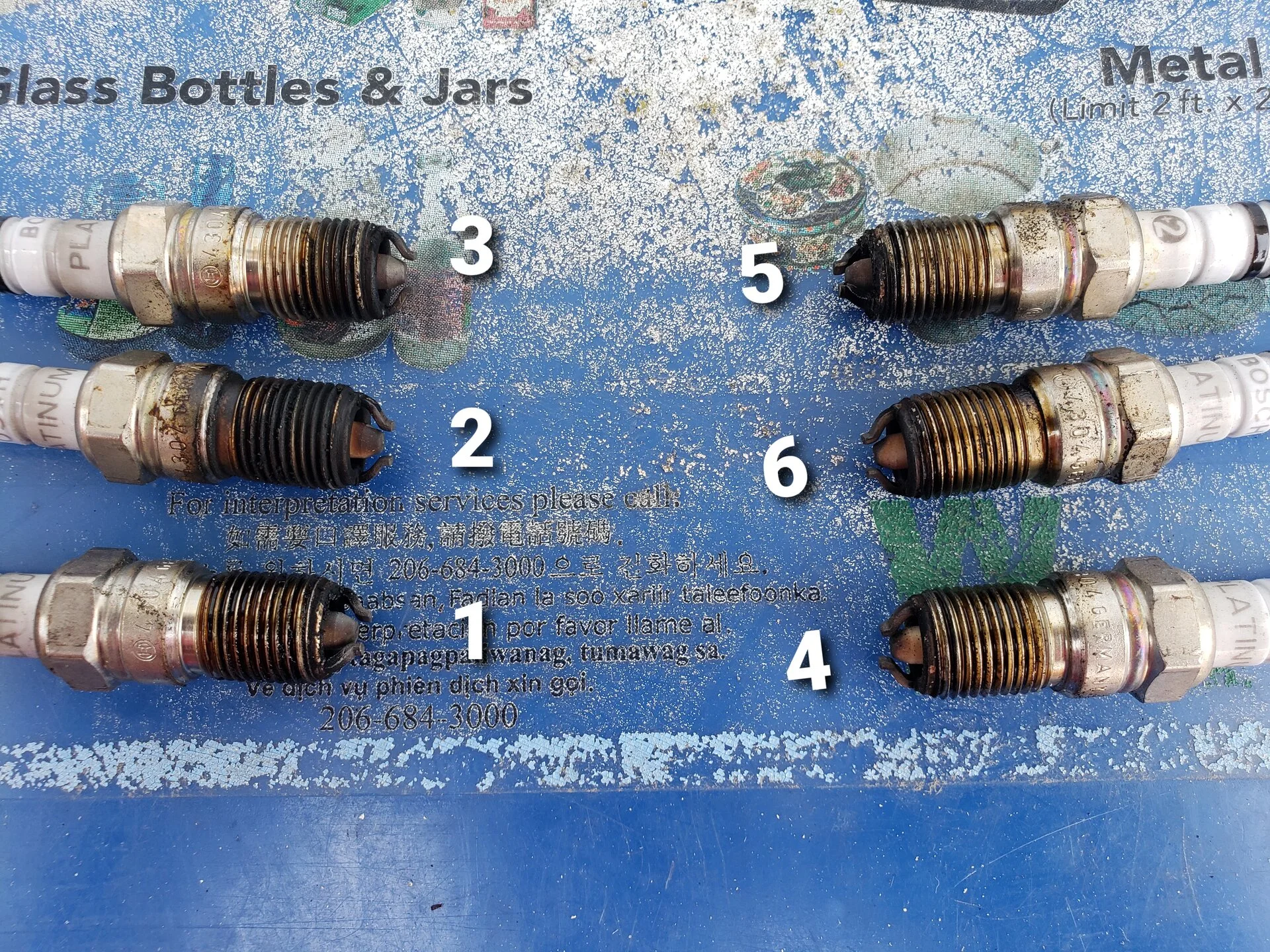

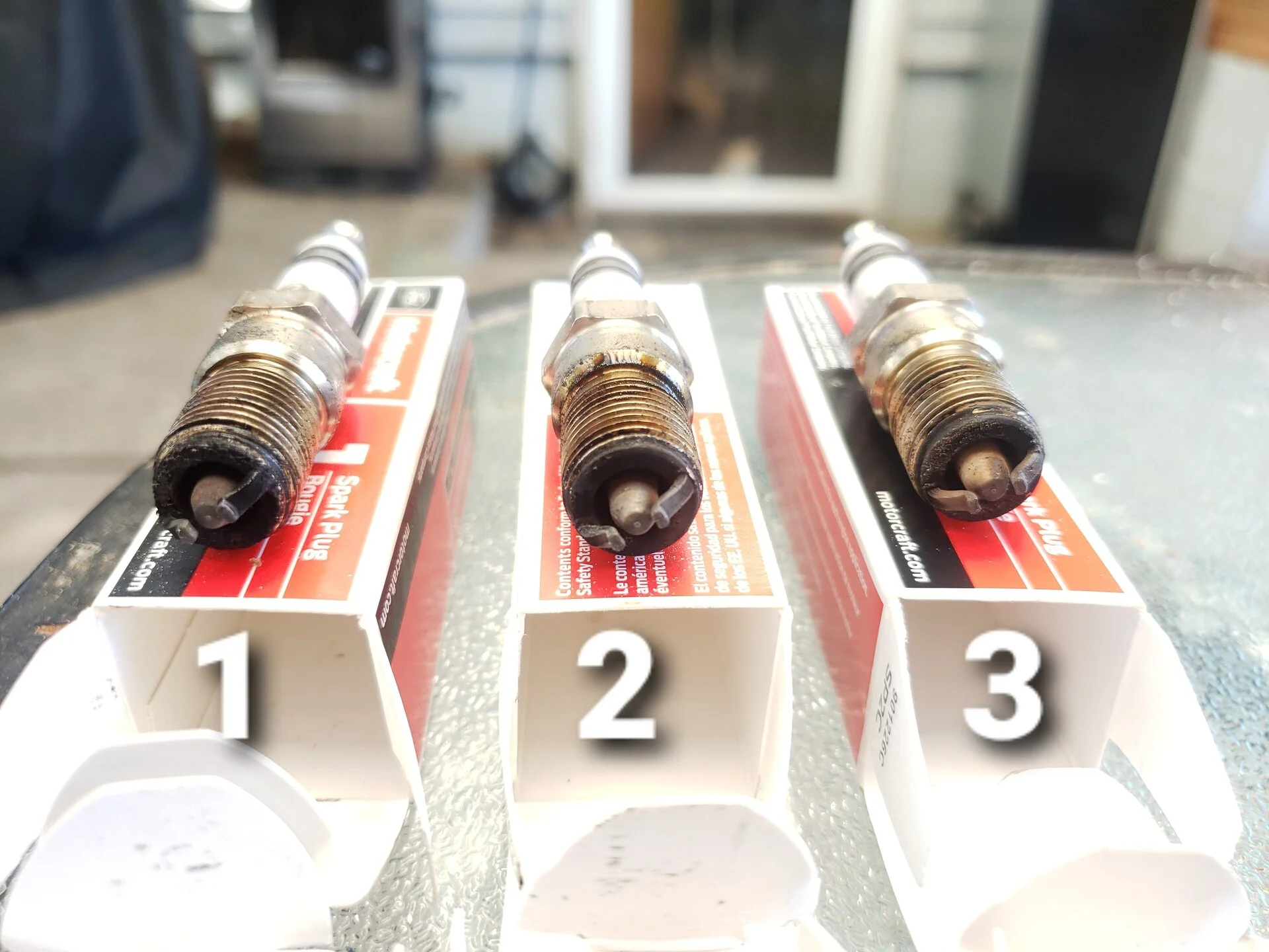

Can someone help with these old plugs... I'm guessing carbon fouling on some but I'm unsure. Definitely have some wet threads on some but the tips are dry. Fair amount of soot that you can see began to flake off. From what I've gathered the wet threads is likely valve cover leak? Also a couple of them have a dark spot on the porcelain, is this the misfiring?

To me I see evidence of "carbon tracking" on 2, 3, and 5. I can't see the others. However the fact the problem did not go away with new plugs and wires likely says that the carbon tracking wasn't the primary cause.
