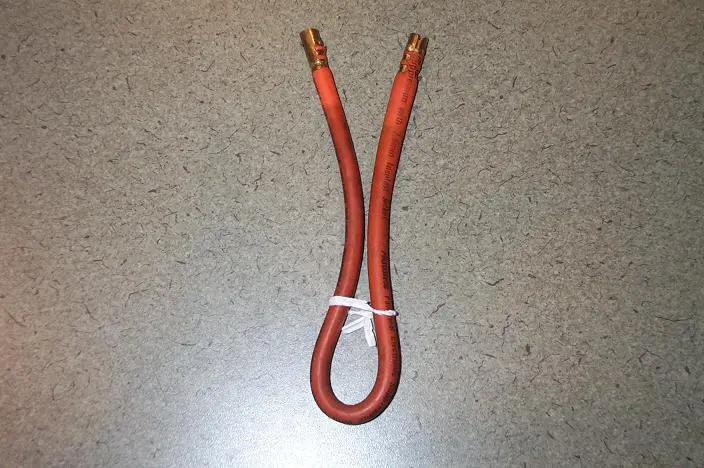

I will definately check that out. In the mean time, I was looking at the coil and pulled the wire off that runs from it to the distributor cap and the end that plugs into the coil was fatter and more mushy than the rest of the wire. I'm thinking that the coil is getting too hot or it didn't have a good connection. I put the wire back on so the fat part was towards the dist. and the good end to the coil and was able to get me home after the car stalled again...

Well, as you can see from the picture, the wire from the coil to the distributor cap must have overheated or something (and there was some oily matter inside the coil where the wire plugs in) I think that since the wire got fatter and there was some kind of lube in there the wire probably worked its way out of the connection...
I had some extra spark plug wire leftover from a different car so I made a new wire that runs from the coil to the dist cap. I also took the fuel filter off and looked through it. It looked like there was some sort of screen or membrane inside. I blew into it and there was a bit of resistance, but overall I think the air flowed pretty unrestricted.

Test the wire you took off with an ohm meter & let us know what number you get.

Well the wire started at 10.8k ohms when I first put the connectors on it and very slowly dropped to 9.52k ohms - what should it be at?

Your coil wire looks about 2' long. I would say that the resistance numbers you have are high. At about 2' you should be about 1/2 of what you were reading.

The wire measured 13.5" - not sure how that would affect the numbers. I also checked the new one I made and it came in at 4.31k ohms. Any idea on what affect the higher ohms would have on the overall performance?

The shorter the wire the lower your resistance should be. Set your ohm meter to the thousand setting. As you see your new wire is about 1/2 of the old. 4300 sounds OK for your new wire. Less resistance will give you a better spark. Check the rest of your wires since you still have a miss or rough idle. I would say anything over 8K on a long wire may be suspect.
