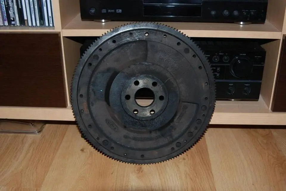

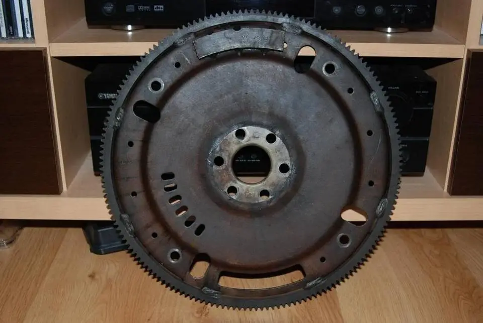

here is photo of flexplate take off from my gt:
and flywheel form this other car:
is this flywheel good ?
like I have read alot about swap and it should work good but someting is wrong, car is not driving now, I take off t5 agiang and tommorow I want to translate pilot bearing.

Yes I thing, flexplate is for auto, so i took flywheel from t5 car and put to mine, this flywheel fits only in one position. so i bolt it up.

ok I'll check crossmember but have a question, do need to balance this flywheel to my engine ? or it should work good already ? and is it possible that my flexplate is 28 oz. ? flexplate don't have any info on it and I don't know is it 28 or 50 oz. ? I`ve read that ever late 302cui have 50oz but now I`m confused and don sure about it :/
No balancing needed.you need to install the pilot bearing.if the flywheel came out of a 94 5.0 than it should be the correct one.

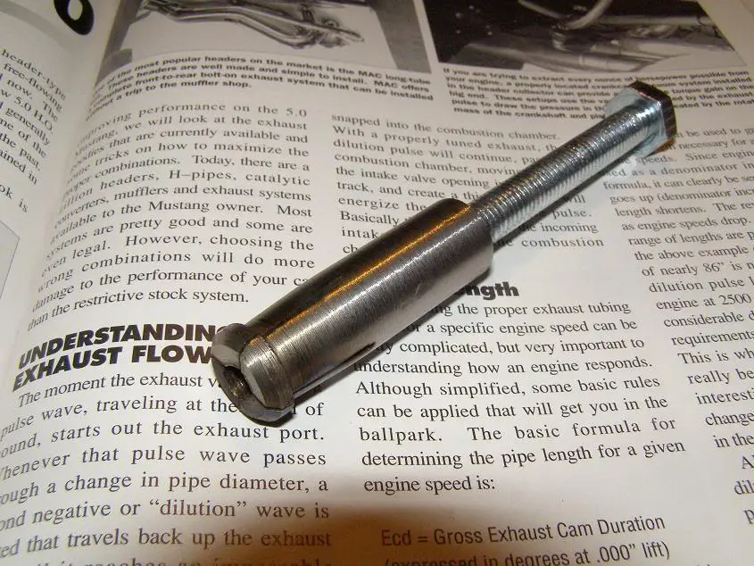

I finished my tool today, will it work ?
working procedure is very simply, this thing should by putted into bearing and when bolt start to drive into bash splited tip of it should start to enlarge and grab bearing then bolt will touch crankshaft and slowly push bearing backwords. :)
this is only theory I'll see in practise.

For the pilot bushing, the grease trick works well too... pack grease into the bearing and drive a punch that barely fits into the bearing into the grease. after a couple of tries the grease will force the bushing out...

Does your flywheel have a part number on it (if you have your trans out and can check)?
I'd check the balancers on both engines. Both should be 50 oz imbalance. If both balancers are 50 oz, then both the old flexplate and the flywheel should also be 50.
