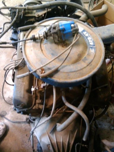

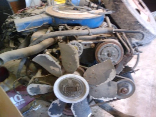

so, it currently has an 8in and I found a 9in is $300 a good price for one or should I try to talk the guy down. Im not sure what they are worth as I use to always work on chevy and never tried to build anything with the power I hope to get out of this. I seen these motor mounts RockAuto Parts Catalog not sure if that would bolt up to where the 289 mounts are or if ill need to fab something. Have realized that the shock towers will more than likely need to be cut somewhere. not too much of an issue as I can cut and weld decent enough, I went out to look at the motor the guy is selling and took a few pics.
If by $300 for a correct-width 9" axle housing drum to drum, yeah, that's a pretty good price.

If that 9 isn't a direct bolt in, $300 is about $200 too much. Cutting the shock towers isn't manditory, but if you want to keep your sanity, I would definately do this before doing anything else. I've "been there-done that" with a big block Stang and when I bought my current 77 Comet, that was the first thing I did to it. It's soooooo much nicer to have room for plug changes and header bolt clearance.
