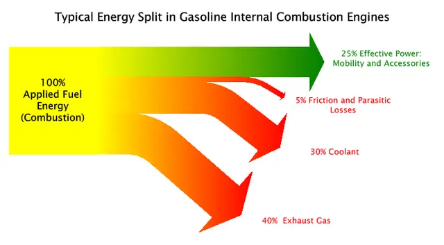

Here is an interesting tid-bit of info.

The turbo recaptures a relatively small percentage of the energy that's wasted as heat out the exhaust.
