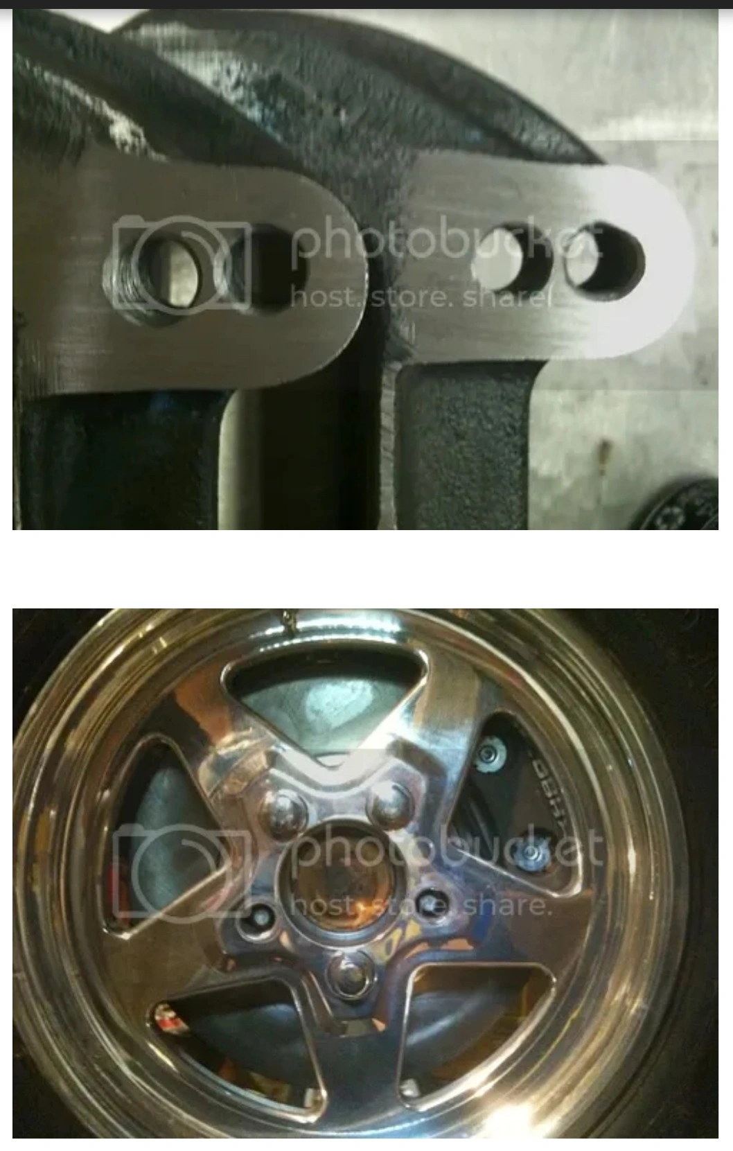

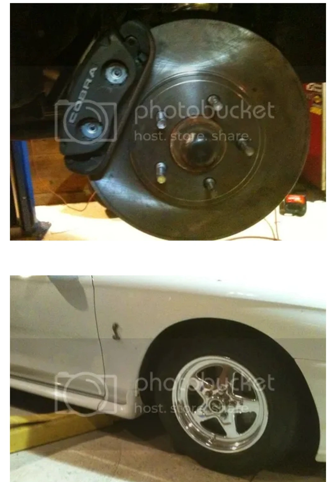

If you want to use cobra front disc brakes on that 15 you'll need sn95 spindles, 90s crown vic slap on rotors, and redrill and tap the caliper bracket 1/2 inch higher to lower the caliper for the smaller 12 inch rotor.
I thought one needed 17" wheels at a minimum to run the Cobra front brakes.
The road course autox folks worked around the big wheel issue.
These pics are from another forum ( corral ). Only pics I could find.
