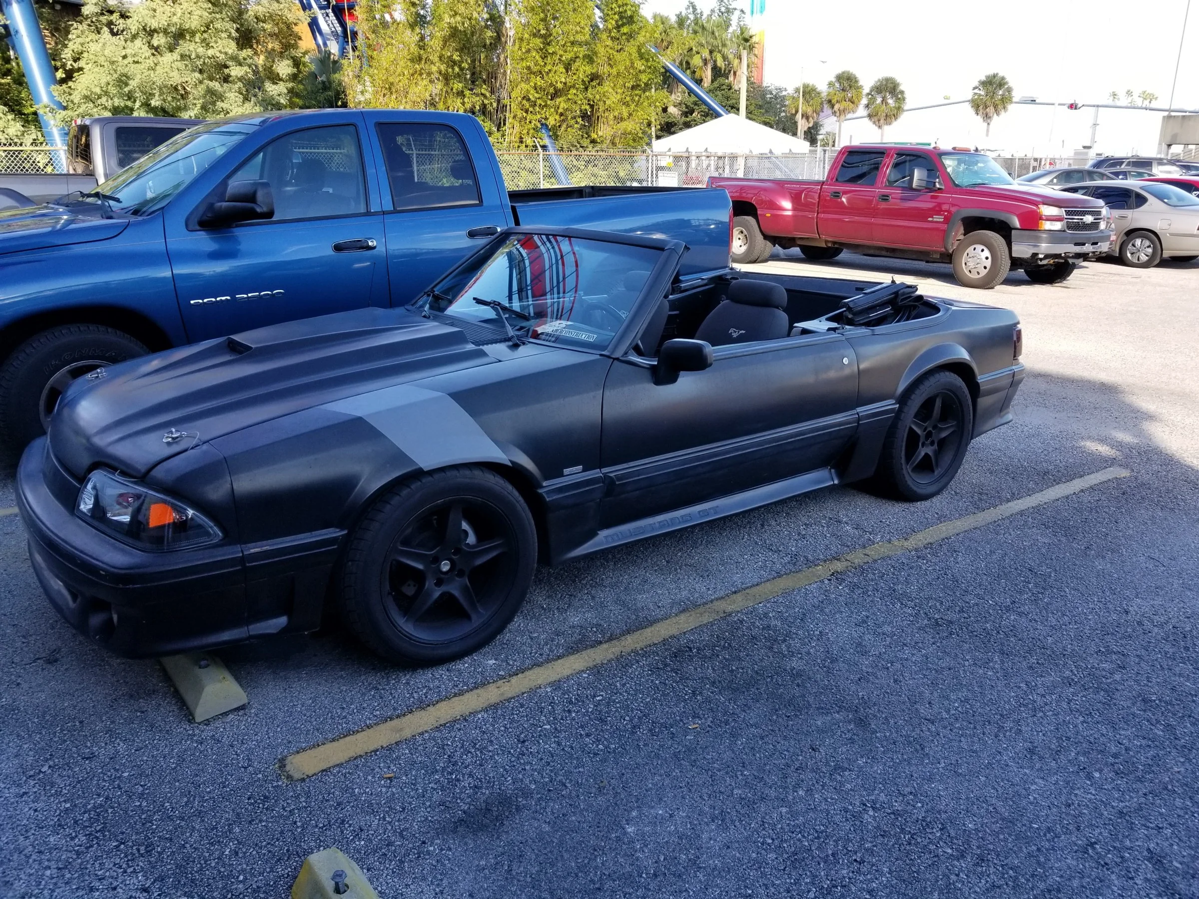

that's right gents almost January and in Florida I can still put the top down on the way to work.
