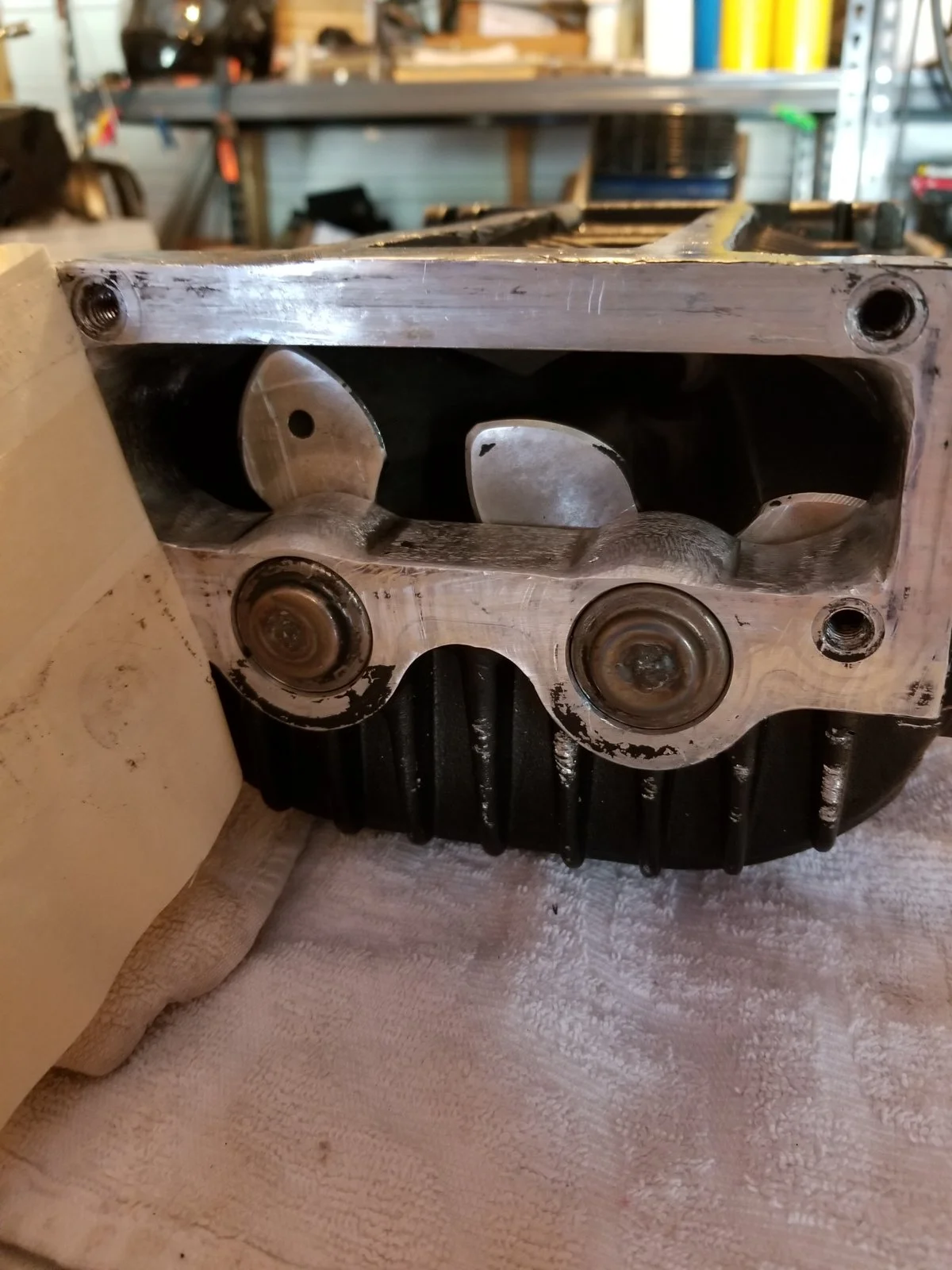

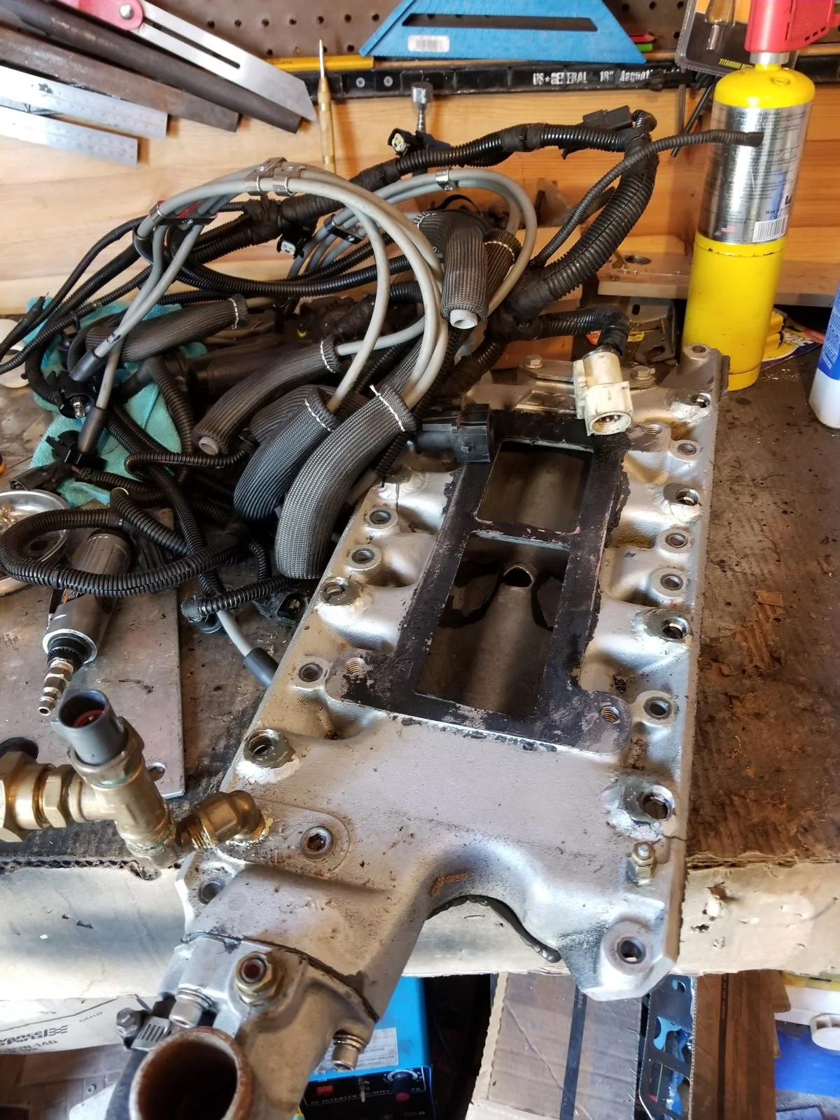

Ok ok, I dont have any pictures of the actual rebuild but I do have a picture of the inlet and some tear down photos.ported inlet I cleaned and polished the inside of the case and rotors.
