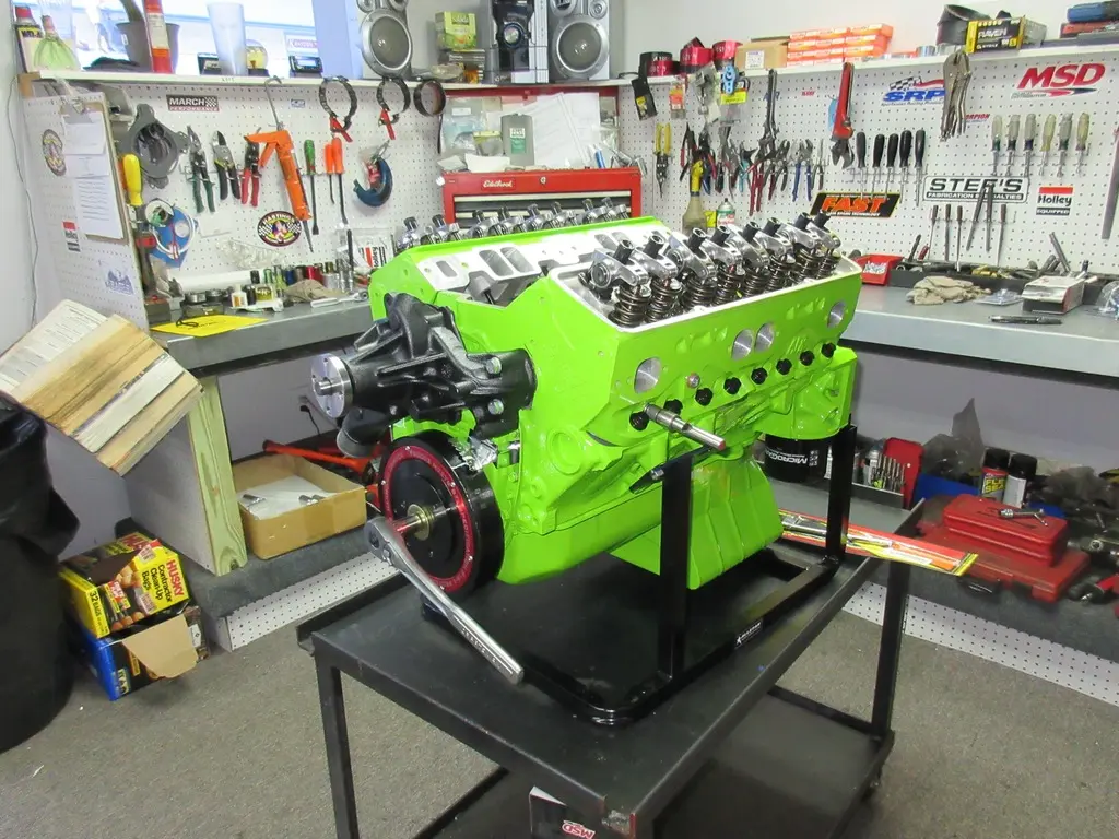

Davedacarpainter said:
Green

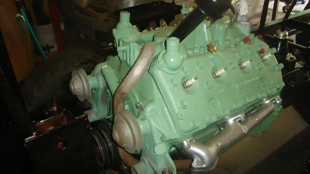

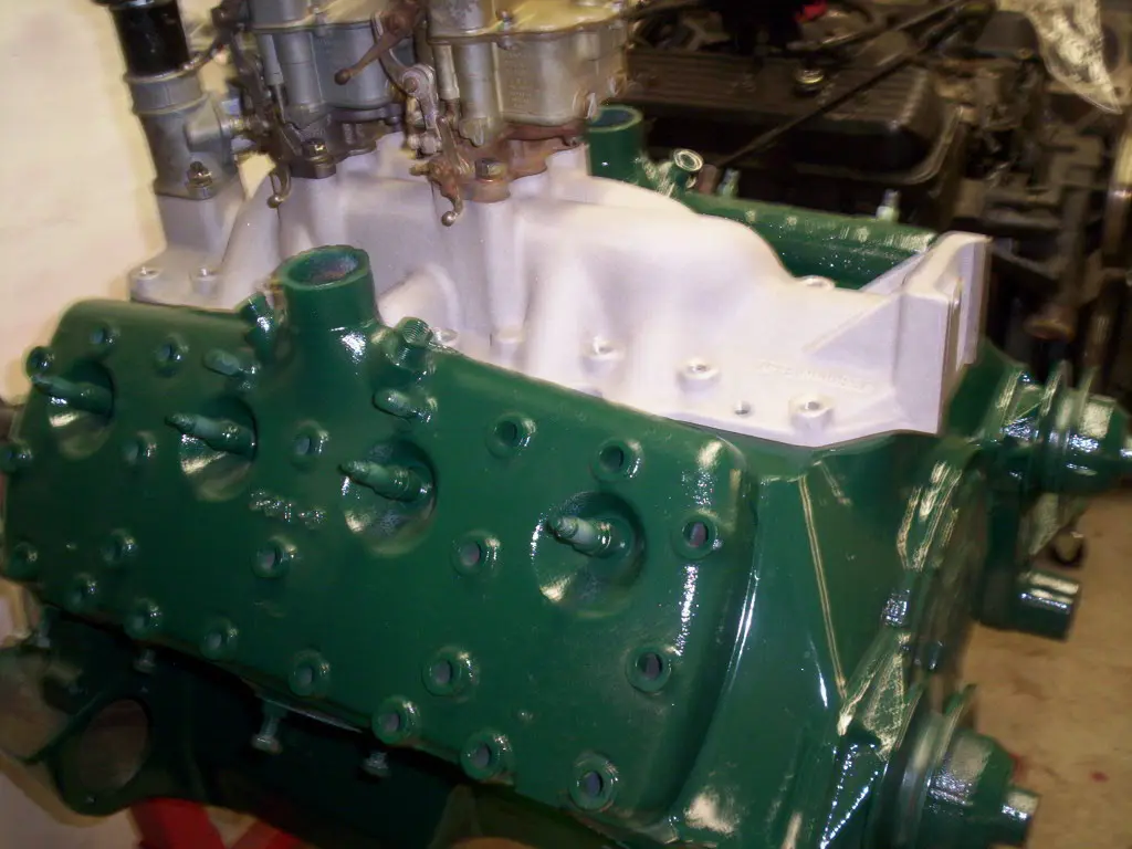

I like it! Are we talking this:
This:
Or:
Bonus teal!

Steve, take the top color.

Lol that is a really bright color.....

Paint it dark gray...or silver... whatever you do please don't paint it red or orange.

I usually go with various shades of black or silver. This time I want to be a bit different just not sure what colors go well on franky...

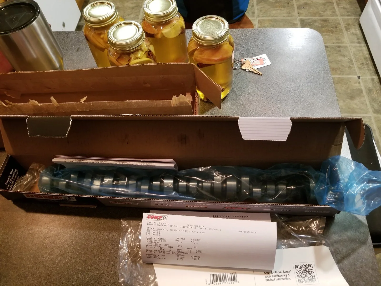

Tomorrow I pick up my engine.
My cam came in today.
glorious billet perfection.

Whats in the jars? Oh, nice bumps on that stick too!

Homemade Apple pie moonshine I dont make it a coworker does. Its damn good
you need to deal with the gear that's on your distributor/cam sensor unless that glorious billet Cam has an iron gear on it.
Billet cams, and iron distributor gears don't play well together.

I checked with comp, I'm good to go

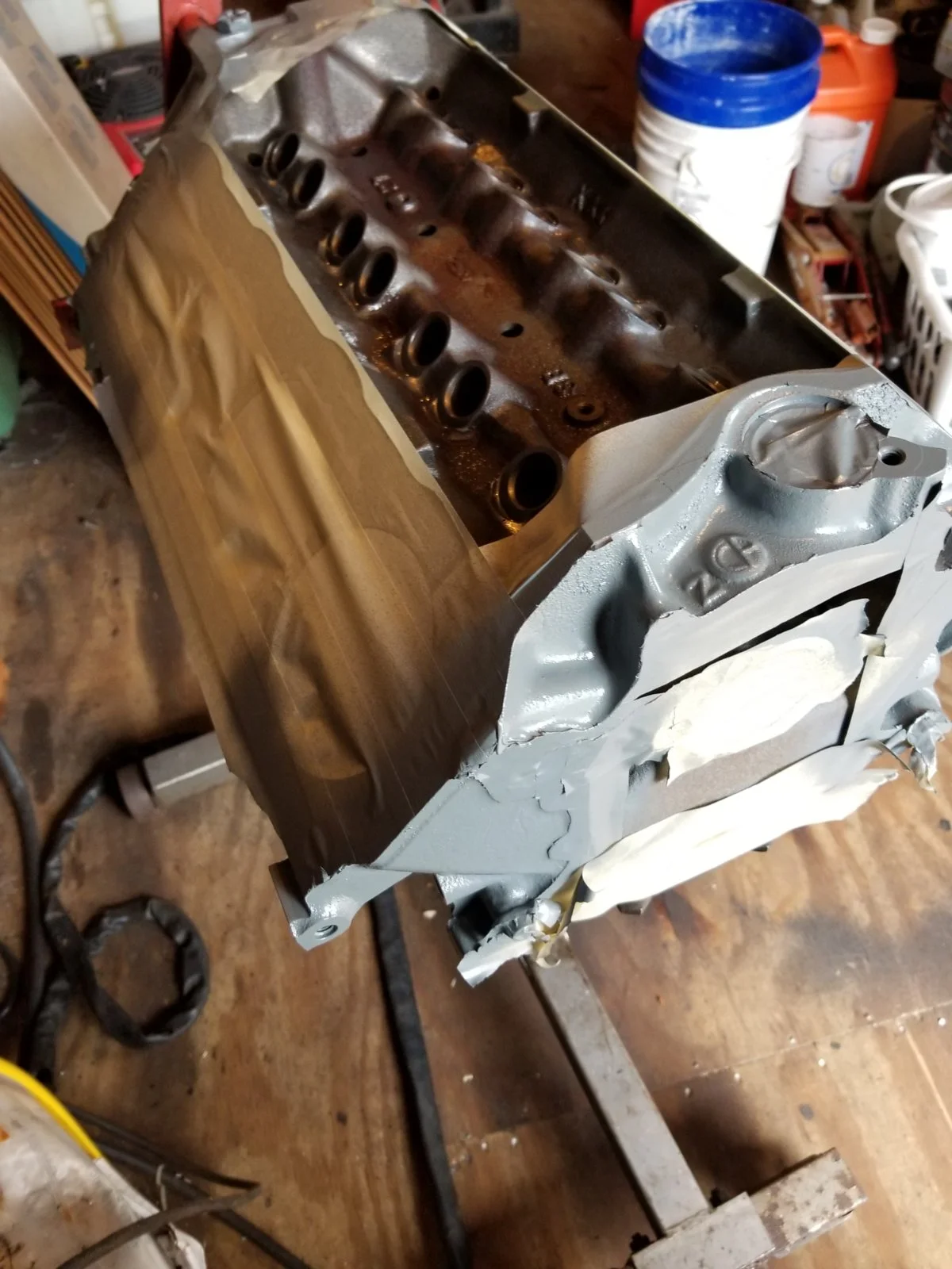

I picked everything up yesterday.
Mothers day so not sure how much I can get away with... did paint the block yesterday.
