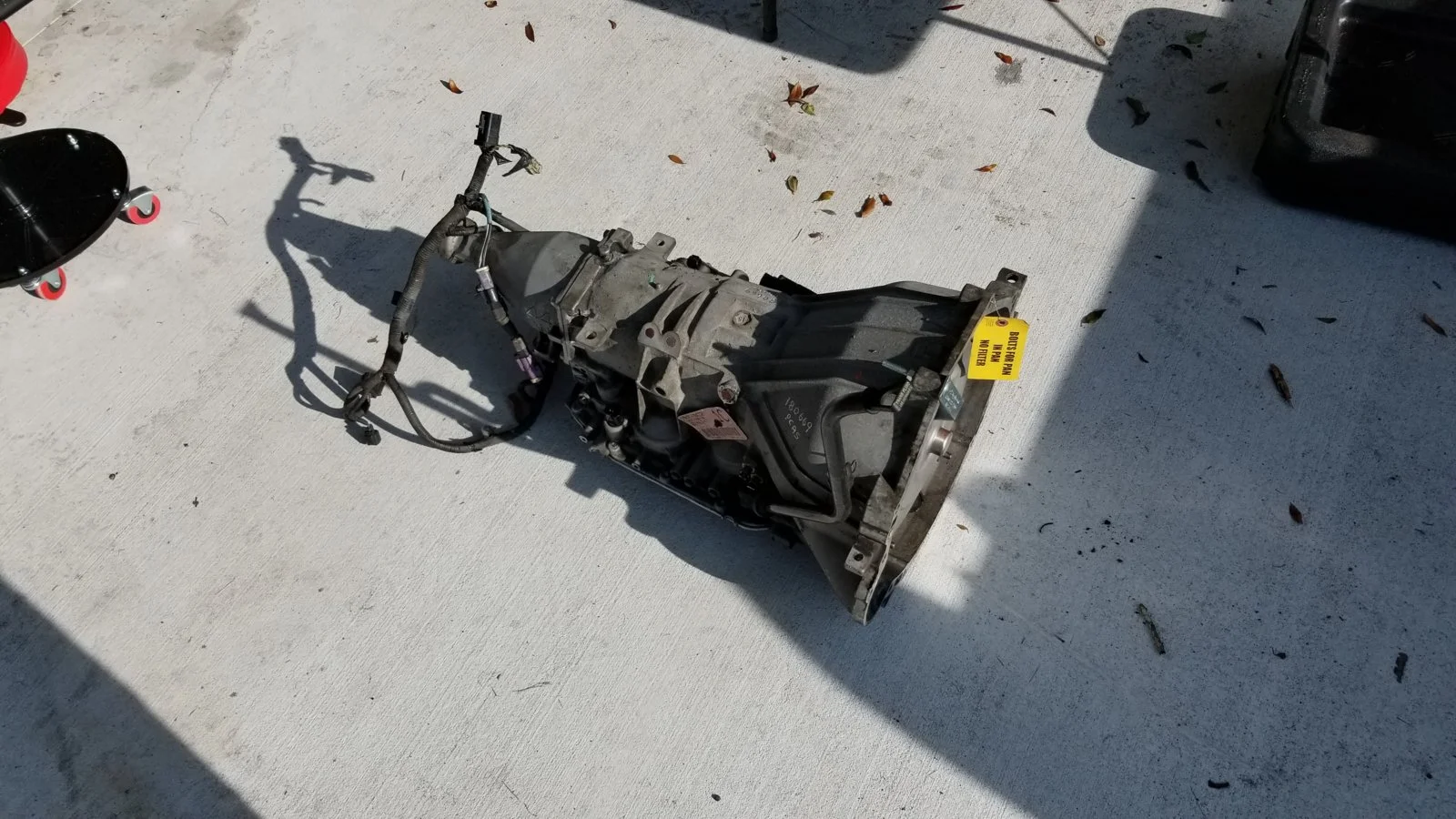

I found a few transmissions, closest one is 25mins away. 300 for trans from a running driving car in the salvage yard. Comes with converter and harness. I will pick it up tomorrow or friday morning. I need to order a flex plate.
Im guessing you've chosen a 4r70w then? Have you read up on what you need to replace to keep it alive behind a twin turbo'd 393?
Yes I did main thing is drums and a high strength input shaft. For now a stock 4r70 out of a 2002 mustang will reside behind the NA393

a91what said:
And the transmission is mine.
Now to find a flexplate that will work and I need to measure the bolt distance on the converter.
Dont be like iowa nick. That bell housing fits sbf, and not 4.6 right? It has to be out of the v6 car
yes trans is from a 3.8l v6 out of a 2002 mustang. I already have a aod tailhousing to to put on the trans as well. now i just need to figure out the converter [or use the 2800 stall stock one] and flexplate.

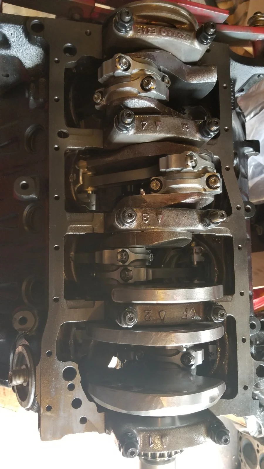

Ok so one of the main bearings looked damaged in the packaging, I am not chancing anything so i ordered a new set of bearings. I only need 1 cap side bearing but i bought a whole set.
So far i have been taking my time, the mains plasti-gauged out to .0015 clearance on every cap and are even all the way across. this block was main honed so i have no doubts it will be perfect.
I just finished installing the rings on the pistons, gaps set at 24 top and 25 second ring. total seal with moly faced top ring.
I will say this- spiral locks suck!! but all the rods were installed yesterday.

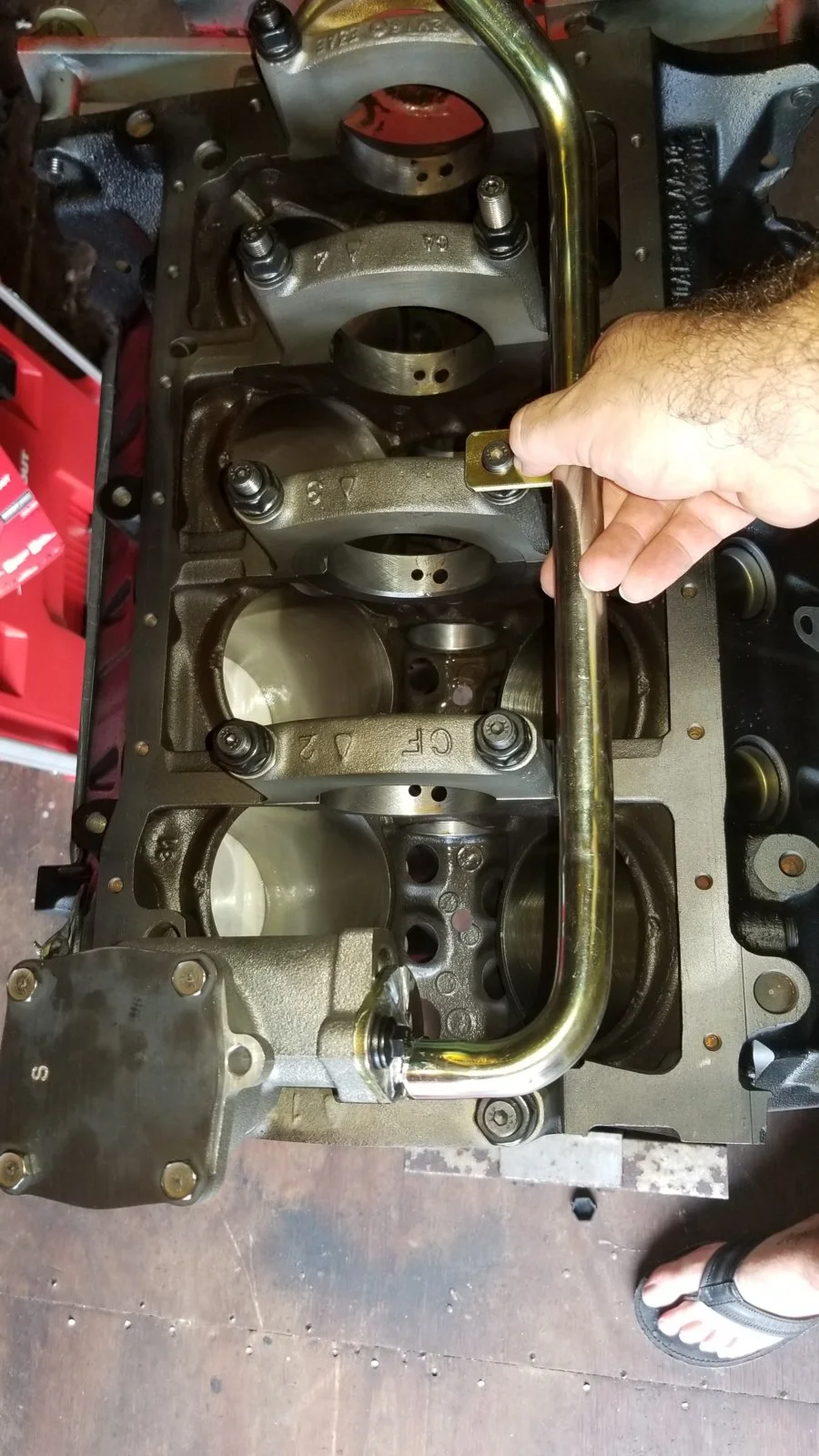

Shortblock assembled.

That thing sure is purdy, Steve !!! Setting the bottom end up is the hardest part. Should have it in and running by the weekend.
