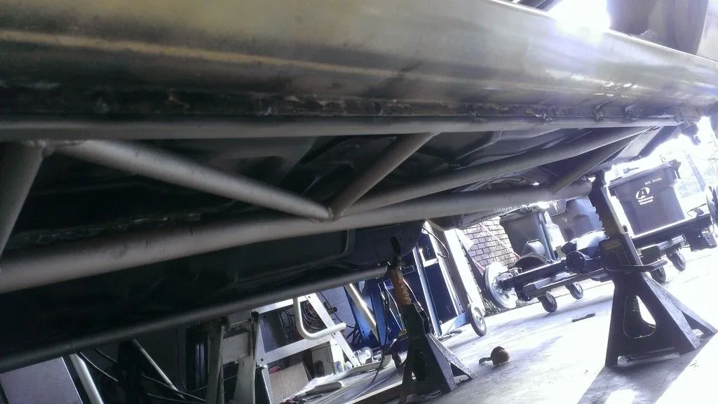

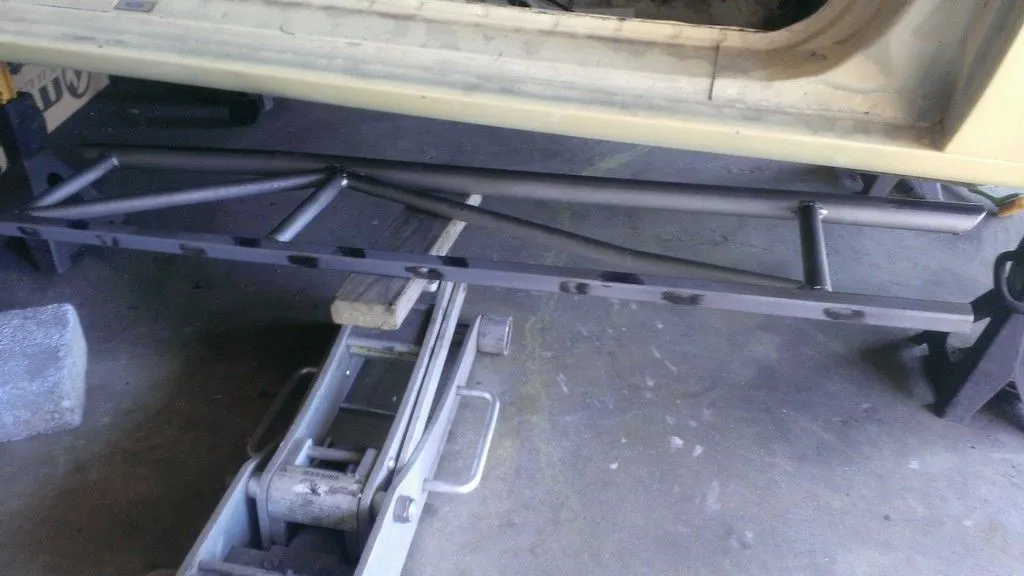

In the spring I welded in a set of Stifflers jacking rails to go along with the sub-frames I already have.
The rails are extremely useful and make putting the car in the air much easier also provide some additional stiffness.
I believe they are part of the fit system.

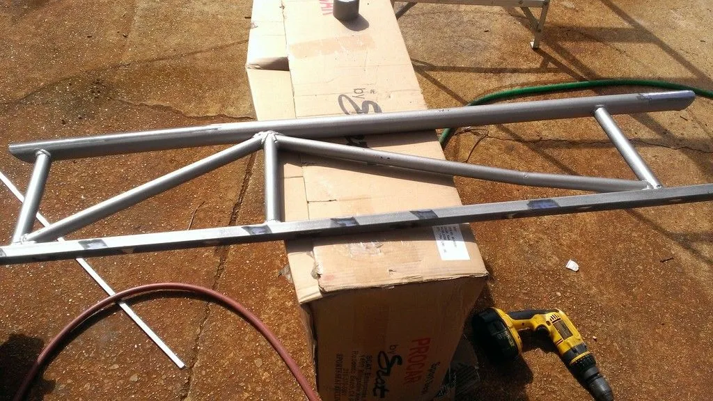

I understand your point the components are just square/round tubing cut to length and powder coated, nothing fancy.
The benefit of buying the complete kit is time and convenience.

I have the instructions for the " how to make your own" set. It's as easy as:
1.
2.
3.
I have a much more detailed version of this from early on in the build. ( page 5 of my build) I will say ( and @Davedacarpainter can testify to it) that the biggest pain of the whole process was trying to weld the " jacking rail" to the pinch weld. You simply could not get that galvanized/seam filled area to stop splattering molten metal all over the place ( and you as well) you can see where I removed the paint on all of the areas where I intended to rosette weld..and, if you'll zoom in on the weld pics above, you can see what a freakin disaster that was.
So,..since this is the third car that I have done this to here is my " been there/dine that" advice....regardless of whether or not you intend to build or buy these things..
Weld the things at the top of the floor from inside the car where the JR will be when butted up against the pinch rail,....and use big assed 1/4" steel rivets all along and through the pinch rail to secure it instead of spot welding. It'll require one hell of a rivet gun to set the steel rivets, but it'll be a lot better than setting your legs on fire. I did the red car this way, and only because I broke my freakin rivet gun did I not do it on the monster.
