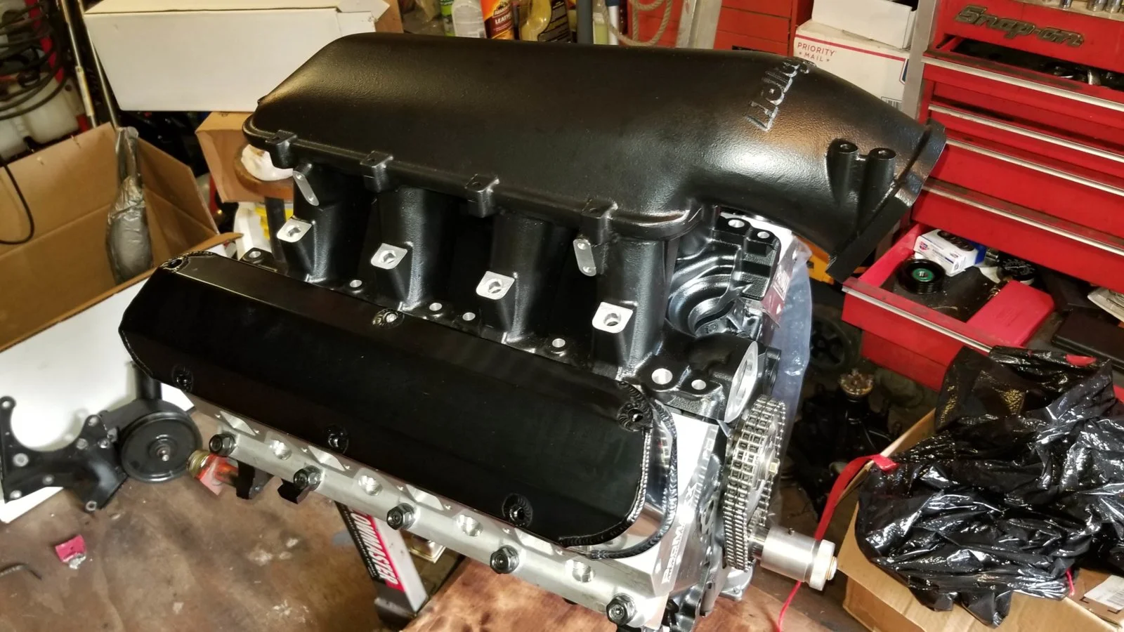

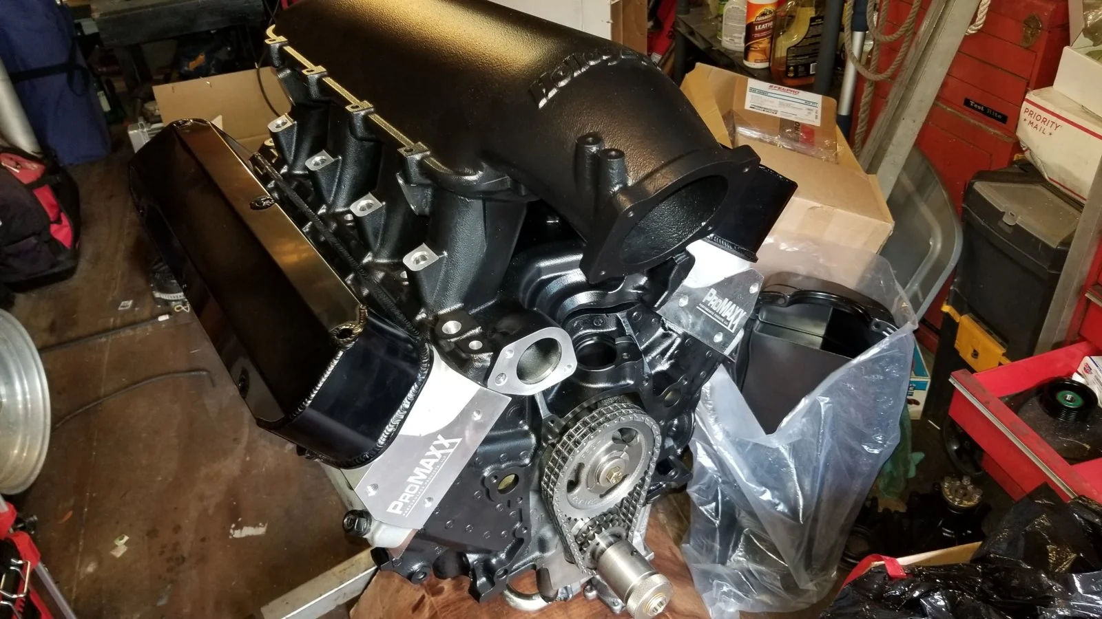

teaser photos
dont mind the mess, I had to pull the generator out to give it a twice over for the hurricane that could have wiped us off the map...
I also found out that the intake manifold was a touch too wide to fit between the rails for the valve covers.... figures... no issue though a few passes on my router with a good carbide bit and a quick blocking with 180grit and the intake fits like a glove. with no gasket in place the runners line up perfectly, lets hope that does not change.
EDIT: so we are clear i did not have to touch the gasket surfaces, the area around the bosses for the injectors had a small protrusion that needed to be machined down at a right angle to the base of the manifold where it meets the block. I then de-burred everything and cleaned it up nicely.

That is nothing less than beautiful!!!!

I just hope it runs half as well as it looks

That motor looks amazing Steve!
