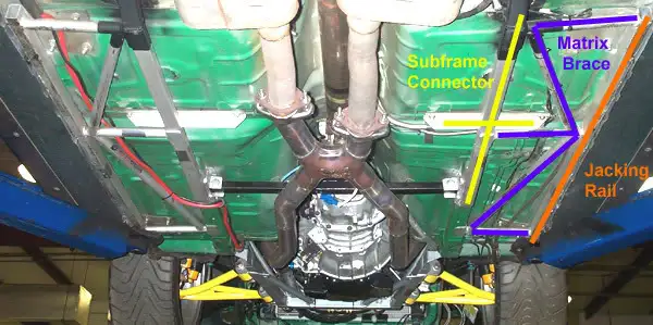

Yeah welding the jacking rails to the pinch weld was a pia, after straightening the pinch welds, but worth it imo.
I am a novice welder so it was a learning experience to say the least, had the car up on cribbing at each wheel to keep suspension loaded.
Welding through the floor and riveting along the pinch is a creative idea, too late for me.
I figured how hard could it be to weld two pieces of square tubing, still have a scar on my ankle from wearing shorts that day,
not my best decision...lol

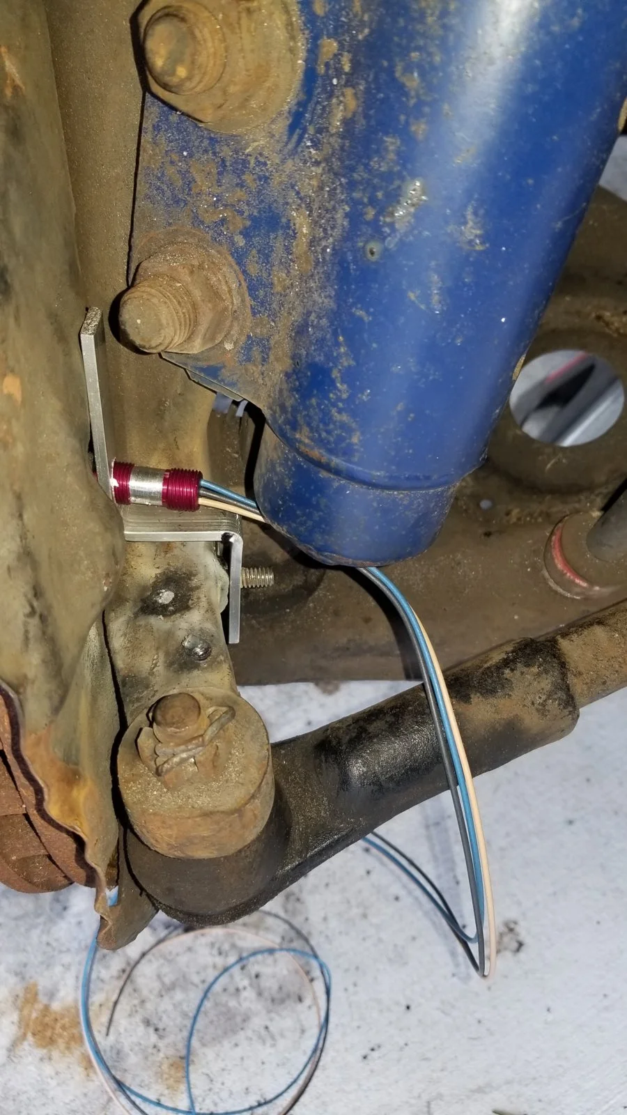

Ok so my original bracket was a complete failure, I underestimated how difficult it would be to weld to the arm... after some time I just gave in and bent some aluminum bar stock into a z shape and used a hole in the arm that for whatever reason decided to weld easily.... figures right.
Here is the bracket I am going to use for testing, I dont like how it rests against the dust shield but meh it works.
It's just a mockup picture I have to get some metric lock nuts since I damaged one.
