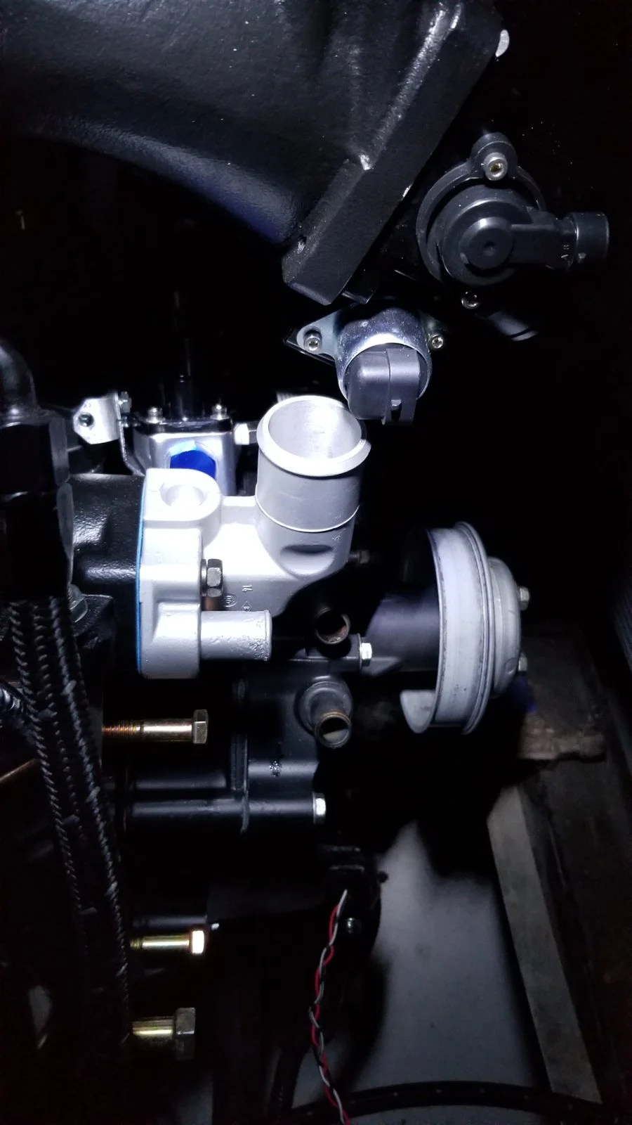

So i had the TB flipped over for clearance and ran into an issue... the thermostat housing no longer fits, it is in a fight with the idle valve.. I am at an impasse.. do i buy a different thermostat housing.... maybe one of those 160* ones will work.

Different housing. They’re price ridiculously but it’ll be less of a headache

I found one from an early ford for $13 so its on the way for me to try.
