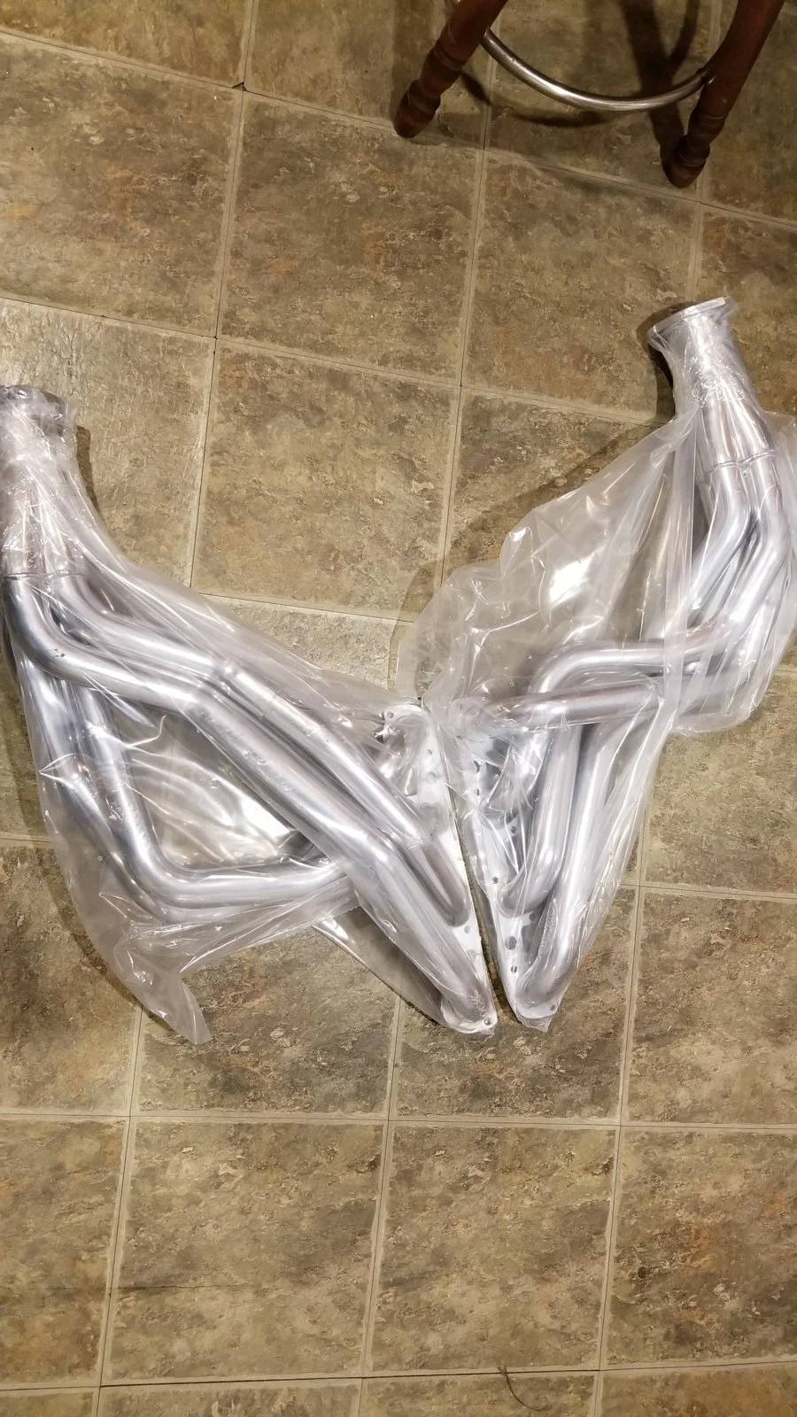

Doug's headers D6672
New in a box originally shipped in 2015.
Stole them on ebay for 400 to my door.

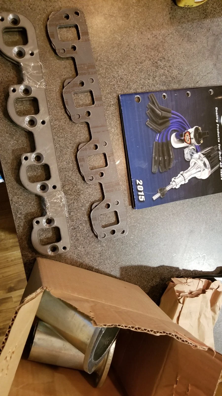

Yay longtubes! Er ah these damn things.
I got the adapters mounted to the heads, only major concern I have is that I already had to clearance something... go figure.
The adapter plate barely touched the head studs, so I had to trim them.. after laying the adapters against the header flange i will have to cut the bottom bolt flange on the headers as well. No huge deal really just need a touch more clearance than i have right now. I do have to cut the individual tubes loose on the headers and slide the assembly into place, it does not look to be that bad but only time will tell once I start the installation.
Oh I also got the motor mounts spaced accordingly, I now have plenty of space below the oil pan. Tomorrow I plan on getting the engine and headers completed. So I can move on to wiring the car.

Man would that be nice, I actually thought of laying them in beforehand but with all the other issues I have had it was nice to not have them in the way, I plan on pulling the engine all the way to the driver side to fit the passenger into place then i will deal with the driver side.
The adapter plate does what you think it does, it takes the standard ford bolt pattern and makes it diagonal. The only reason why i had to clearance anything is because i am using these ginormous head studs and the flange barely touches the top of the nut.
The fitment will be tight thats for sure. I may have to clearance one header tube but i am waiting to see if that is really needed or not.

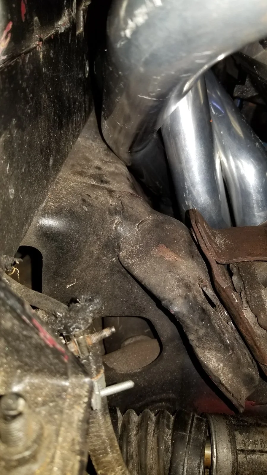

Yup motor is sitting on the headers... this means I get to remove them and swap the motor mounts to taller ones.

I hate to say this....but....I think a tubular k member is in order my friend. I've got AJE and its been working well for many years. ( well the old one until I went curb surfin' ). Mine came with the spring perches and I use the factory lower control arms. The header clearance issue would be a thing of the past....and you might actually be able to change the starter, if need be, without removing that header again. The engine mounts for the AJE are like this...
The engine has adjustment left and right that helps with getting a little space by the header tubes.
