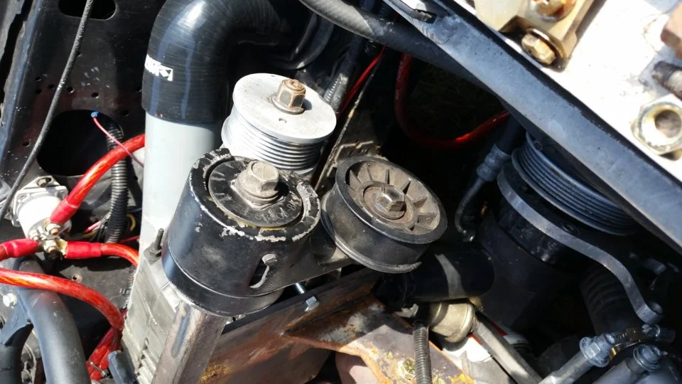

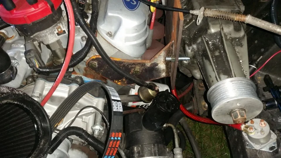

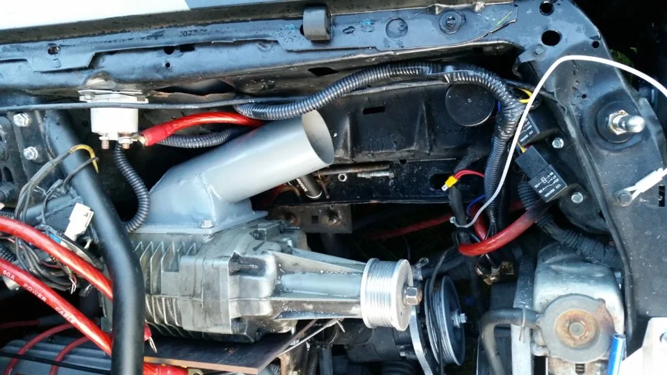

Yes indeed....pics are always a good thing. Especially some up close ones of the mounting brackets and blower configuration.
