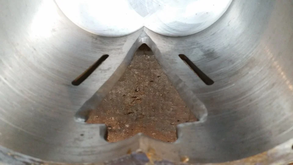

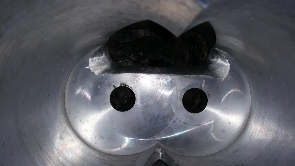

the outlet turned out nicely. I'm not overly thrilled with the inlet side I got some burr skip.....
the inlet is getting very thin near the back wall so I stopped as the sand paper rolls were taking out more material than expected during smoothing. The mouth is much larger now on the inside and there are no more sharp edges.
With better/longer burrs and better equipment I'm sure I could take the inlet farther... as it stands it should allow much better flow, I'm not too worried as this unit was very cheap. :D

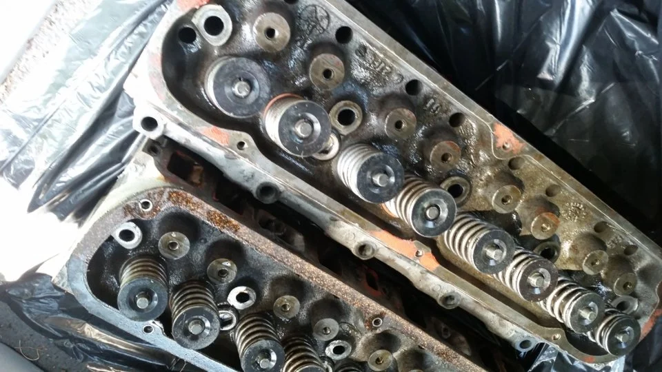

look closely at the #5 intake valve the retainer has walked up the valve. #2 and 5 are the worst these are going to the machine shop to be fixed. After doing some research I just don't get the warm and fuzzy about the procomps he is giving me. We have used some on my father's race car with good results but they are reworked castings with new goodies.
Soooo off to Thompsons they go. Hopefully it's something silly like wrong retainers.
Hmm got a call today from Thompsons. "Well you have quite a mess here"
I never noticed but the 1.6 exhaust valves I paid for aren't in the heads....
They used Chevy 2.02 valves for the intake side and the stock one on the exhaust...
And they installed the wrong springs, too much pressure. spec for flat tappet not hyd roller.
Man I can't catch a break. :nonono:

We are going to 1.6 exhaust valves, so they match the intakes .1 long. New springs and retainers, and I'm having them drilled for studs.
I am tired of doing things twice so this time we do it right. I should have them by monday.
