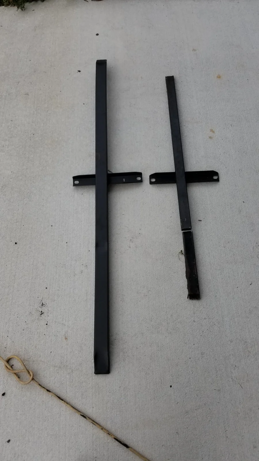

I got the stifflers kit in yesterday, I plan to install it this weekend. I pulled the subframe connectors out just to see how much of a difference between these and the ones on the car.
It is a freaking huge difference, I mean the full length are easily twice the size of what's on the car now. These plus the fit kit will be a major increase in rigidity for Enola.

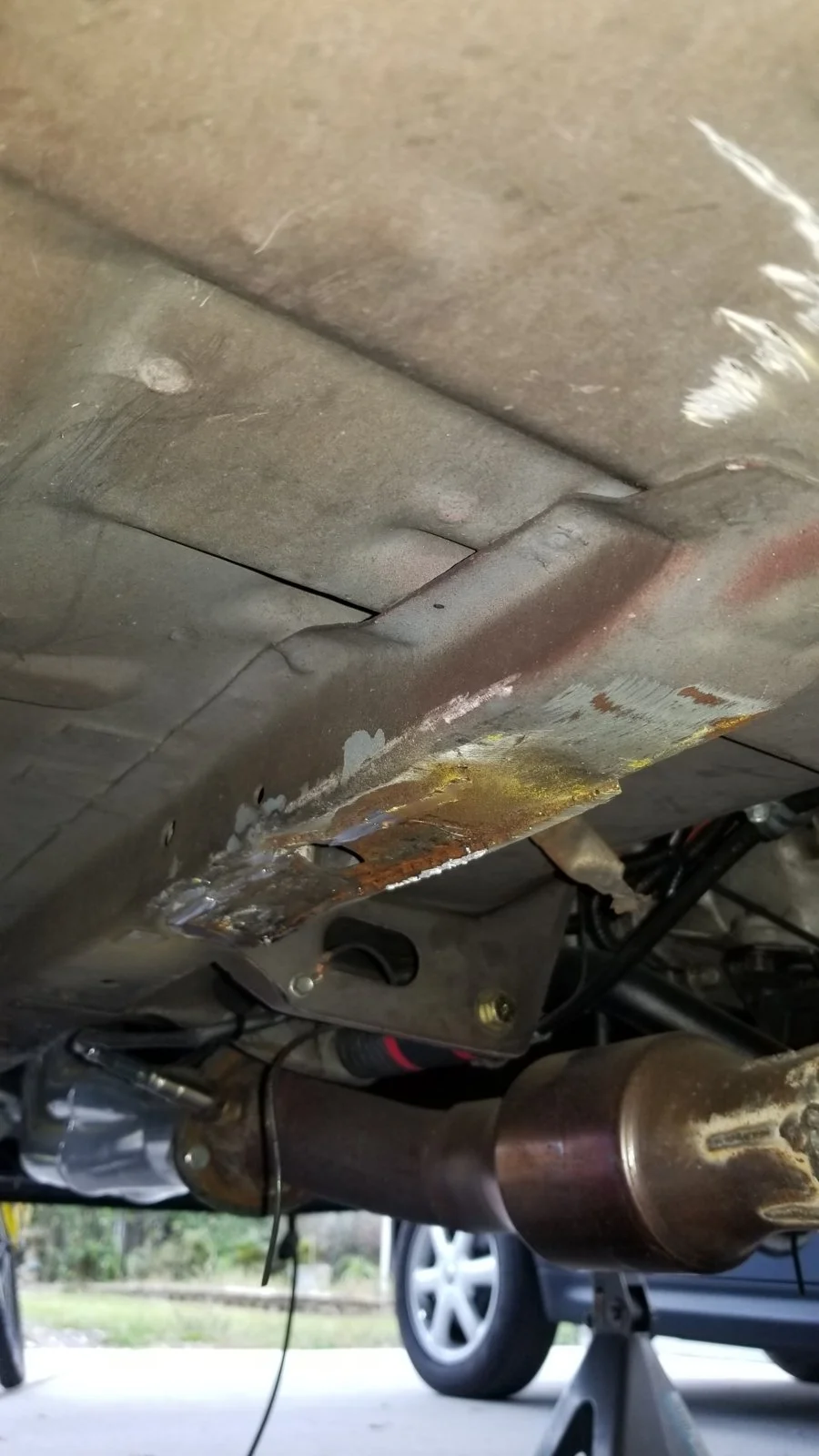

Today I finally went out and did something on my own car. It started with drilling out all the rivets holding the factory stiffener plates. Most of the rivets were doing nothing, I am glad i decided to do this now. The PO decided to weld the subframes onto the stiffener plate, they were basically doing nothing.
this mess was difficult to remove, I tried my best to leave the subframes undamaged

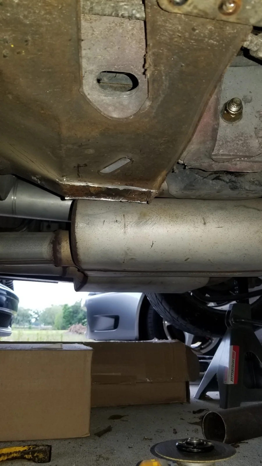

This is where I stopped, I ran out of daylight today, the new subframe has been test fitted and is still bolted to the seat but I want to clean the area and give it a coat of paint while I can. Then I will get these welded up, you can see the major difference in the quality.
This and the fit kit installed will be a major improvement.

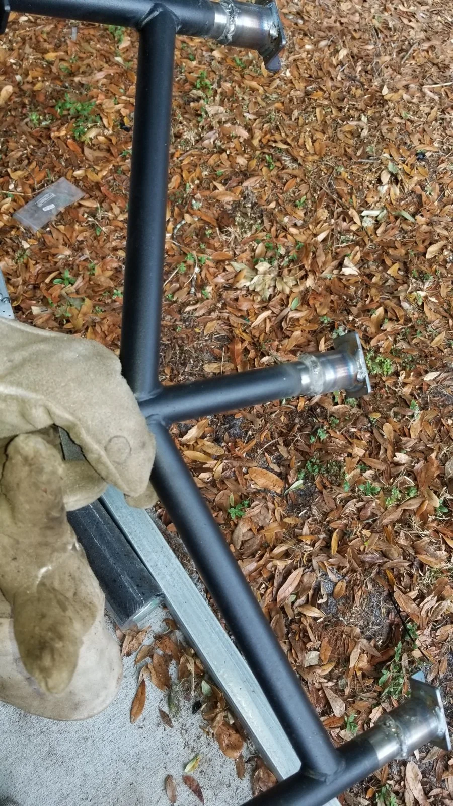

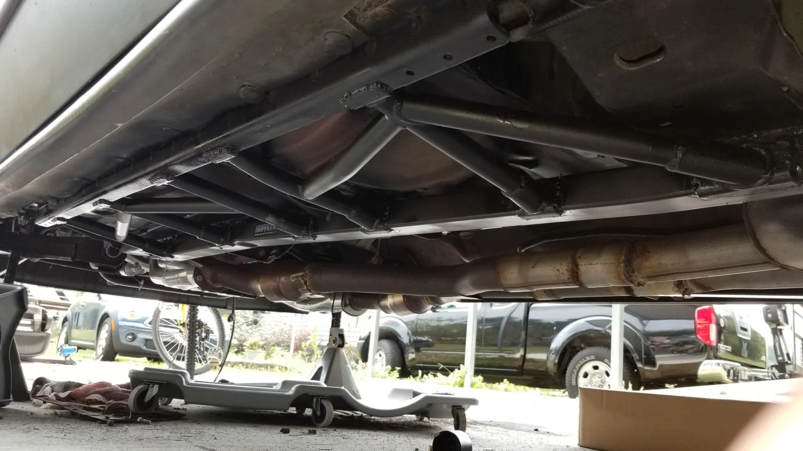

These welded nicely, I learned quickly what settings this new welder liked. I am not a super skilled mig welder but its smooth when you get all of it correct, this one is flux core.
Everything is in as you can see, took about 5hrs for this side alone. Now I get to start on the passenger side. I did weld the z rail to the pinch weld in 4 places along its length, I figure with all the rivets and a few welds it should be solid.

That is some SERIOUS Sub frame connecting there man. And your doing the same on the other side? WOW
I guess as long as you can have the room to do all the work you need otherwise with them installed. I would put a weld on the pinch rail 1 inch per every 6 in to foot. Why not if you have the time and patience. Plus Practice on a MIG is Practice in any way you get it, especially overhead.
