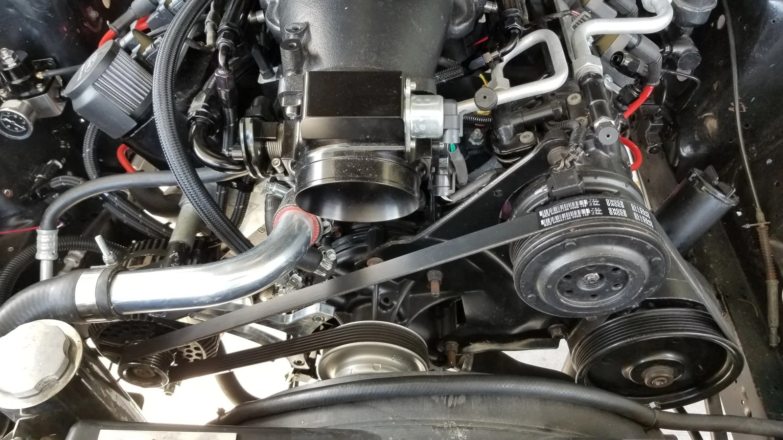

Had to modify a 351 alternator bracket for v belt to get the alternator setup the way I needed it.

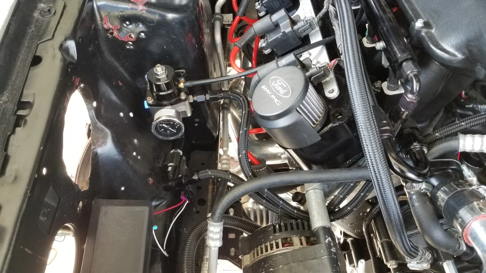

The regulator got moved and made permanent, the sensor below is a flex fuel sensor as I plan to monitor and tune for ethonal content.
