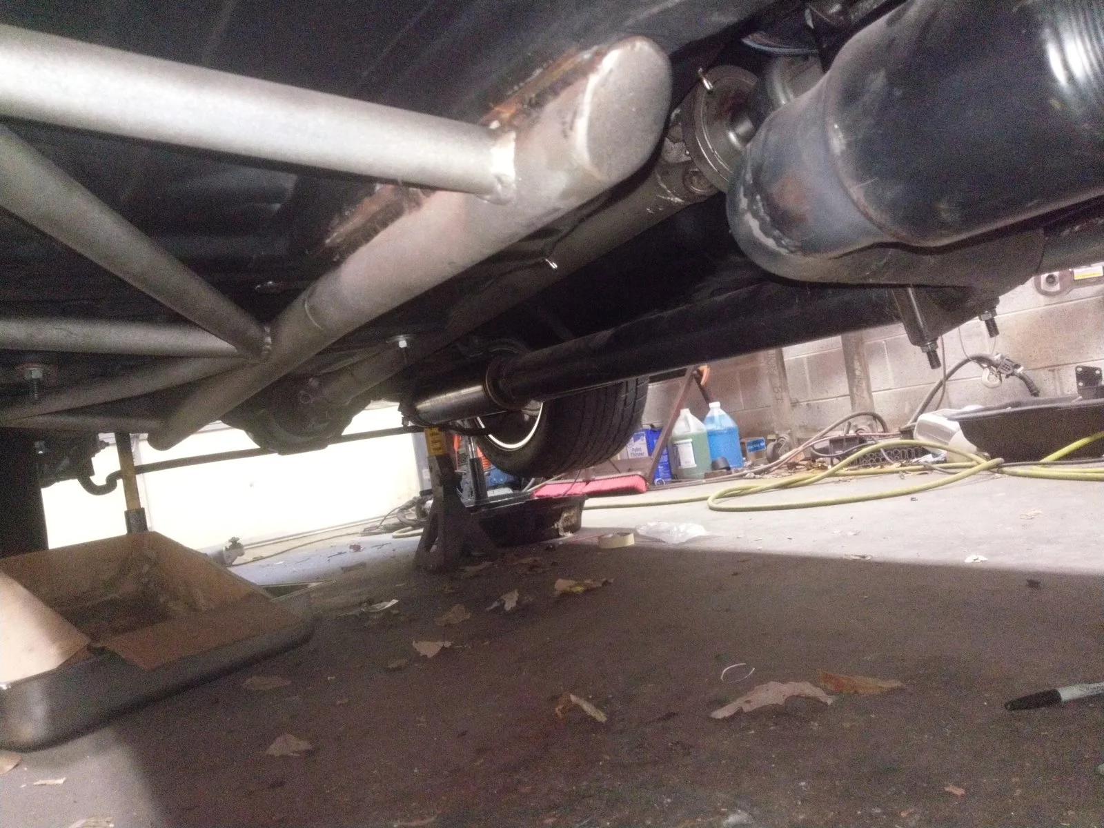

you’ll be glad you decided to go with the matrix style as opposed to the basic connector, especially with a convertible. it’s almost like have a second set of frame rails.
I am excited to get this part done, while I am doing this work I see some cracks in the torque box area. Is it advisable to clean and weld those back?
I have not done the reinforcements on the boxes but that may happen soon, I just dont want to remove the speaker box to get at the top side of the plate bolts.
Like Thief said. Drill small holes at the end of the cracks and weld them up.
Might as well do the torque bax reinforcements now. You won't be back under there until you tub it.
hmm.. what is the alternative to bolting it in the torque box reinforcements? can i install them and simply weld them in?
I would have been completely done with the passenger side subframes and bar system if I had not run out of welding wire.. I have all of them tacked into place but I will have to make a run tomorrow to get more wire to finish them up.
Dude, you can drill a small hole at the end of the crack then zip 'em up but honestly, you prolly should go ahead and do them, if not you will be so busy enjoying the ride you will forget all about the reinforcement plates.
