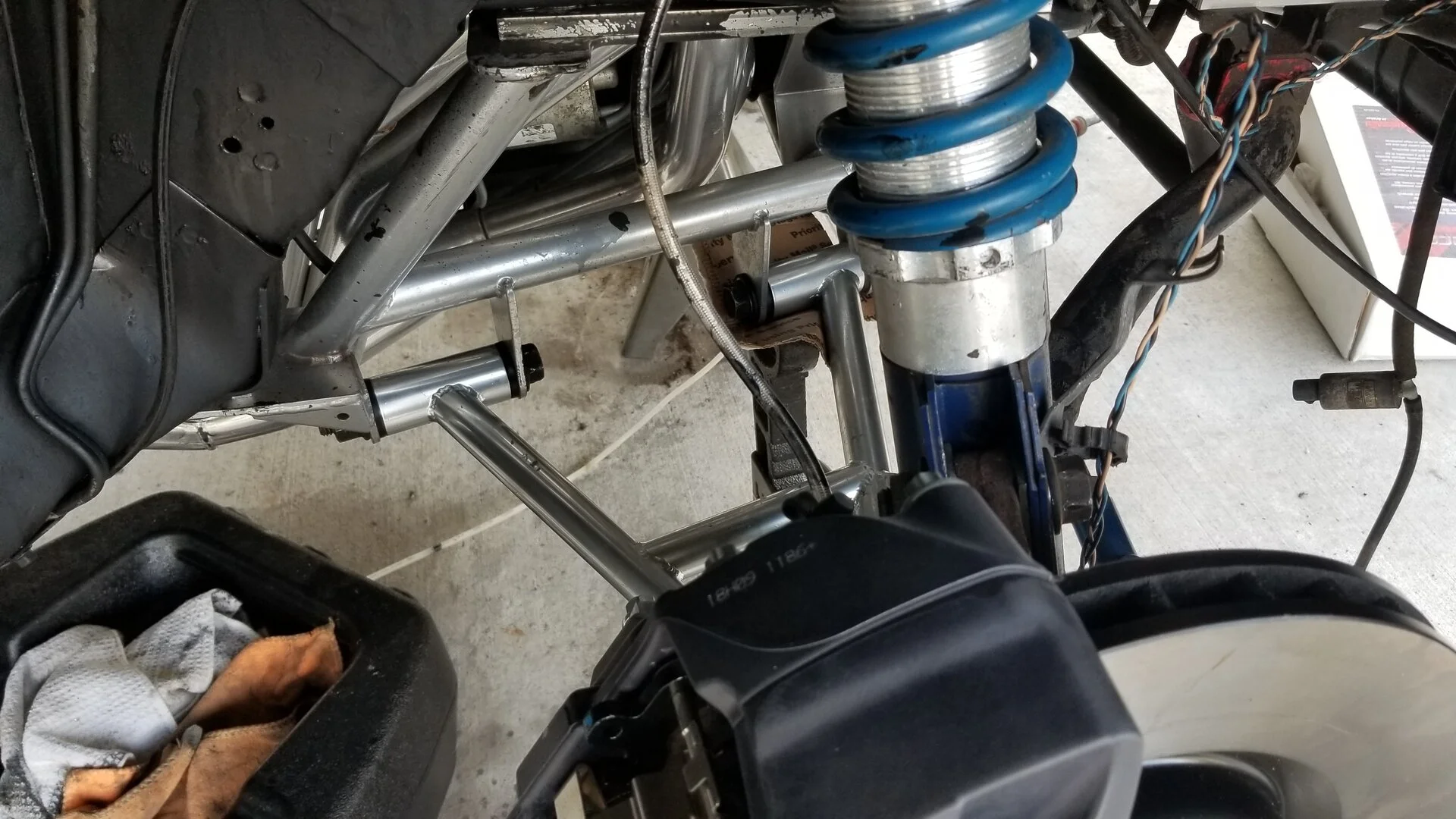

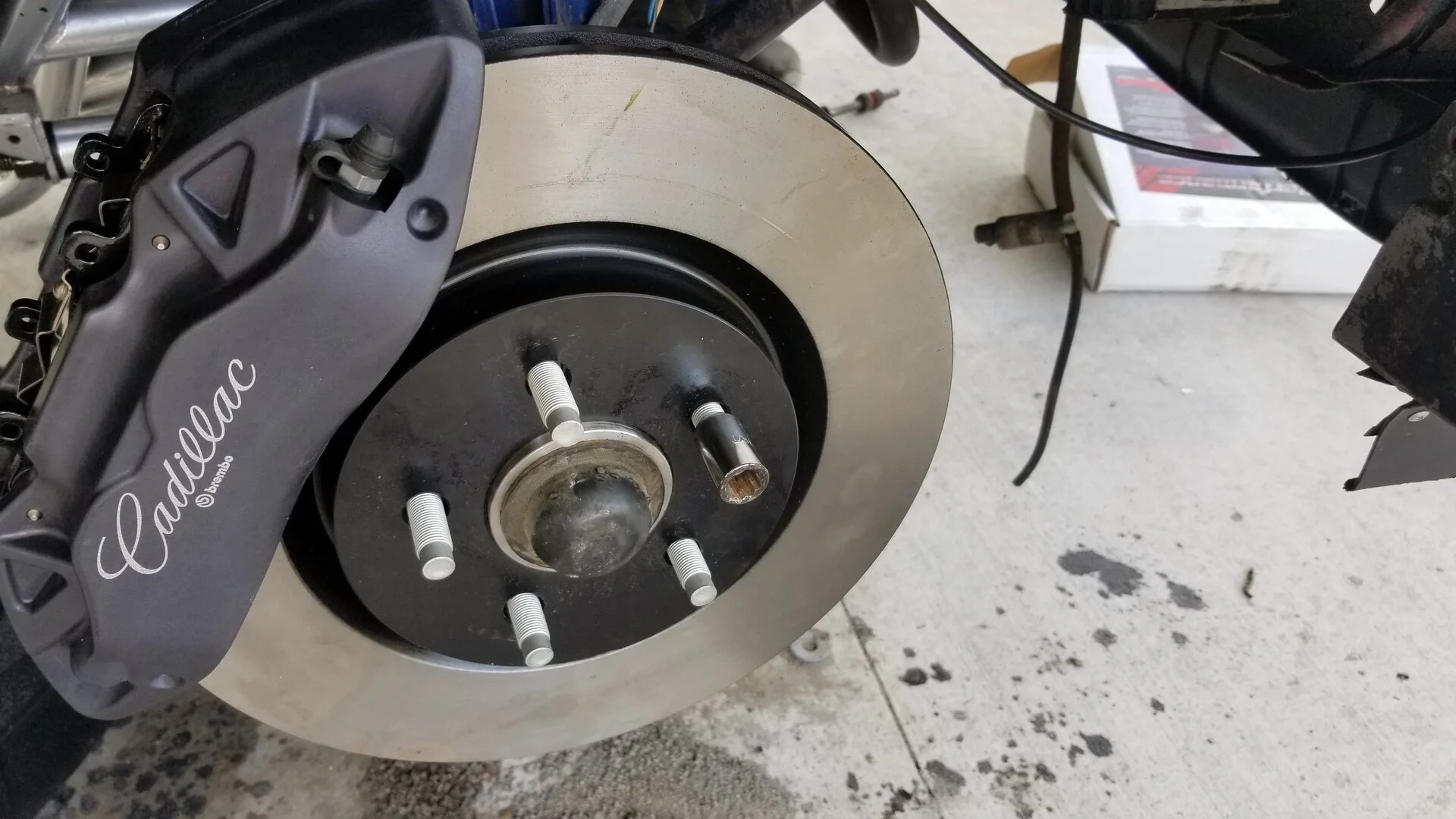

For the record, with the ATS calipers the ford brake lines will work, you need a 14100 banjo bolt and it fits just right.

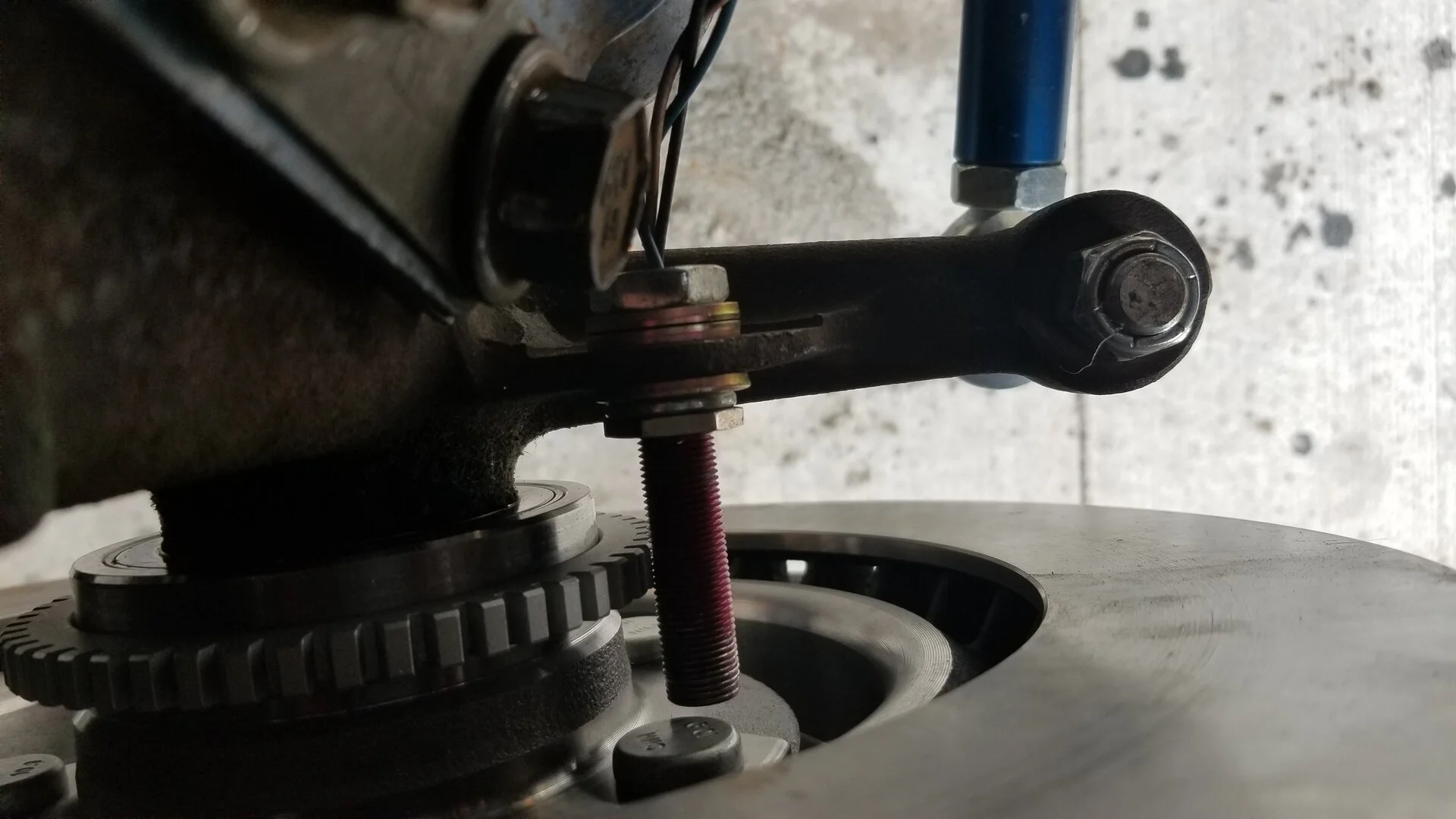

More information for anyone that is looking to do this swap.
I used a set of Russell's braided stainless lines I had for the factory calipers, I was able to reuse it for the ATS caliper installation using a 14100 banjo bolt. At full drop with wheels turned to full lock the line still has play in it mounted in the factory location.
The SSEngineering kit worked perfectly and left the rotor centered and the pad has contact with the full rotor area.
On the wildwood prop valve I am using the recommended 4 turn starting point with a cobra booster.
Now some pictures of my mess...
The center picture is a hall effect sensor I am using to watch the wheel studs. I was going to use the stock sensor and tone ring but have to deal with a VR sensor if I go that route.

Are you going to leave the Cadillac script for the posers to scratch their heads over?

Yes I am, they have a nice finish and i intend to leave them just how they are. The rear calipers are red but that may change depending on how i feel once the car is on the ground.

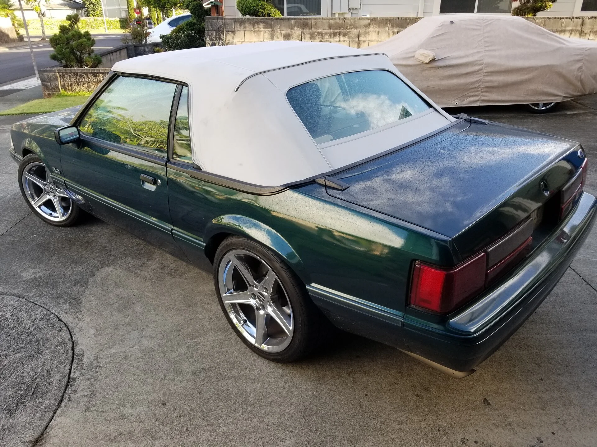

I put a coupe trunk lid on my green car. I like it better without the rack.
