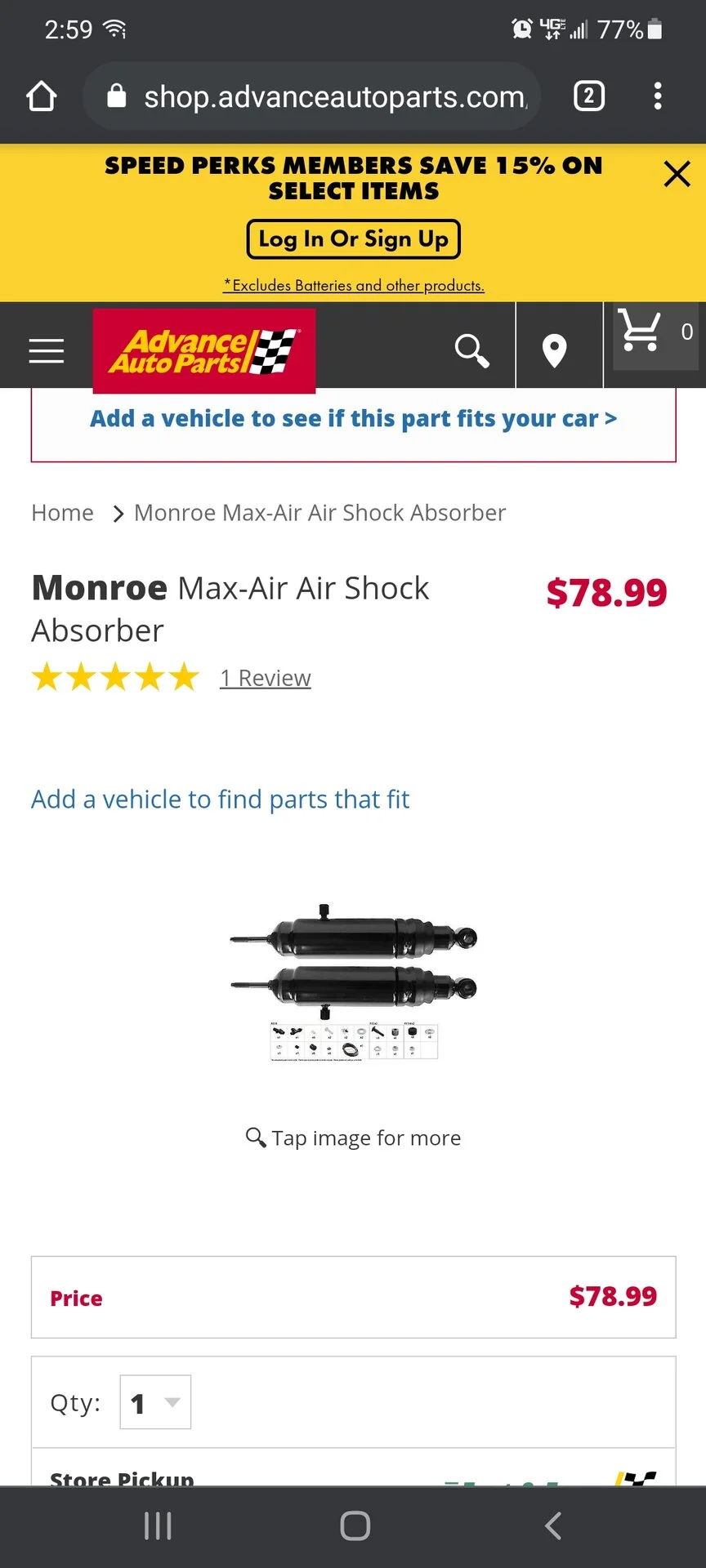

CarMichael Angelo said:
Uhhhh air shocks?
Not if the car will look half retarded like this example

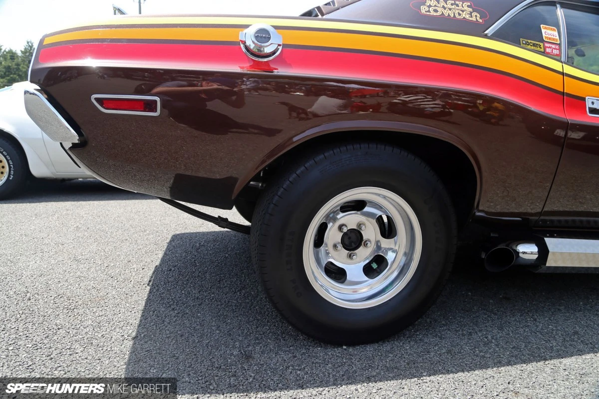

Beauty is in the eye of the beholder.
Besides, they don’t even make air shocks anymore.
Sorry.

Air shocks would raise the rear though. I had them on Papa Smurf my 1988 econoline van. They do make them in the mustang style but no idea if they'd fit inside the shock tower. ( not that you'd go this route anyways ).
You could put a rubber spacer above the rear spring. That'll raise it up a bit. Been so long since I've paid attention to factory style rear springs on our cars. Didn't sky jacker make adjustable rear control arms for raising the rear of a fox ?
