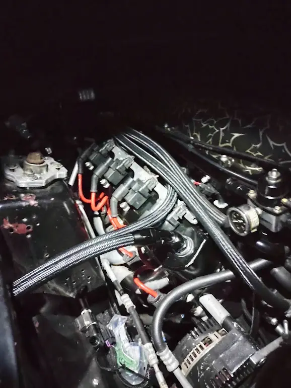

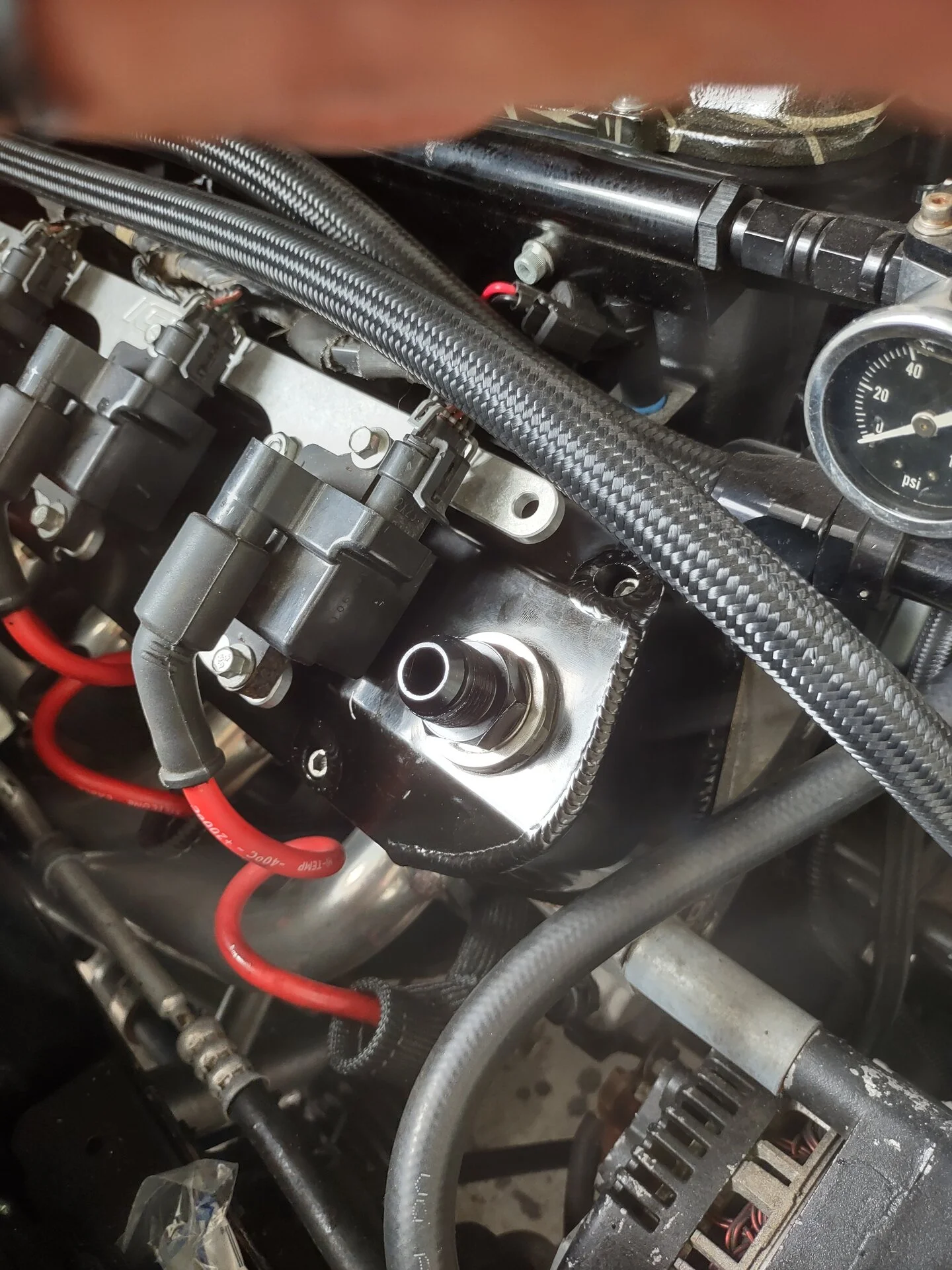

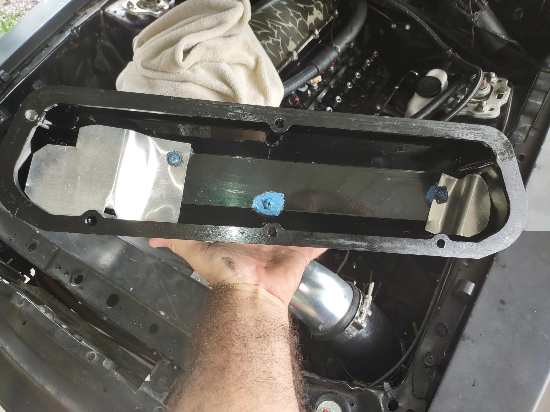

I really like these bulkhead fittings, if I have an issue with the other side again I am replacing those fittings with these.
Both covers got the diy baffle treatment.
Reactions: KZGUNS, General karthief, stanglx2002 and 1 other person

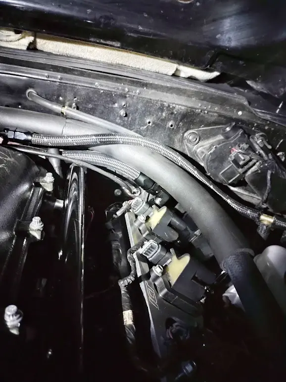

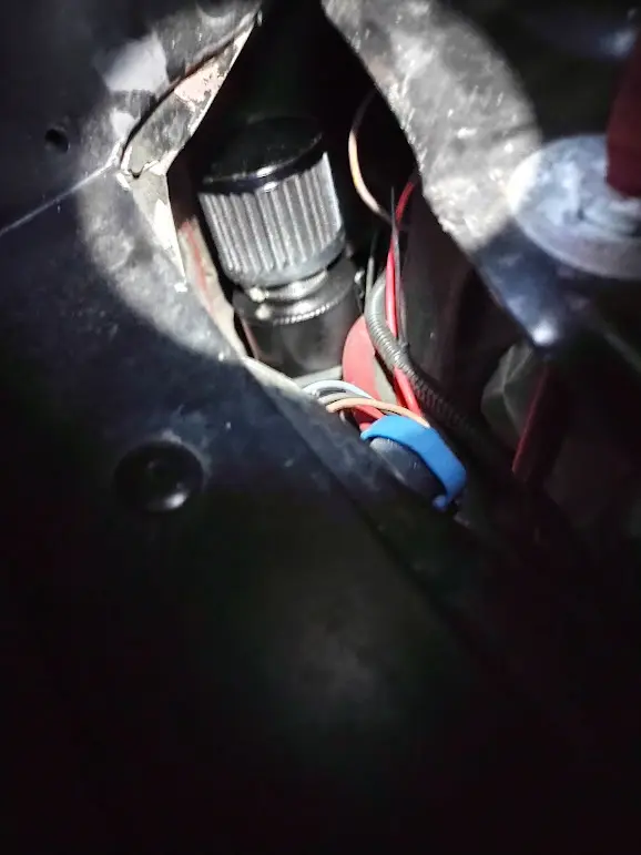

Work work work... thats all I seem to have time for. I was trying to get more done on Sunday but my lift pump decided it needed to be dug up and worked on.... it was a ty day ..
So how about some terrible pictures of the can install with a flashlight?
You can see the -10 line and 90* fitting tucked below the AC line, it just barely fit below the pinch rail.
I am not sure if I want to order the nice line spacers/holders for this job or if I just give it the ziptie treatment and move on.
You can see the two can lines run together into the fender.
The can tucked away down in the passenger fender... it is mounted using the bolt that holds the fender support bracket, almost like it was meant to fit there.
