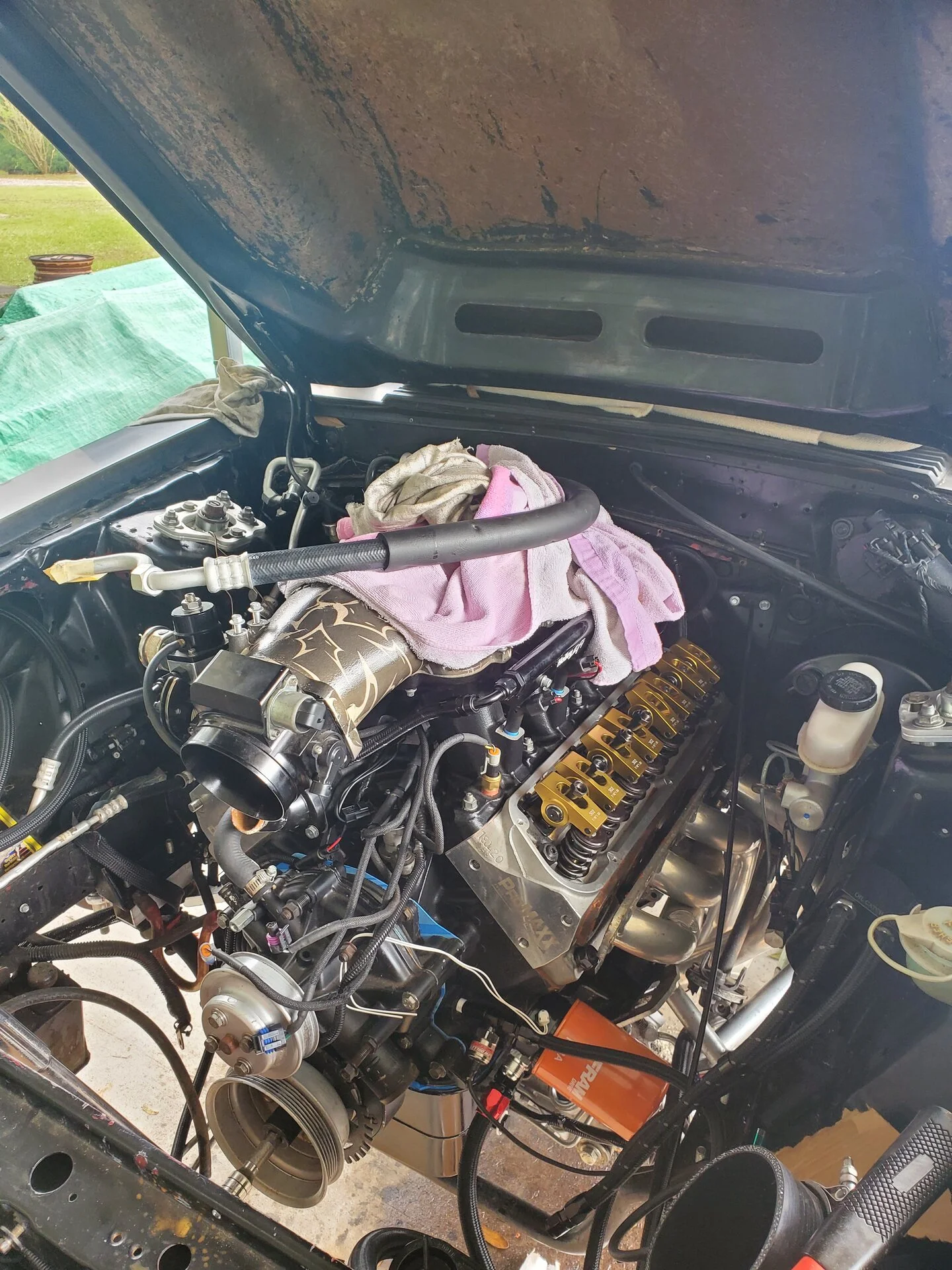

isn’t your engine a 393?
I took some time off to lurk in other threads.
I have the engine built back to a long block, used a set of total seal steel rings gapless top.. expensive but specific for the build. We opened the wall clearance up to 50 from 30 so that I can run boost without worry.
I had a new converter built for it as well. The 3k stall is out and a 2300 stall is in. Should let me make better use of the torque curve on this many cubes.
I also replaced the brake booster with a cobra unit, hopefully it's not so large that I have clearance issues.
I still have to setup the rockers before the engine goes back in the car.
Engine is back in the car, we found a few broken rocker arms they were cracked right under the roller.
So a new set was in order.

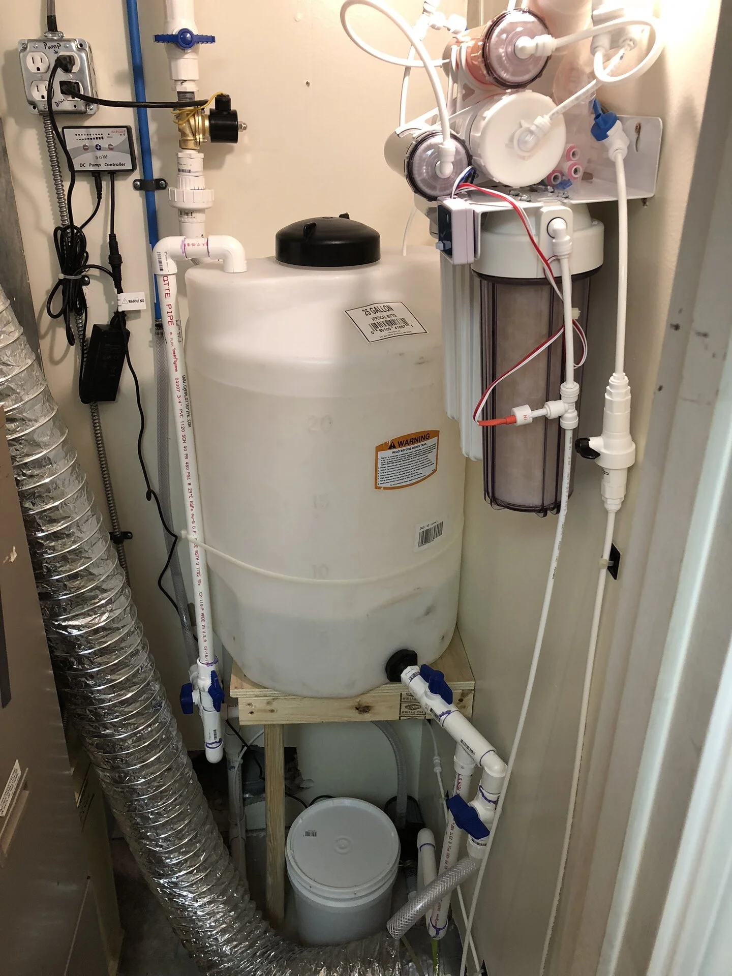

I really wish I had room somewhere that I could make something like that. I would have to build the rig outside but thats not a big deal.
This is a very small space next to my furnace/ac. 30gal. I also plumbed in an electric valve so I just flip a switch to start a water change then another to pump new water up to my tank. Older pics. I’m over run with green star polyps so I’m probably gonna tear down and restart this winter
