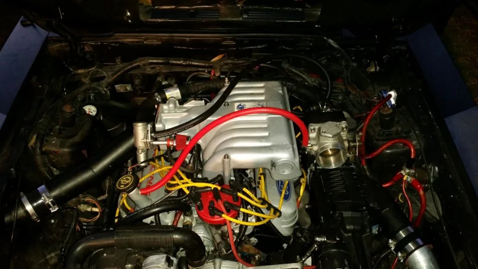

Bypass still colapses under vacuum, I will remedy this on Saturday. But I quickly slapped it together for testing, so here are pics of it in mockup.
sorry it's a dark pic, better ones coming later, and the others I took no worky...?
My frustration is getting the better of me.... I built a hard piped bypass tube, and tried everything I can think of to get this car to :leghump:ing idle.
My next step will be to remove the intercooler and see if that helps at all...... I need advice on what to try here. If the intercooler thing don't help, I will mess with my perfect idling NA tune, maybe she needs an ass load more timing at idle to stay running below 1300rpm.????
I can create a vacuum leak (SD so it doesn't matter) that let's it idle at 1300 rpm then slowly choke the leak off and she just dies... it's like she can't breath under 1300.. I will keep you guys updated this SUCKS!

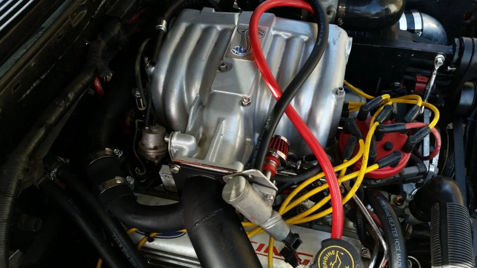

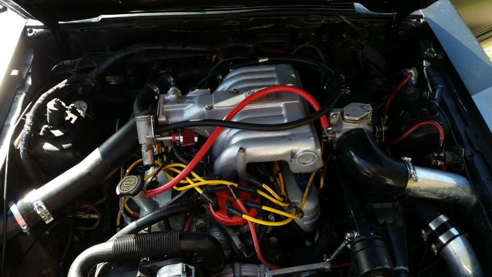

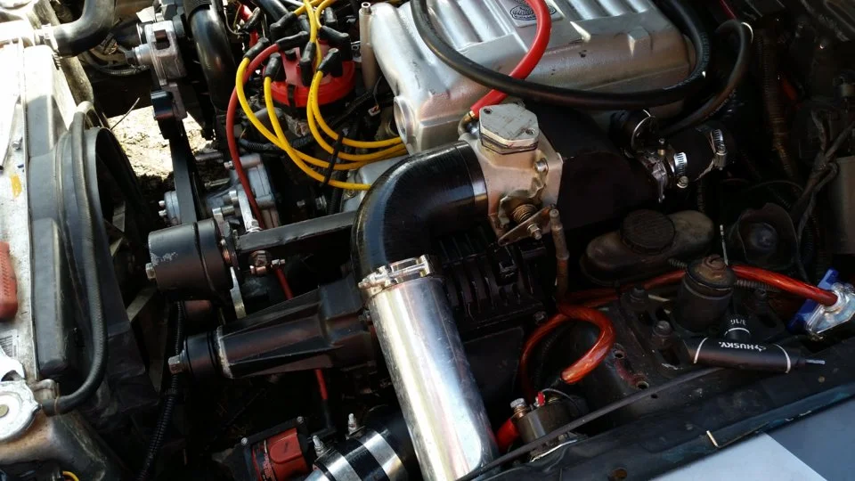

Here are some reference pics.
If its starving for air with the TB on the turbine, but not on the plenum side, does that mean the tubing itself is the restriction as in gulping/gasping for air too far away?
