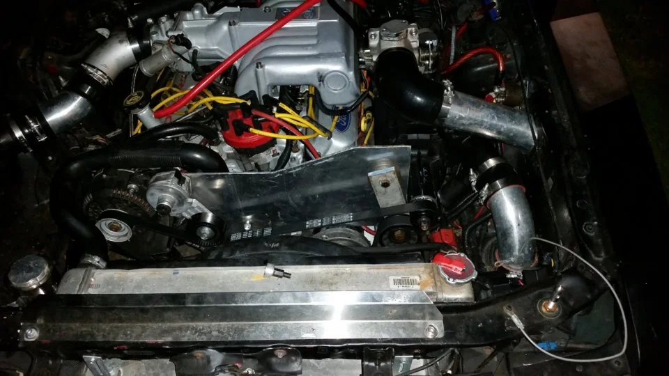

that's where I got to last night. Still needs some extra support and a few more pulleys will be added. The bar holding an idler pulley will be going away, as soon as I can get my mig going and some aluminum wire I will add ribbing on the backside of the bracket. It still needs to be trimmed down but right now it fits under the hood.

stang89bidges
Advanced Member
Mar 14, 2014
727
144
74
Fort Worth Texas
May 13, 2016
#603
  • May 13, 2016
  • #603
Functional question.
Could the tension pulley on the long arm bar stock you made be moved to the middle of the new plate you made so you could remove that arm completely? Or is it needed below the SC pulley like you have it now? Just wondering, it would really clean up nice without the arm is what I was thinking. But it wouldn't be a great Frankenstein without it of course, your making it all purdy and stuff
a91what
SendMeUrDataLog
Apr 6, 2011
10,733
6,716
214
Hillsborough county
May 13, 2016
#604
  • May 13, 2016
  • #604
Sure it could. But it needs to be where it is and a few more added near the middle of the plate.
The Issue- when I get on it hard between shifts the belt slaps around. This causes the belt to stretch and eventually throw itself, it's even more violent on a 2 step launch..... so this is the palette to create a slap free system that looks less franky......
Don't worry once the turbo starts to go in place I'm sure it will look like a science experiment. Lol compound boost will make up for those iron heads!

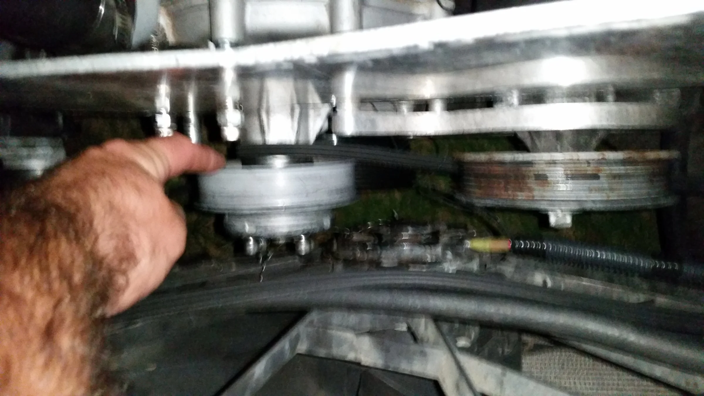

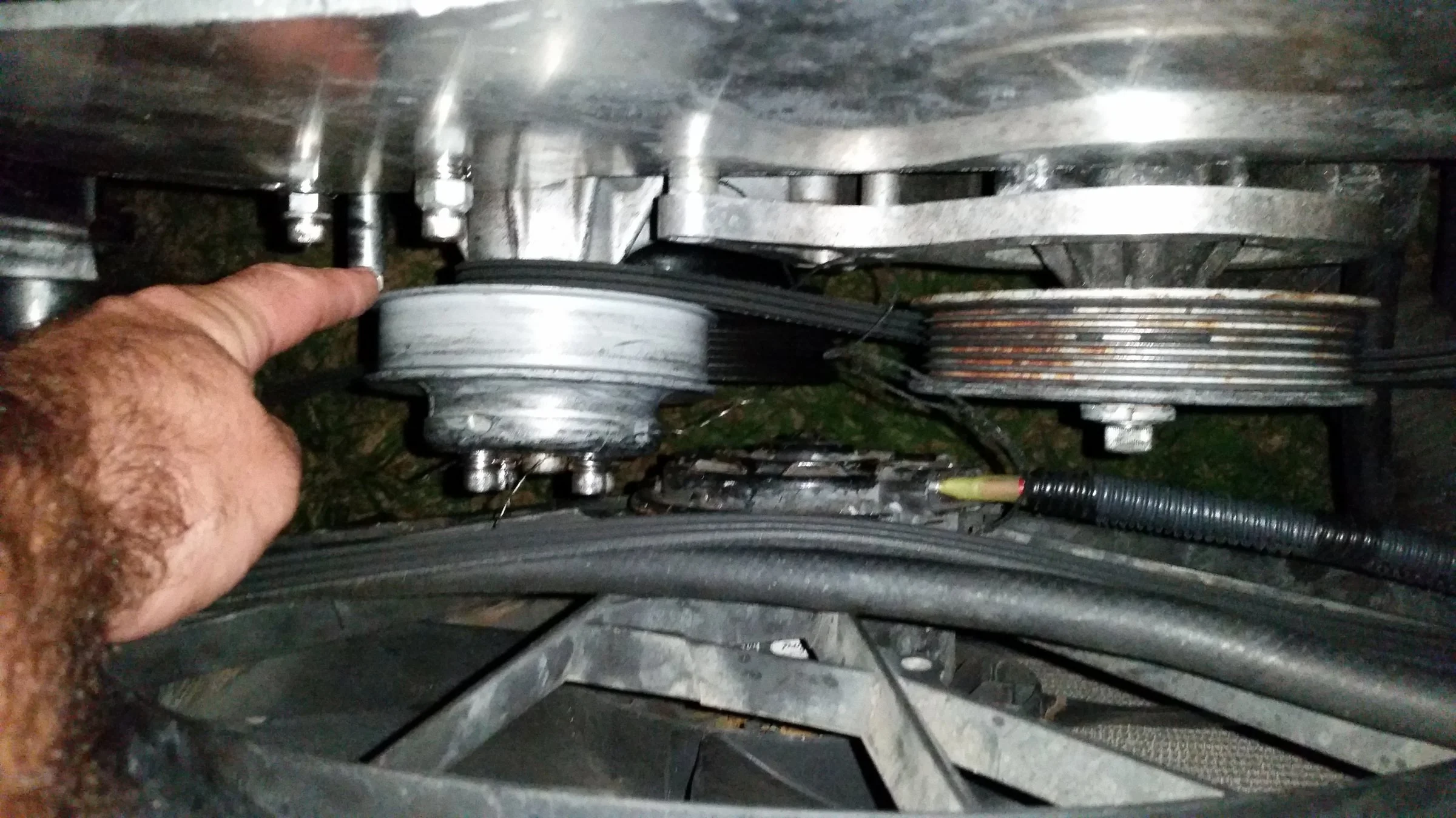

Well me running. Took the car for about a 50 mile drive, everything went great except for some stalling issues that I need to work out (think the tfi is going out).
Until I was one stop sign from home. Got on it pretty hard and the car started making all kinds of racket, from the sounds I though I had lost something in the valve train for sure. I got the car limped home (almost overheated) once I opened the hood I discovered this.here is another.either the bolts backed out, (lock tight and lock washers not so sure) or it stripped out the mounting holes (even less likely).

Admin Dude
Jan 4, 1985
43,353
21,554
Box behind Walmart
May 13, 2016
#610
  • May 13, 2016
  • #610
First, a question: Does this thing still have two throttle bodies on it?
Then a comment: I would be willing to bet that whatever it was that came apart or backed out, was already suspect. What I mean is that you probably expected it. So now you gotta do it the way you thought you should have.
You cannot have flex in your pulley setup. I say this because I think it would have to exist to squirt out that many parts.

stang89bidges
Advanced Member
Mar 14, 2014
727
144
74
Fort Worth Texas
May 13, 2016
#611
  • May 13, 2016
  • #611
Bummer man, it could have been worse though.

a91what
SendMeUrDataLog
Apr 6, 2011
10,733
6,716
214
Hillsborough county
May 14, 2016
#612
  • May 14, 2016
  • #612
Yes... wrinkle black.
Yes still has 2 TB on it, that is a must for the system to work.
No, I was not expecting this, at least not from the water pump. BUT all the pressure from the crank runs over this pulley first.
There is probably some flex in the system sure. If there is I cannot see it.
So now I have to figure this out, then the stalling issue it may be tune related only seems to happen when I ubruptly lift the throttle during a high electrical load.

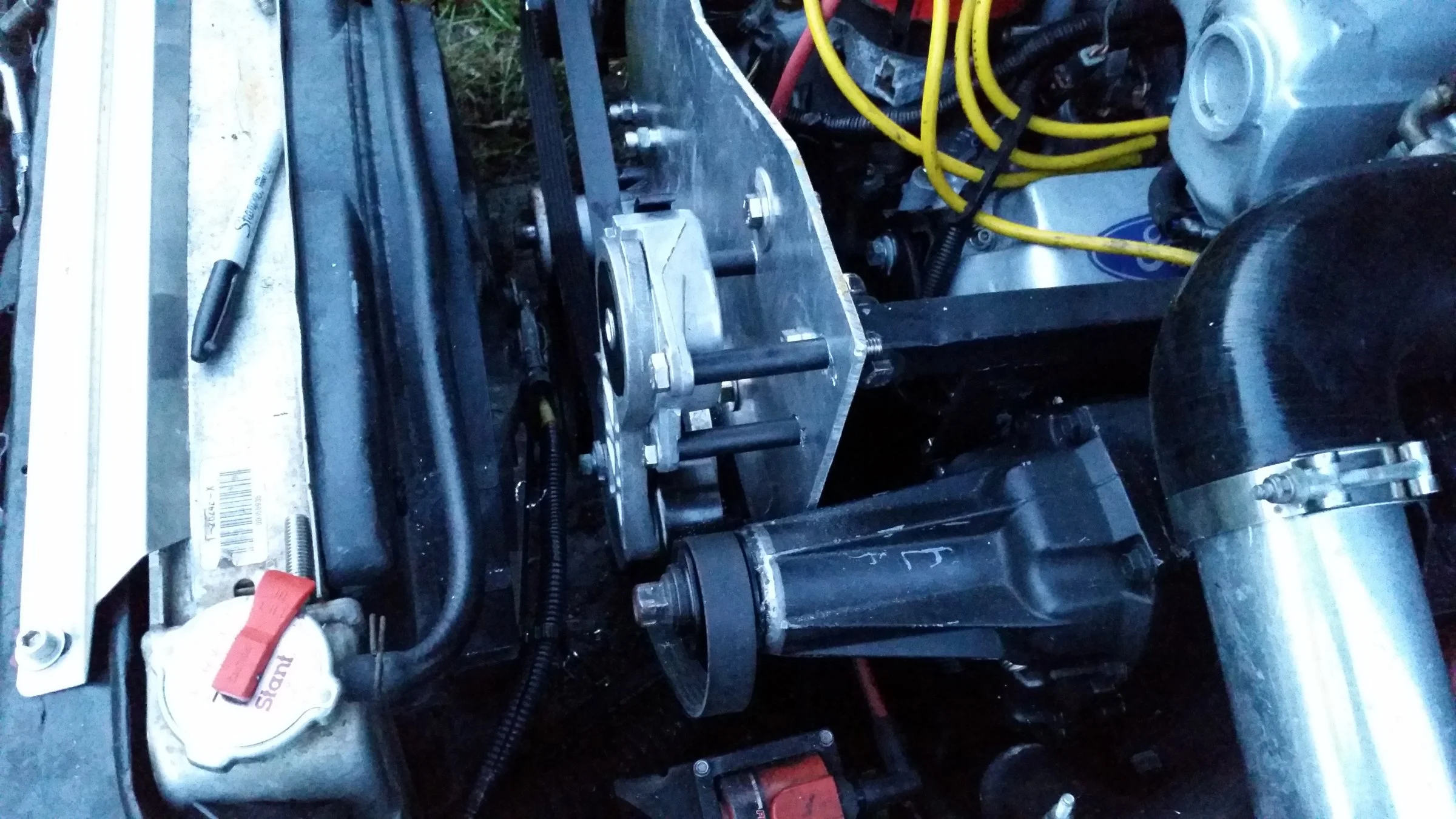

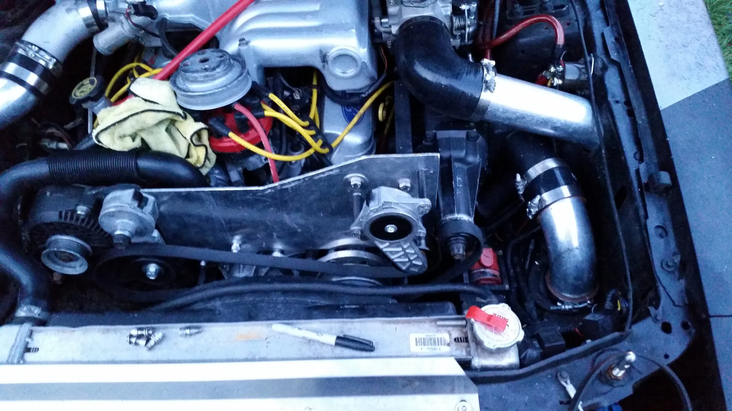

Got some more progress made today. I decided to try a tensioner from a 4.6 as it has a lot more spring pressure. I used a pipe cutter to make the standoffs. I have some thick bar behind the plate to act as a backer too reduce flex. I have not tested it yet but I can say I could not get any flex out of it with my body weight.

stang89bidges
Advanced Member
Mar 14, 2014
727
144
74
Fort Worth Texas
May 16, 2016
#614
  • May 16, 2016
  • #614
That's lookin great man.

a91what
SendMeUrDataLog
Apr 6, 2011
10,733
6,716
214
Hillsborough county
May 16, 2016
#615
  • May 16, 2016
  • #615
I still need to add another pulley between the two tensioners. That way there is not a long stretch of belt slapping around. I need a mount for the pulley though, can anyone point me in the direction of one?
Otherwise I will need to make a one.... I wish I had a mill .....lol
I would like to find an oem option to make things easy. (I know I know "easy")
grnhays
Sep 21, 2015
63
21
18
Green Bay, WI.
May 17, 2016
#616
  • May 17, 2016
  • #616
Do you want to use an actual pulley or a idler pulley? I suppose it will be a pita regardless. The idler would be easier to mount up, I would think.
a91what
SendMeUrDataLog
Apr 6, 2011
10,733
6,716
214
Hillsborough county
May 17, 2016
#617
  • May 17, 2016
  • #617
Something statically mounted. I already have 2 tensioner on there now.
