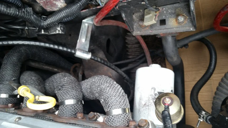

My bypass will have a silicon coupler very close to a header primary. The headers are now wrapped which should help. But with 2 inches or so space between them I'm not so sure it will hold up. I am going to also wrap the bypass tube and coupler with header wrap. Any other ideas for keeping the heat at bay?

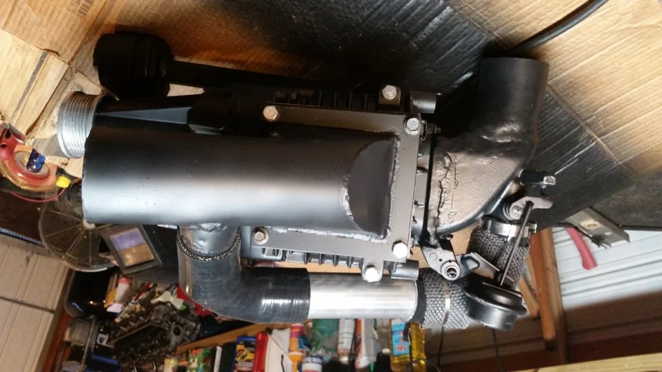

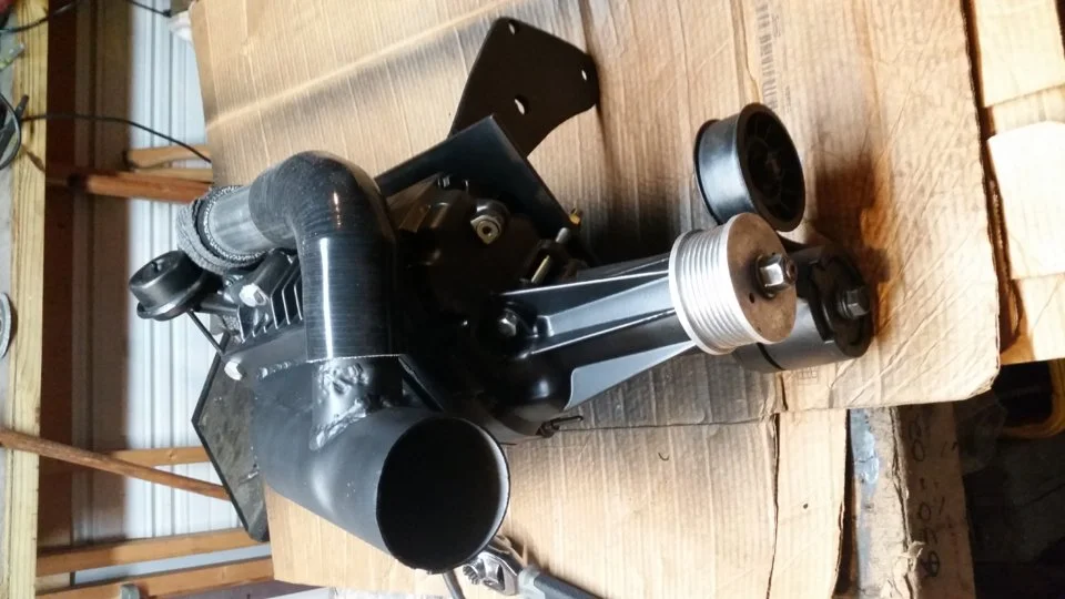

OK here it is the bypass works great used a 2800 rpm drill to spin it and capped the pressure side, opened the bypass with a vacuum pump slowly. This thing is noisy when capped but dead quiet once the bypass opens up. Moves a ton of air even at that low rpm.
Lots still to do
- wrap the passenger header
-new rocker arms
-install this and my ps pump.
-new gss342 fuel pump
-fmu
-gauges and other misc stuff......
Does anyone know where I can find a bleeder valve for the fmu?
Motivation is good too, let me know what you think good bad or indifferent. Criticism only makes us better.

Got the passenger header wrapped. Did I mention I hate that stuff? The aluminum gaskets I got leak like crazy, need to go thru and re-torque them. The battery relocation is done they are both in the trunk now. I still need to go thru and add a few more fuse blocks, I have a lot of unfused cable. ... which is a big nono. I got in 3 350amp ANL fuses today, but no blocks...... huh pictures are deceiving

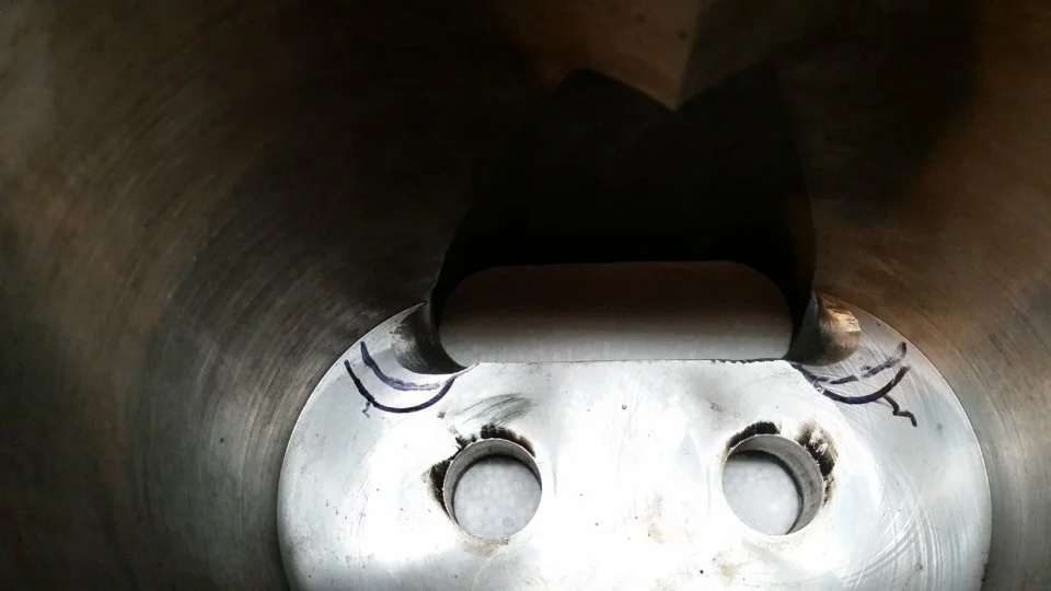

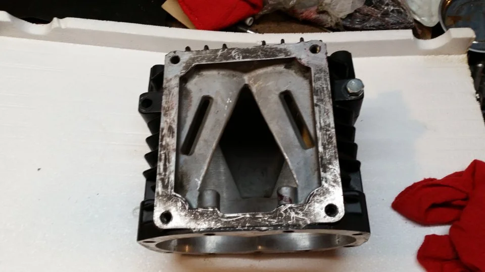

While I wait to figure out what to do (waiting for my heads). I decided to port the supercharger, I am no expert at this so hold back the witty quips plz.
while this is a minor port job there is not much material for porting on an oval port m90. HUGE gains can be made with welding for extra grinding area, but I am happy with the results thus far.
New bearings coming in for it soon.
