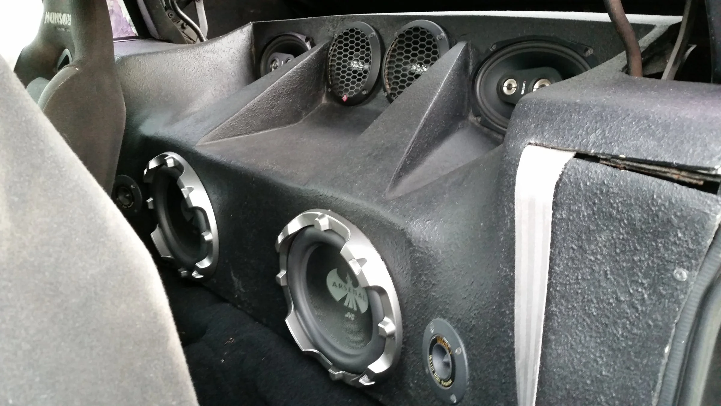

stanglx2002 said:
Dave can answer to this better, but I can almost guarantee that you will not be able to save the interior panels. Fiberglass makes a chemical bond when activated, so I would bet it is fused together.
I may just cut them free from the rest of the structure. Then strip them down with a D/A or angle grinder, then finish/shape them with fresh glass work. Done correctly I could even paint them to match the car...
Then I can make the speaker box seperate. I still want the speakers out of sight so a false front panel will work.

You probably shouldn't need the extra glass work to finish unless the panel were cracked and broken before the speaker box was built. Are you going to try and put the texture back in or do you care?

The box was coated with roll on bed liner. I may use it again if I have enough, it makes the finished product waterproof and hides imperfections.

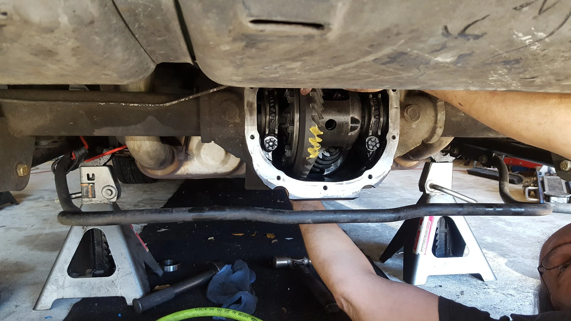

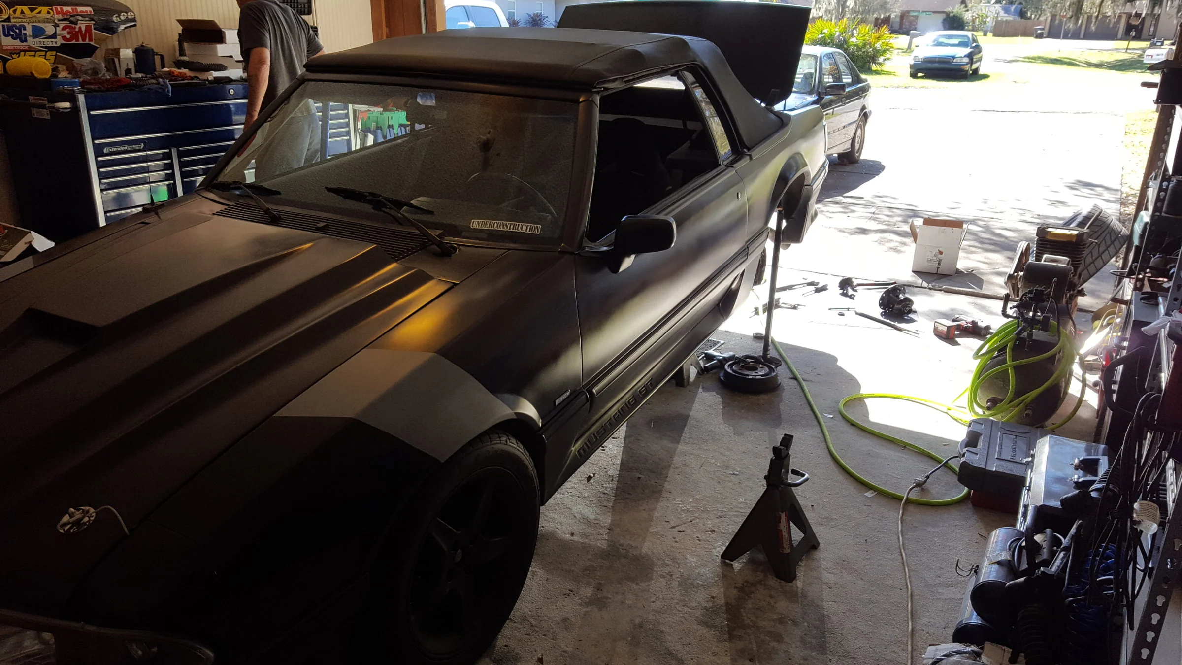

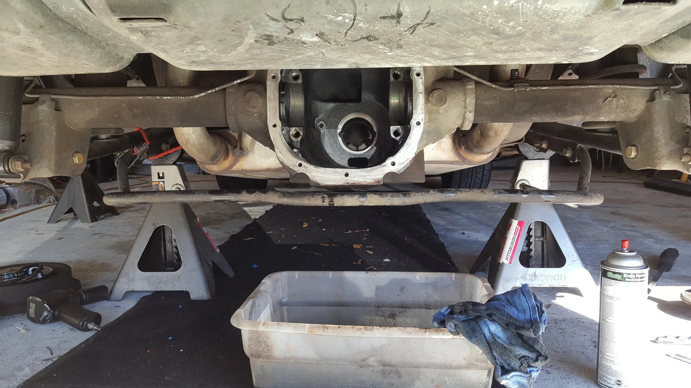

Well it's Monday and we are out in the garage. We are starting with the gear swap, going from a 3.73 to a 3.08.... I know it's a big step but I think it will make the car easier to take a cruise in. So let's begin.
The car was torn down before I knew it, like usual I have halfway point pictures to start the tale.
disassembled the rear-end at this point we have the axles out, removed the center chunk and pulled the pinion.

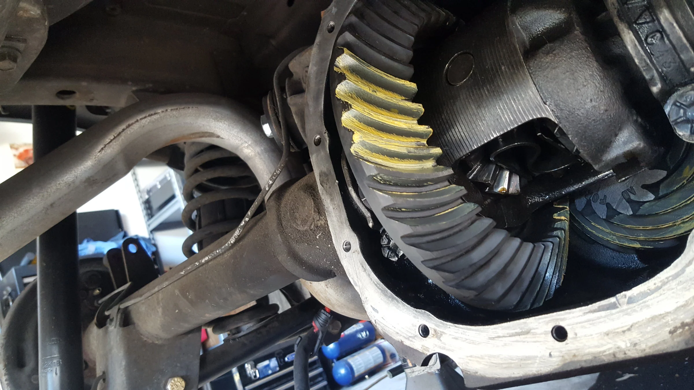

I'm about to put the cover back on the differential, I think we have done more goofing off than work. Lol.
Right now I'm actually watching some grudge racing videos from Orlando Speed world, lots of fast car out there.
We got real nice engagement on the gears.
