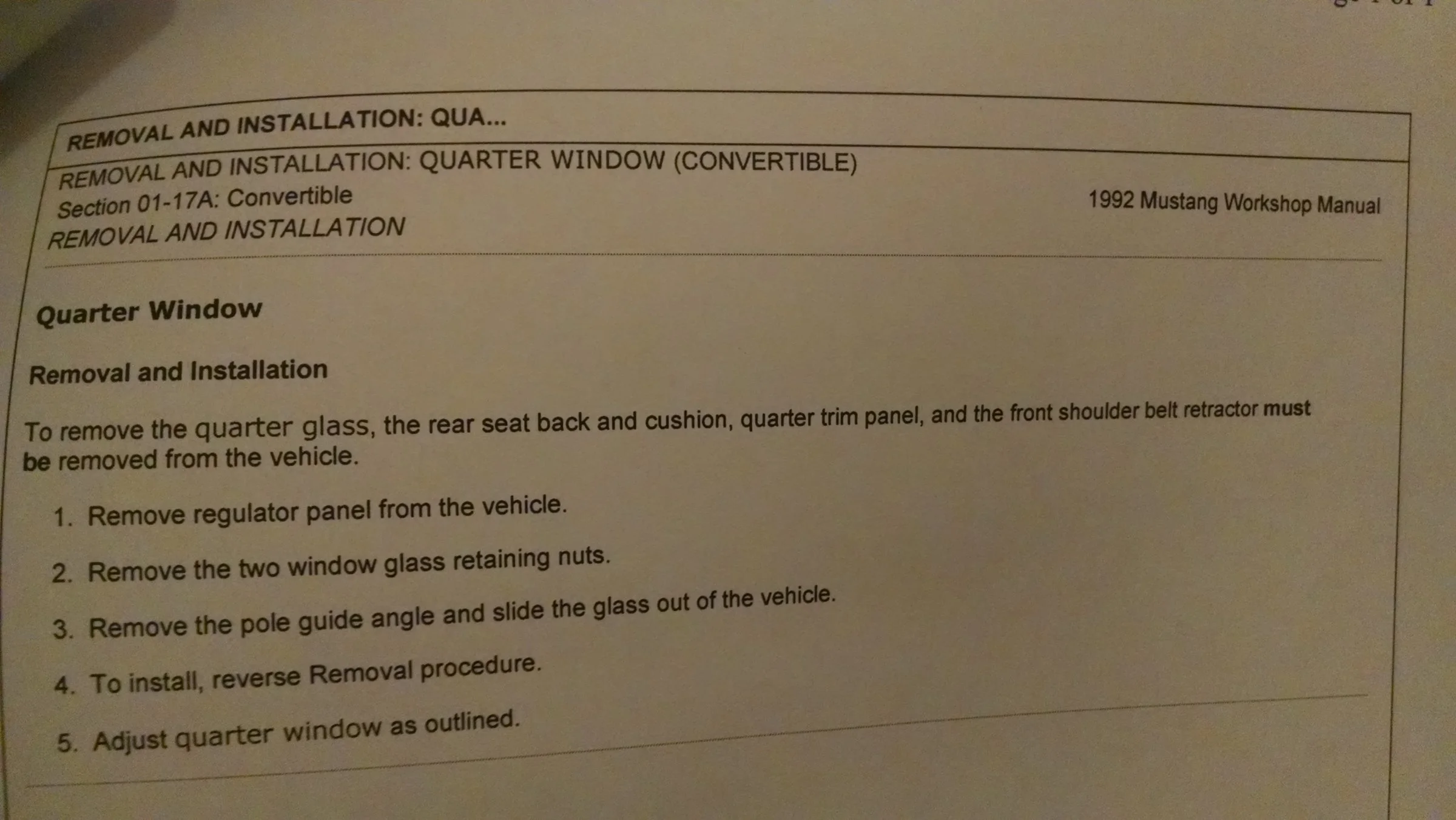

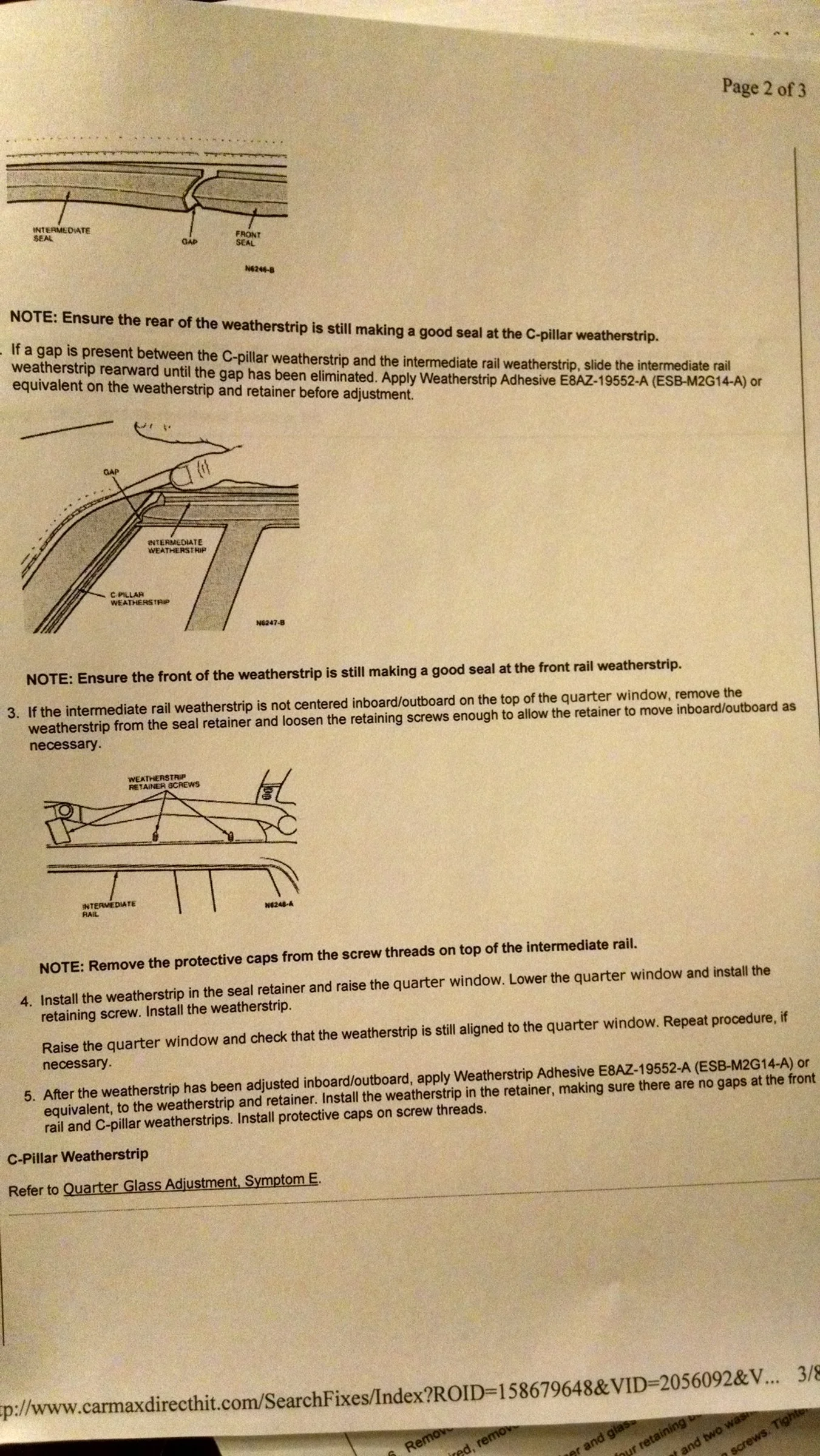

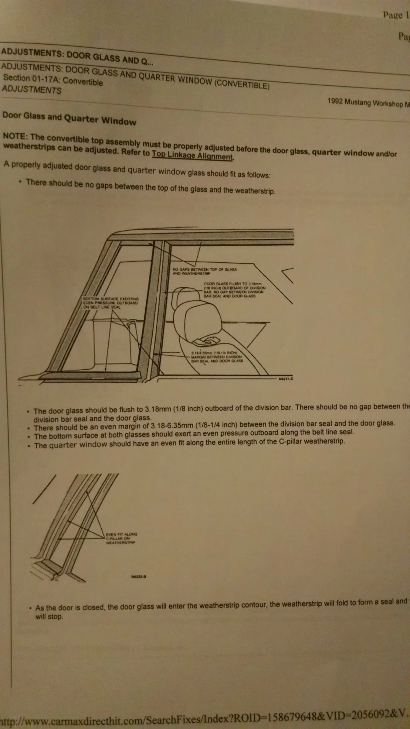

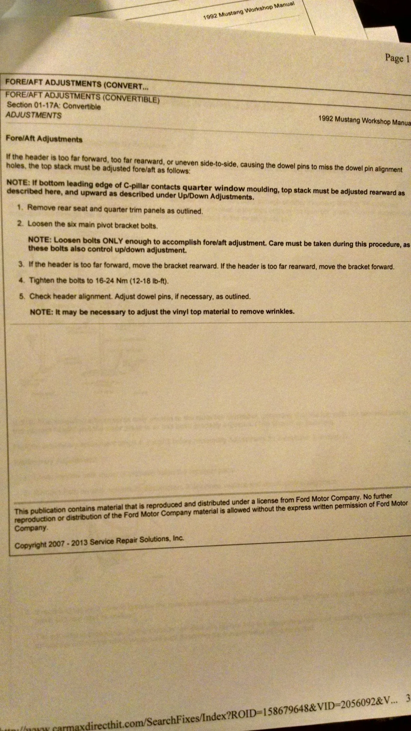

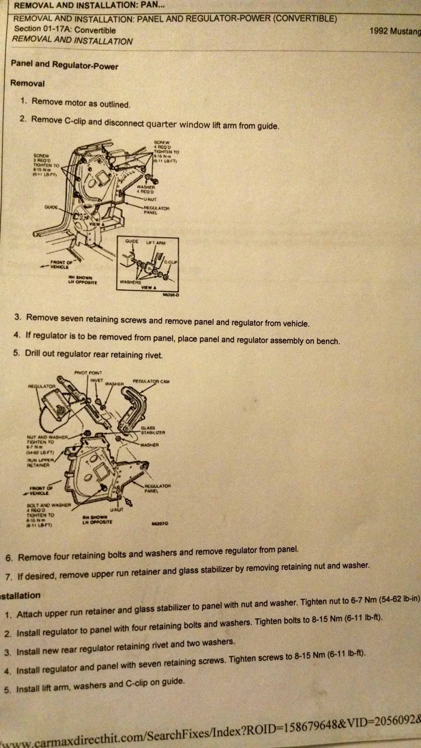

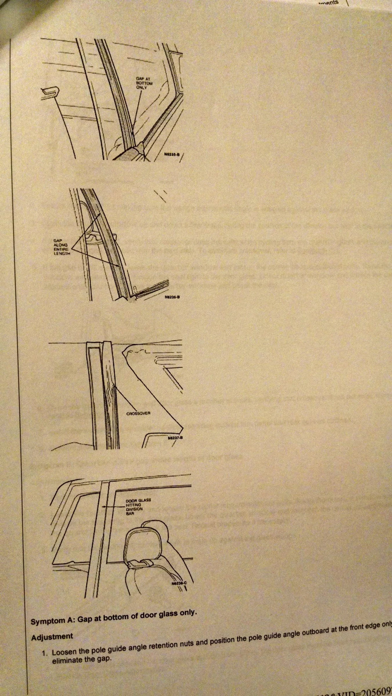

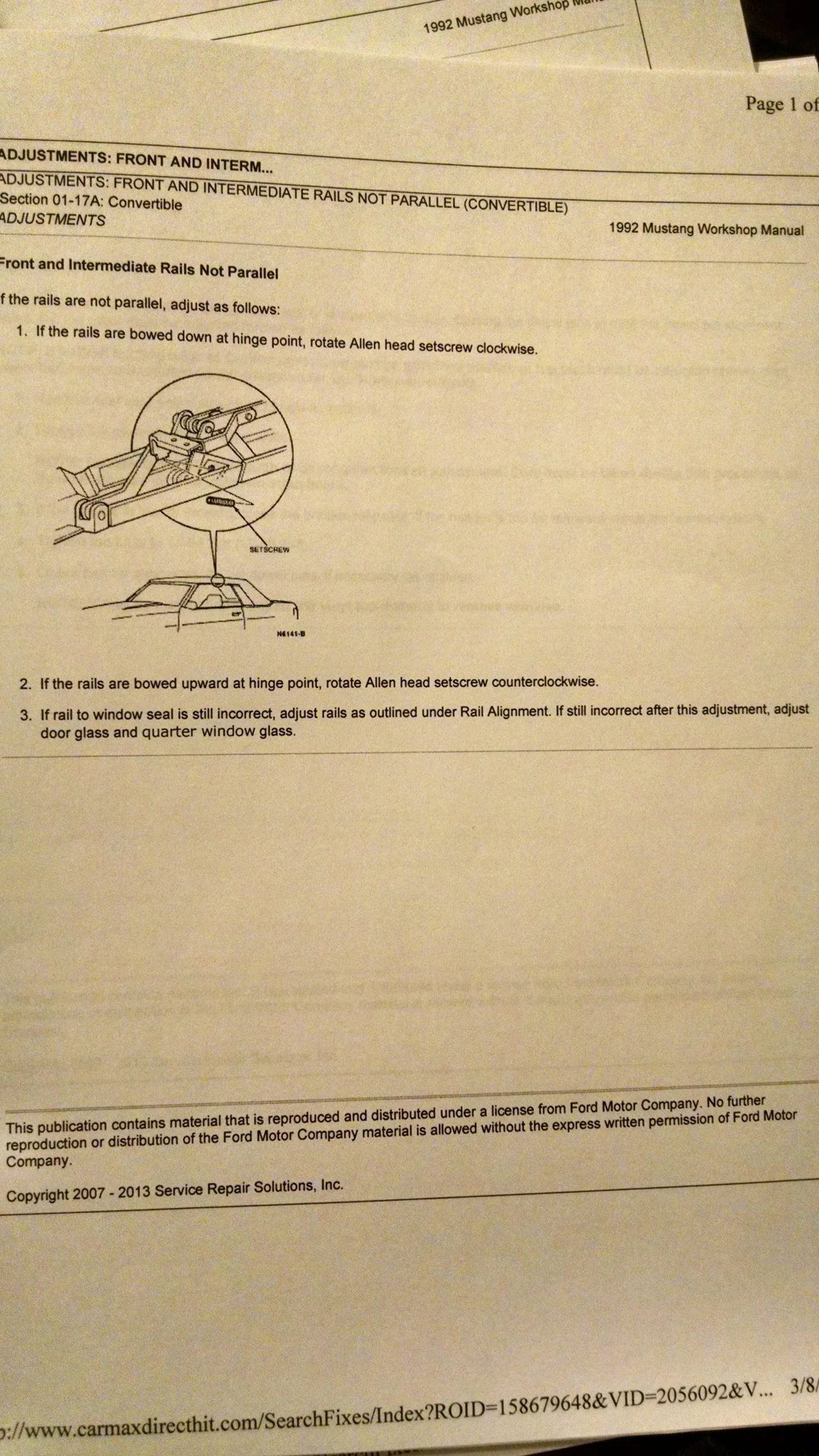

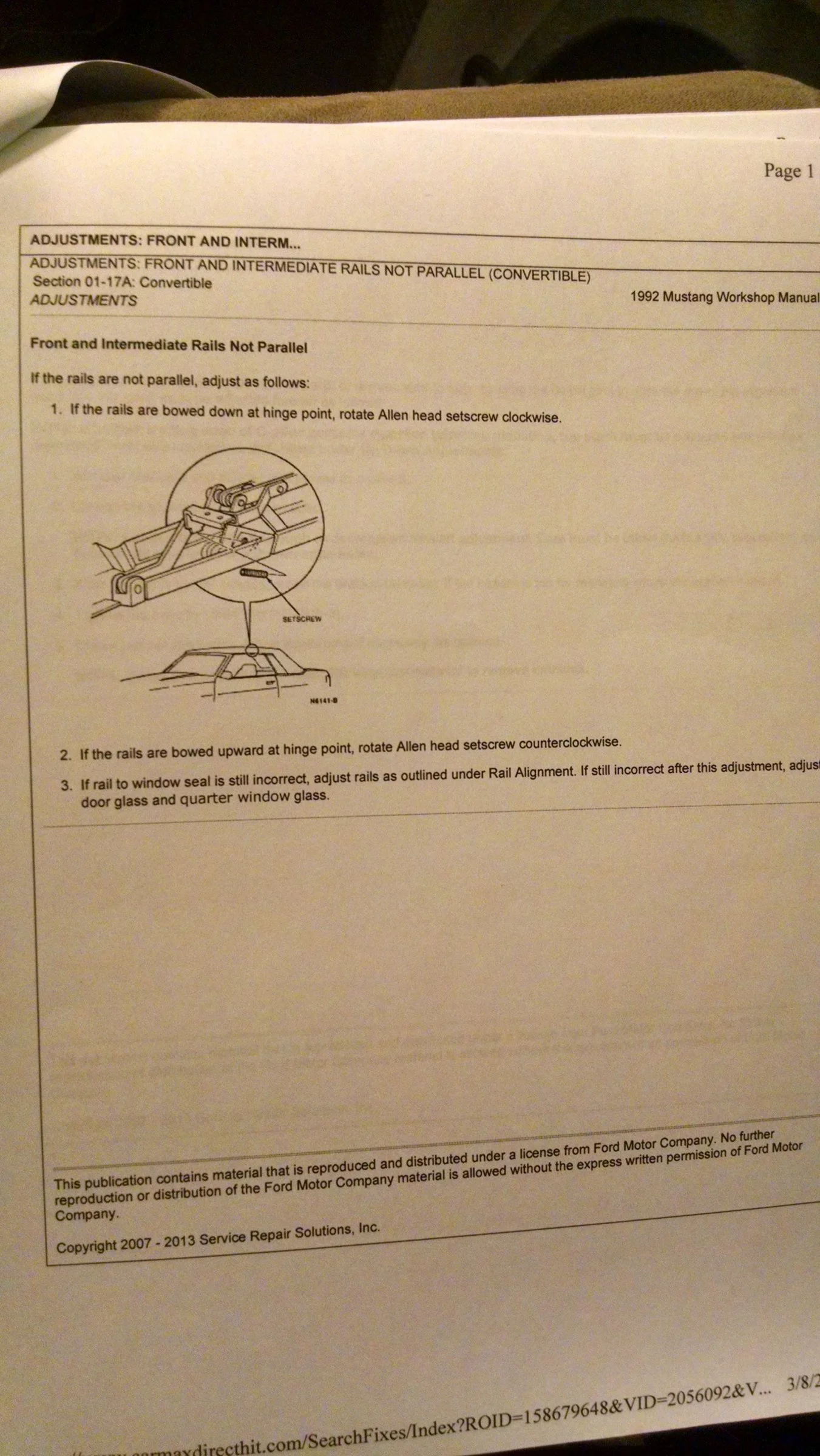

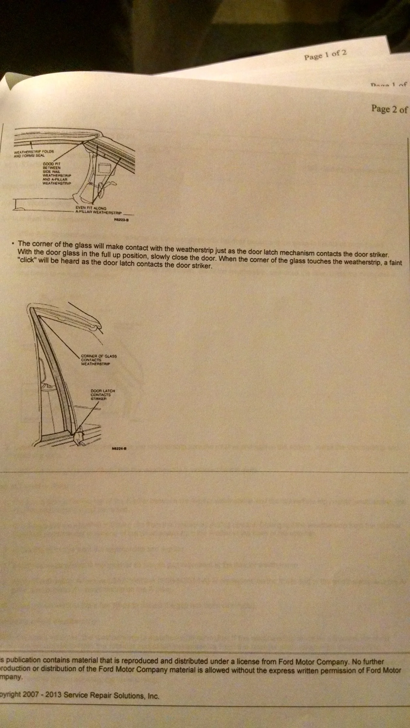

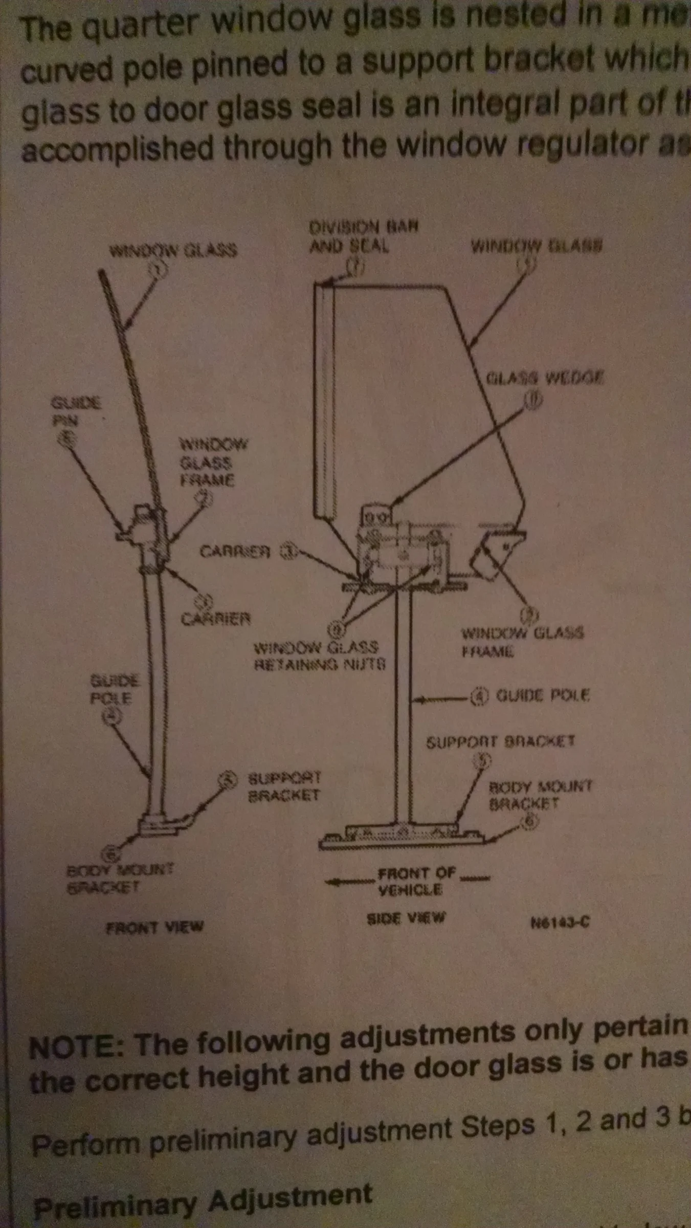

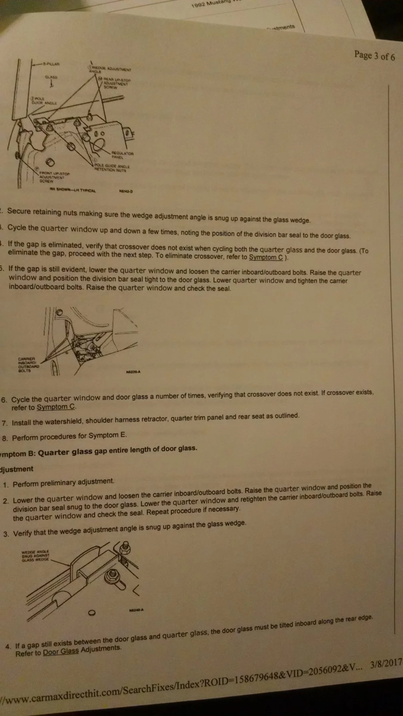

I'm going to try and give you some info. I wish I could scan all 25 pages but my scanner is down.
This is the window assembly. The window glass is glued in the retainer.
The bad part is this has to be removed to get the assembly out.
The window motor has to be removed prior to this. You could probably just clean the old crap off the glass, use some glass epoxy, and just stick the glass back down in there.
By the way this is the entire adjustment procedure for the top frame, glass, and weatherstrip. May be easier for me to mail this info to you.

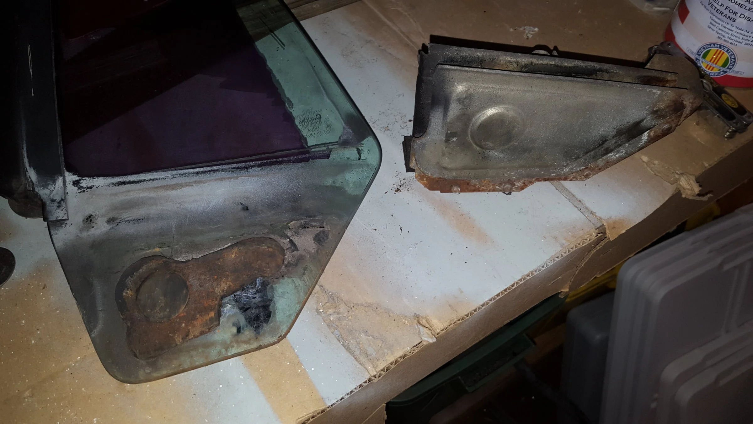

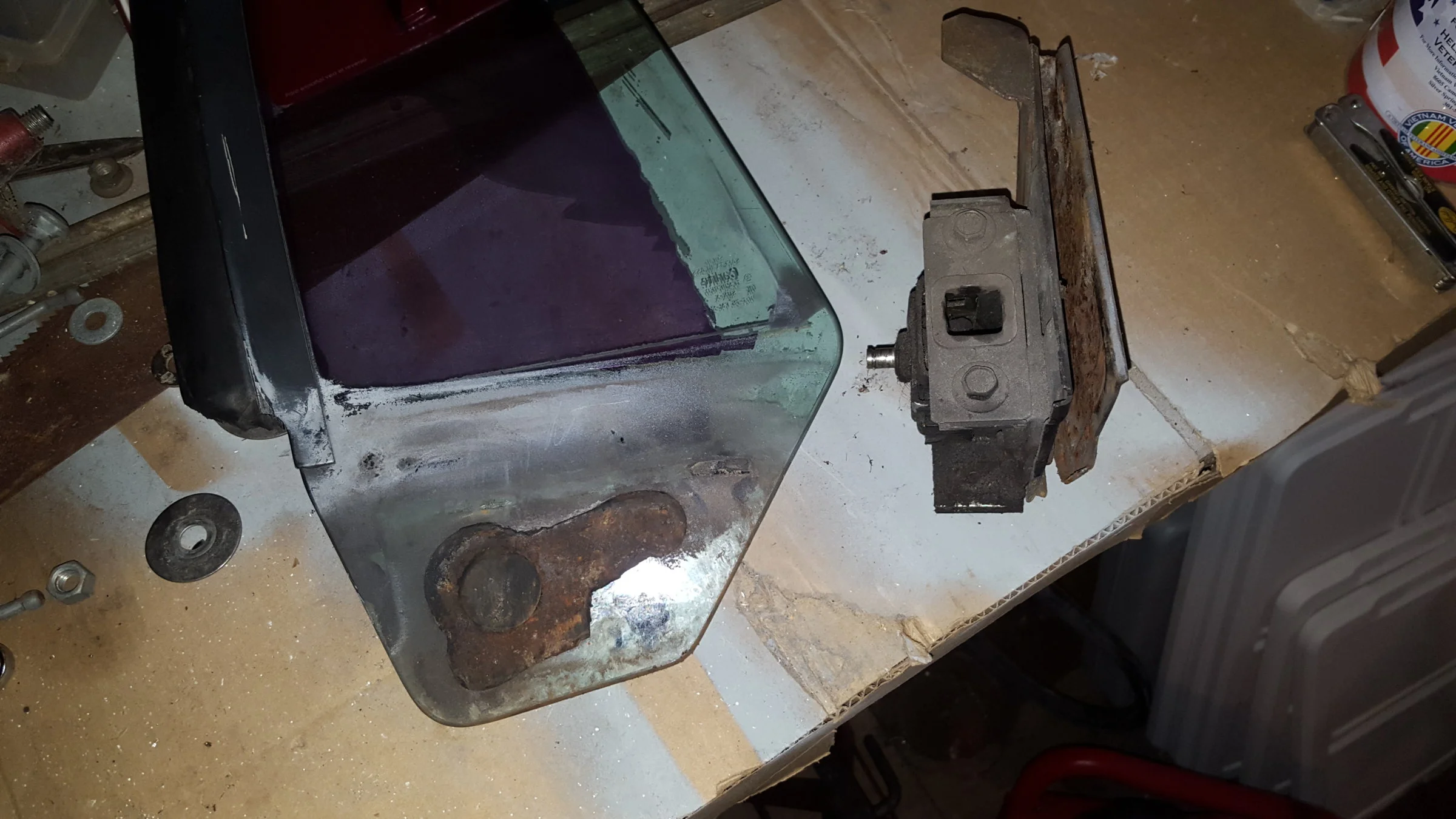

Ok so after alot of cussing I got it apart.
tomorrow I will remove the passenger side as well. Bead blast the glass retainers (notice the rust inside the channel) and glue them back together.

@90sickfox can you get me that adjustment info? Especially the weatherstripping.
Thanks.

That's what I've got...I'll try to get it scanned to a file so we can make a place for this. Seems a lot of people need it.
Reactions: a91what

Holy crap that's alot to soak in.....
Can't find some of the parts I'm missing. I need new adjustment stops and window wedges.....

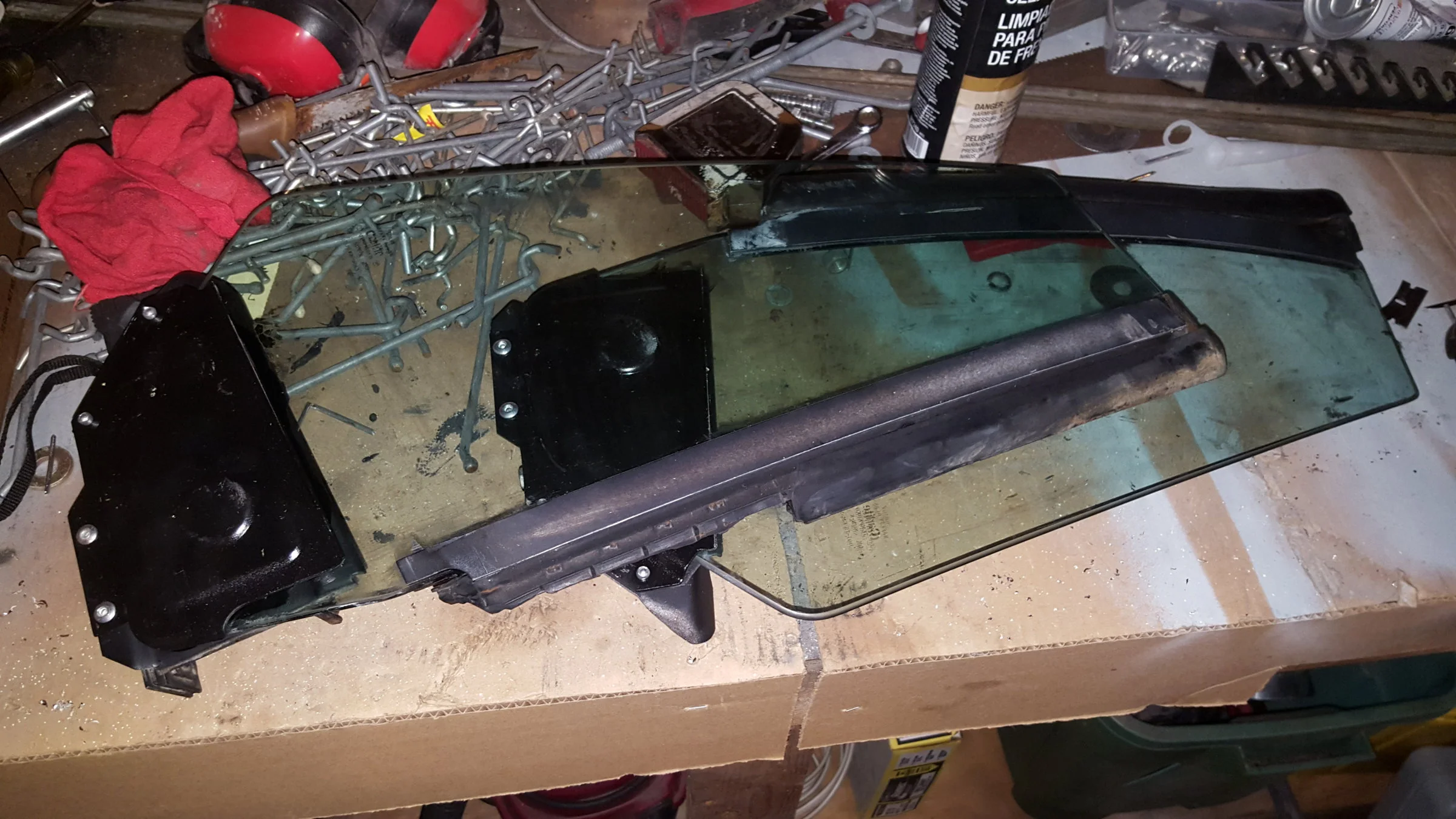

Done gluing.... here is a pic of it together, I have the new weather stripping and will repaint the metal on the glass with trim paint before installing. don't mind the mess, reorganizing the shed.
I had to split the retainer by drilling out the rivets so I could get at the rust. The I primed and painted the pieces before gluing the window back in and popping the rivets.
