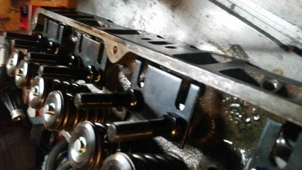

notice how the studs don't bottom out..... it's a good thing I didn't bolt them on the car first....
I'm gonna call him tomorrow guess I should have let them install the studs. I picked them up today...

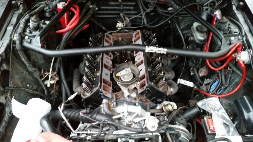

Drum roll please.............. no? OK fine then.
Grab some popcorn pop open a cold one and hold on!
the heads came out great after some profanity and smashing of fingers.
-Fully adjustable drive train. Check
-Correct springs with new valves. Check
-Fiance yelling "stop being cheap just get it done right I don't care what it costs". PRICELESS
Now I just need to sand paper roll the lower to knock off the crap and pressure wash it.
Or get a better intake, I currently have a cobra intake but I would like a single plane with an elbow drilled for injectors.
hmm mm ideas?

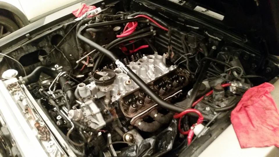

OK progress!
Got the lower bolted into place after a quick cleanup and pressure wash.Guess what I didn't do.......
Check for pushrod length while I had the manifold off.

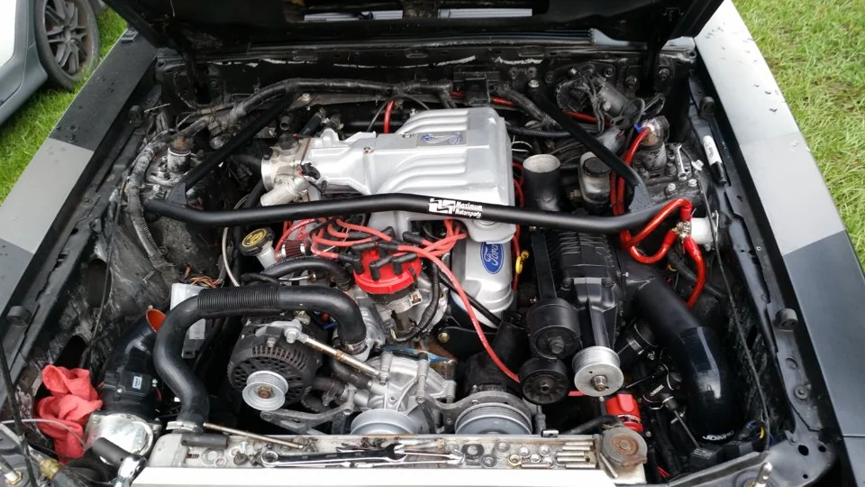

It is all coming together nicely.
Got all vac lines ran and the right size belt.
Need to add/remove some shims here and there with the engine dress to line up right but right now it does not throw the belt.
Fuel lines for fmu leaking, need to take fittings apart and use thread sealer.
IT SOUNDS SICK! even my girl is in love with the whine!!!
Maybe tomorrow (if water isn't falling from the sky) I will button it up and drive it!
Not sure about boost figures, makes about 3 when you nail it in park..... hopefully more with a load on it, say in 3rd gear...
