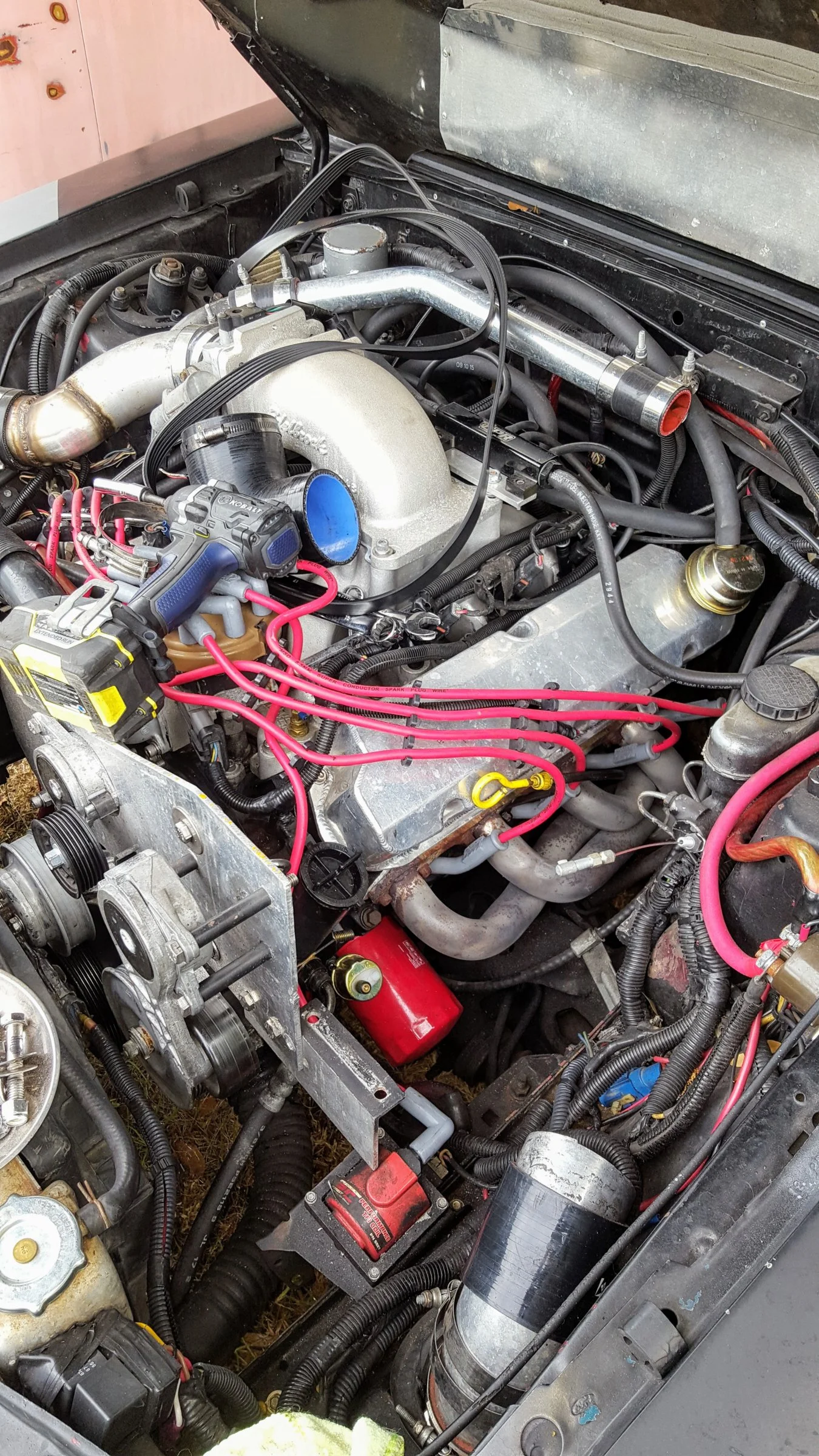

The radiator will come out get thrown away and a new nicer better fitting one will go in. Since I am pulling the radiator out I decided to go ahead and fix the exhaust leaks at the headers. I hate this part as it requires removal of the blower....
what a huge pain in the ass that is, requires loosening the power steering pump bracket bolts, and removing the experiment that is the bracket assembly.
When complete it looks like this.
damn that's some homemade look in :poo: there huh? Wish I had a garage full of tools, ne,t time I do something this involved I want the right tools and equipment.

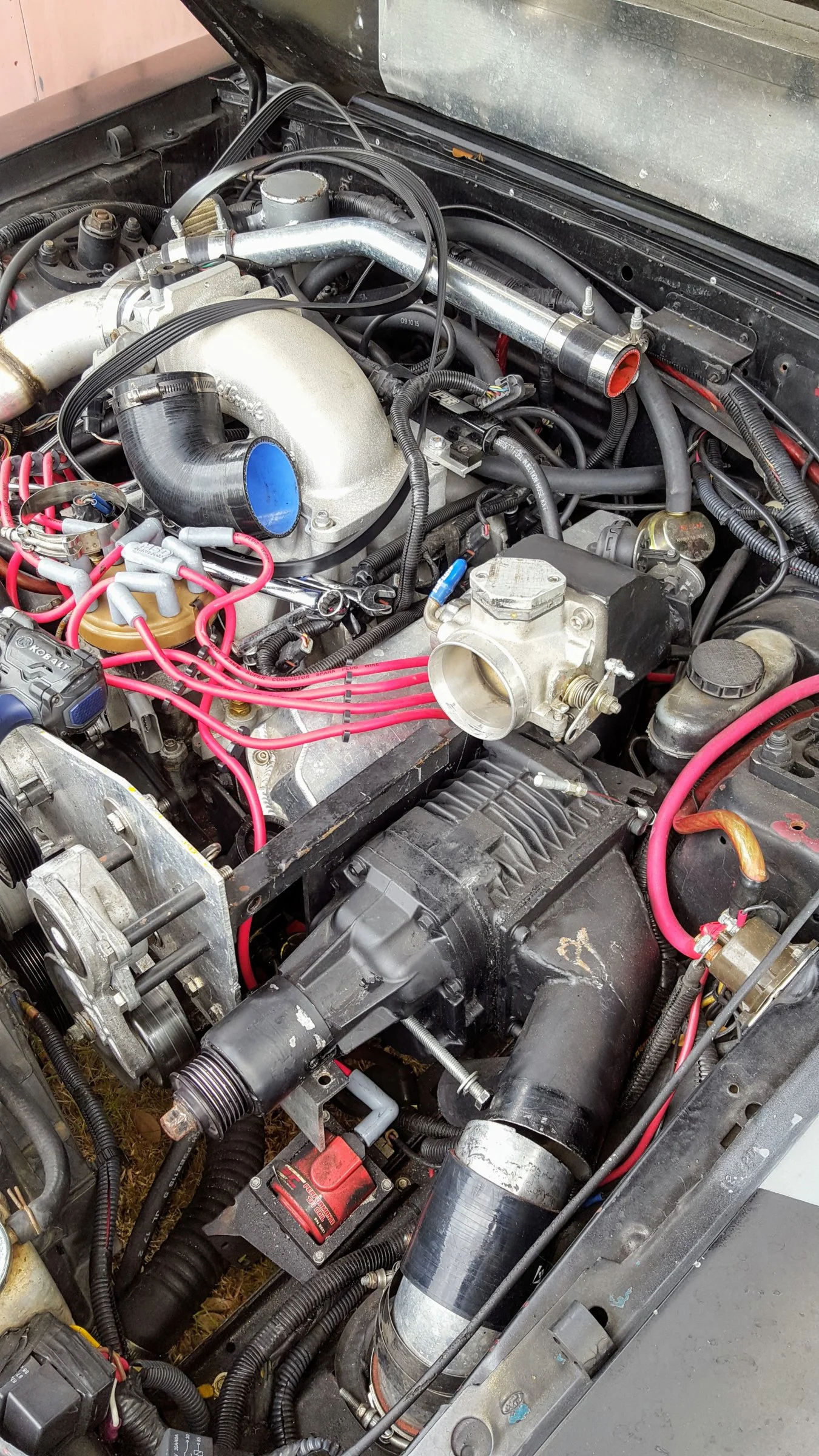

With the blower out I started the car to listen for exhaust leaks, the blower is overspun so much it makes a whirring noise all the time. There it was an as day, tick tick tick tick both sides. Then I here something different, clack clack clack.. dafuq? I place my ear to the valve cover with a screwdriver, yup same side as last time. Maybe another broken rocker ARM?..... I had to leave the car before I could find out, had to do husband stuff.
Valve covers come off tomorrow. While I have all of that apart and the plugs are easy to get at, I'm going to do another compression test.
Car is crazy quite with the blower off.... I contemplated using the 90mm tb and a cai and being done with it. Wish I had the monies for a real blower.
Why cant you figure out a way to top mount that thing? You have a capable EDIS ignition solution so that you can eliminate the distributor.....It seems like you'd be able to have that manifold milled down and a plate welded/bonded on as a mount for the blower..
* edit...Wait, It's not like a typical roots blower is it? It doesn't have a discharge on the bottom like a typical GMC blower, so you cannot cover up the intake manifold with that thing....Hmmmmmm...
I know I have spoken against it, but maybe a GT 45 turbo? You'd be able to get rid of all of the weight of that thing, and pretty much use everything else to get the job done all while being able to see the driver side spark plugs again.
I considered a turbo Mike I really did. The whole reason I did it this way from the beginning was because of the gt40 intake I was using and for the intercooling. But the seriesed throttle bodies are a huge pain in the ass.
It could be done but I want to drive it not redesign it.
I would need a gm style blower to mount it up top and be able to work on it. Unless I got real creative with it. I could turn it on it's side up by the valve cover and try it that way but may get the same result.
