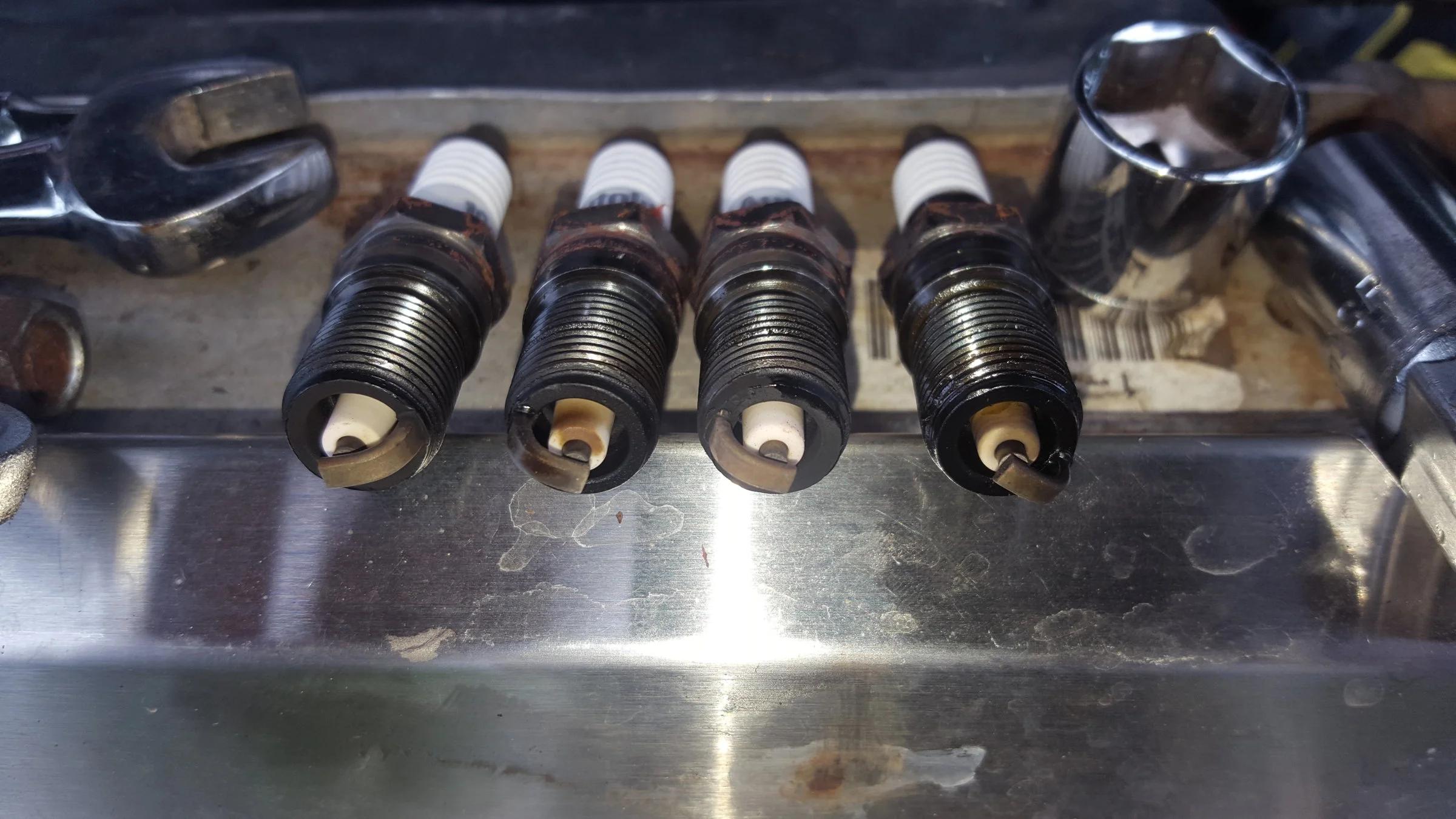

Spark plugs and compression by cylinder.
5- 138
6- 125
7- 130
8- 128
Test was done dry with engine cold. Similar to what the passenger side showed 6months ago.
Spark plugs left to right 5 to 8
no signs of coolant burn on any of them, 6 and 8 look like they are burning oil. I had a leak on the valve cover bad enough to soak the header (never put something together and go inside for a drink) the threads on #8 are wet from a seeping valve cover I fixed yesterday. I can't explain #6 except when they drilled for the rocker studs they broke into the runner maybe the oil is seeping past the threads? Either way the car never smokes even on startup.

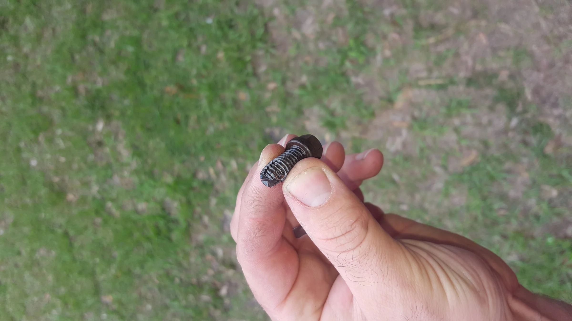

I fixed the stripped header bolt issue with a little ingenuity, made a header bolt cut it's own threads. you may have to zoom in but u cut a cross in the tip and bent the tips inward removing one. Worked perfectly.
