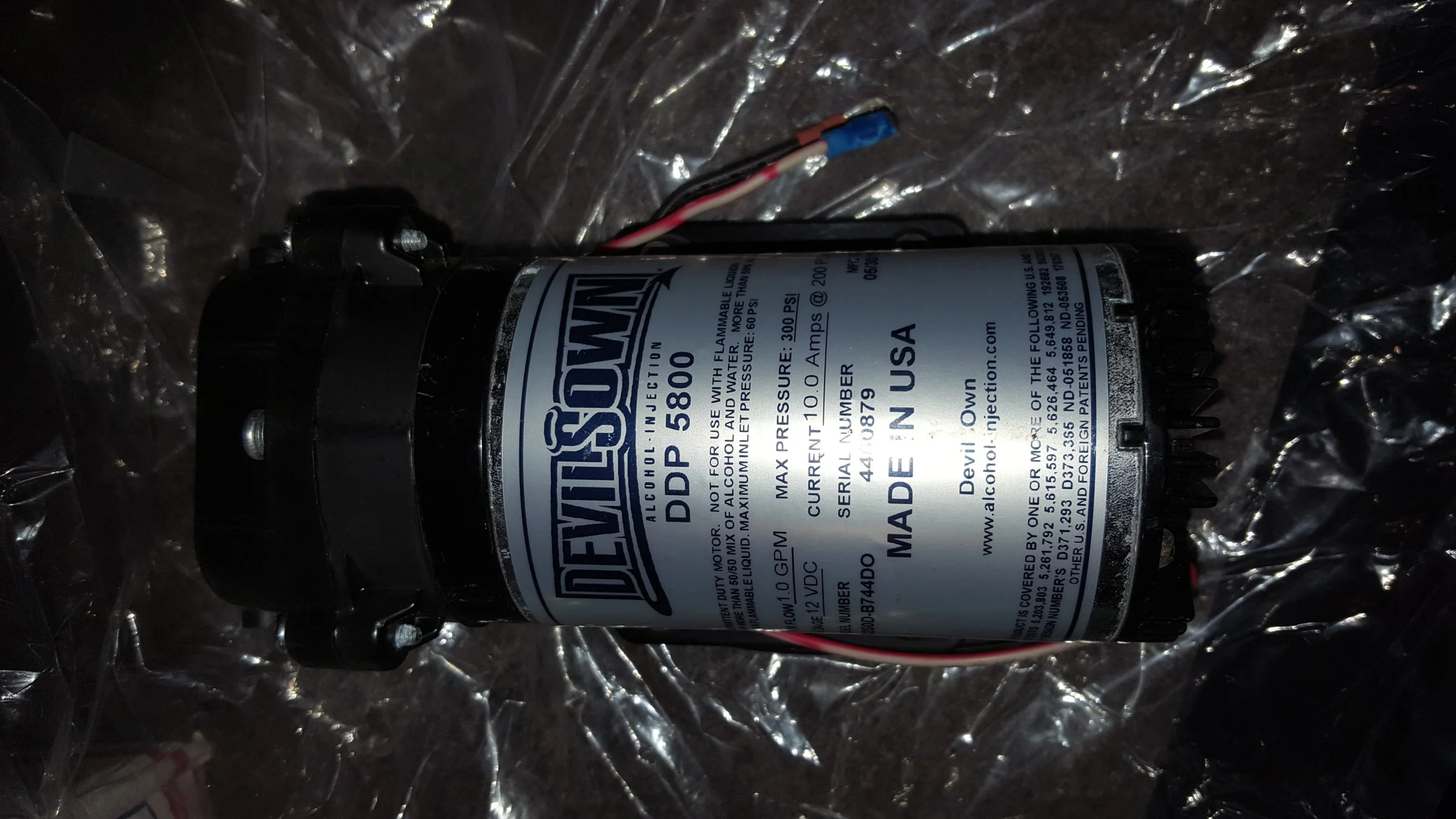

So wait,.....you're only injecting water then? Why not add the octane benefit to be gained from the meth mixture?Negative. I am going to tie the system in with my megasquirt. This way i can trigger it with boost, temp, tps or combination of these. I will also be able to trigger table switching if I decide to use a meth mixture so as not to disturb my water only tune.
