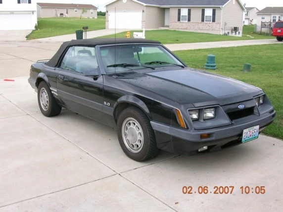

Joe you certainly have some nice rides. Here is one of my 86
