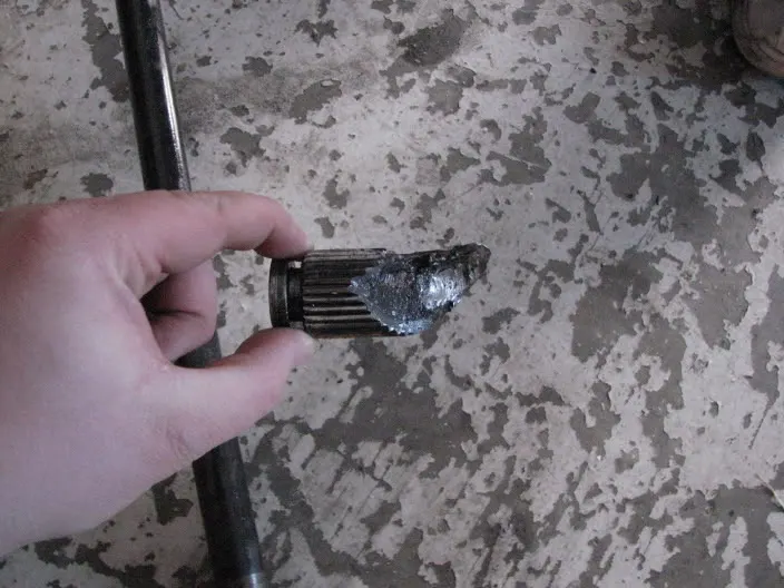

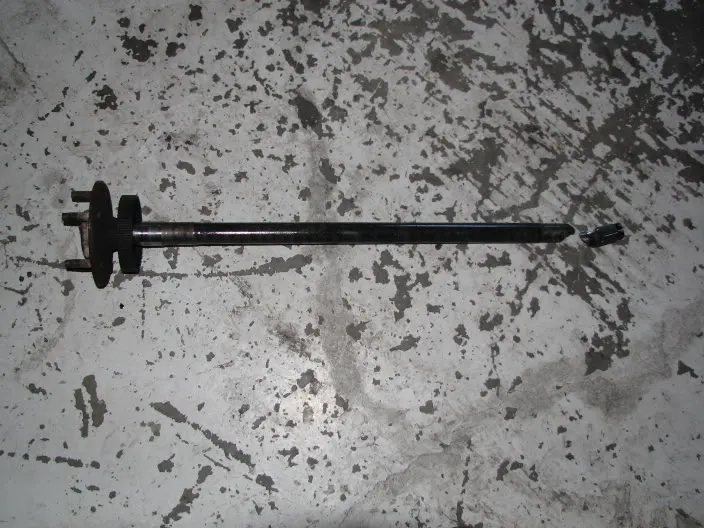

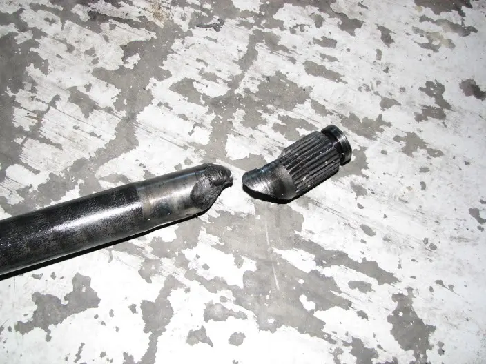

But of course all good things must come to an end. My next pass I was heating up my tires before I stage and as I was doing a burn out, my RPM's started to fall at a consistent smooth rate (as if I had too much brake & not enough gas) and the car stalled. not sure what happened I just thought the car was being retarted, I start it back up, put it in second gear, give it gas, and dropped the clutch like it was going out style, and than BANG!
...The result
Yup snapped an axel and it took a LOT of force to get that little piece out of my Eaton LSD which in the end couldnt be saved. We figured when my car stalled the first time my axel was seized inside the LSD and then I finished it by trying to do a burnout again. But I don't care it could of been something much more serious. But best of all I DIPPED IN TO THE 12's

Not too common... the 8.8 is a very stout axle, and the stock 28 spine shafts will take some heavy abuse, but if you push too hard you will break something.
Starting a burnout in second gear allows the tires to spin faster and will get them hotter, quicker... this is when running a drag radial or slick, not needed on a street tire...
Keep that thing in your garage, or wherever man... its a trophy, lol. You really mangled that thing good.

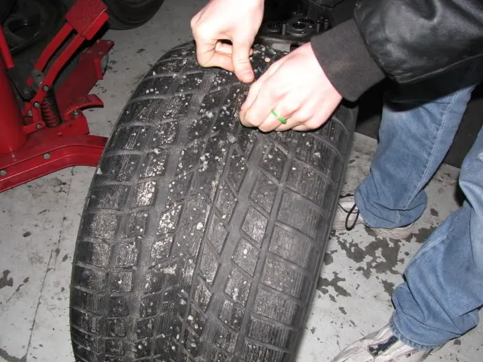

I was running the cheapest 315's I could find some Sumitomo HTR Z
They actually stuck well.
