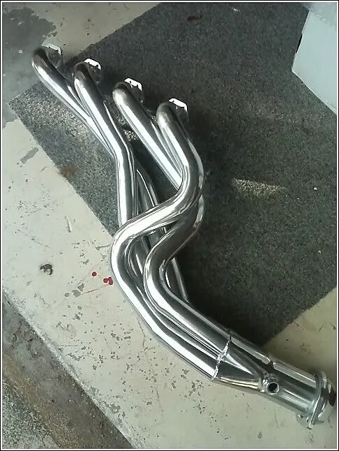

1.75 inch ceramic headers with 3 inch collector

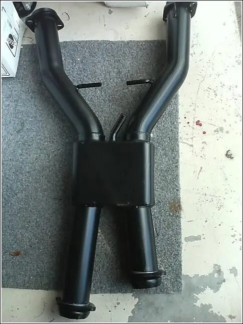

3 inch prochamber

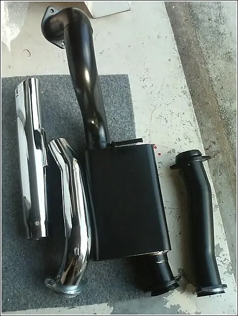

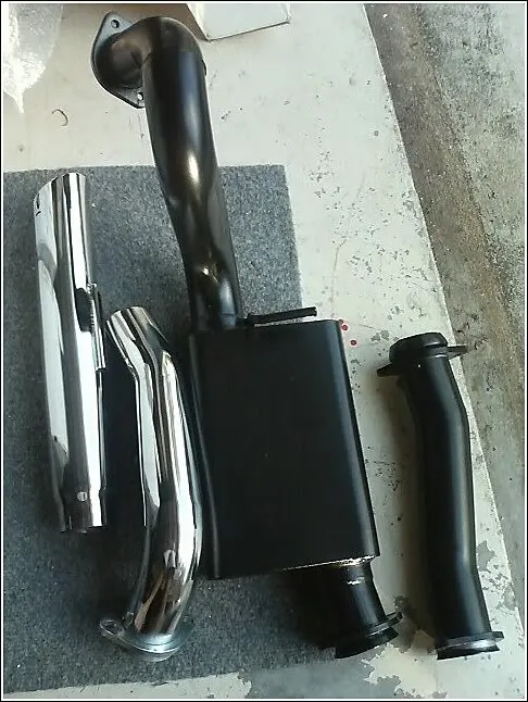

3 inch cat back
They made a mistake with the tailpipes and sent me 3.5 inch ones. They are swapping them out for 3 inch.
The cat back is a new design. It comes in several peices so it can be adjusted alot. The previous version was basically what you get is what you get, not much adjustability.

Maybe I should have written a disclaimer for those who have 3.5 inch tips. If you like them then that's all that matters. Hopefully MAC will come through with 3 inch tips for me. If not I'll be in the 3.5 boat in which I won't be pleased. May just leave them off and have dumps.

Good choice Joe. I have the 3.5" crap and I hate it - looks like cannons.
Joe
Does it really look that bad? :shrug:
I just ordered the MAC all stainless cat-back with the 3.5" tips, and a proc-chamber for long tubes. I didn't order the long tubes from MAC because I have always had trouble with individual flange shorties leaking. I'll be ordering a set from BBK. It appears there aren't too many companies still making long tubes for 94-95's.
It actually does look that bad. They are enormous in my opinion. Since the diameter is 3.5 inches the tailpipes angle down towards the ground. Even if they are all the way up against the rear facia they still angle downward.
I have pretty much the same setup (only HTS coated) but the innermost primary tube on the drivers side runs against to where the clutch cable goes into the SFI bell. It's understandable due to the fact that the fox style bell places the cable and fork higher (around 9 o'clock) than a SN95 bell. I should have gotten longtubes for a fox in my case.
I just picked up a set of ceramic coated BBK's and a DrGas X that I'm gonna switch to. Ceramic coated pipes look awesome, too nice to put on a motor and have hang 4" from the ground
wow joe.....looks like she may start this weekend after all. i think we have everything we need (even though murphy's law gaurantees we will forget something). by the way joe, i think i like the tips. it would look like you have dual potato shooters coming out of the back of the car. kind of menacing in my opinion. :D
