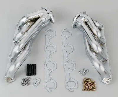

Jul 3, 2007
#11
  • Jul 3, 2007
  • #11
look at the pic. You need the studs that come with this kit....they thread into the header and then the h pipe flange goes on then the nut that comes with this kit....once you see the pic you should understand.

1 stud is missing , driver side header, i'm looking down from top of engine, i see the bottom of like either bolts or studs and then i see the other hole where the stud should be is just empty. no stud/bolt is in there?
it also doesnt really look like the stud/bolt would thread into anything. it looks as if there is a flange with a hole on each side (header and the h-pipe) and the holes match up and their should be a nut and a bolt.
I'm not really sure thats why i'm asking. i only know what i see but i can't see that great in there.
When i go buy the studs at the local hardware store, what size do i need and such?

maby someone has drilled the hole out and replaced it with a bolt..or they threaded a bolt down through the hole...maby try and take that out and see what has beed done.

if you go to a NAPA or something like that just ask for a header to h-pipe stud kit....or see if they sell them each. you could just do what has already been done (by the sound of it) and replace the bolt that someone has put in there....and it seems as if yours rusted and broke

jACKED UP THE Car,
use bolt,washer, lock washer and then nut.
seems to be great.
