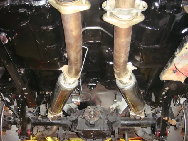

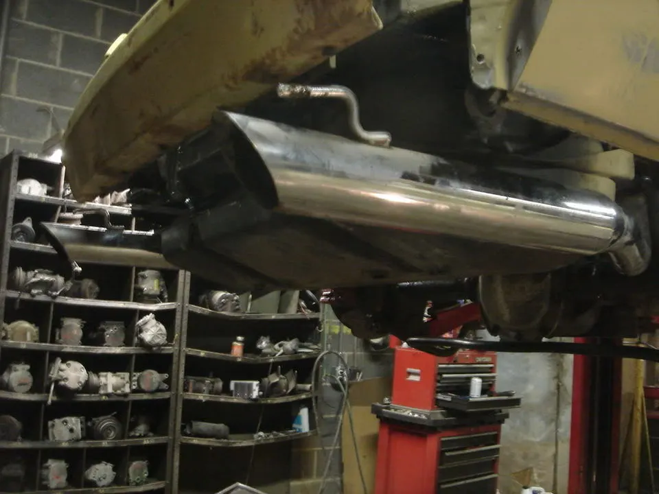

My newest setup...

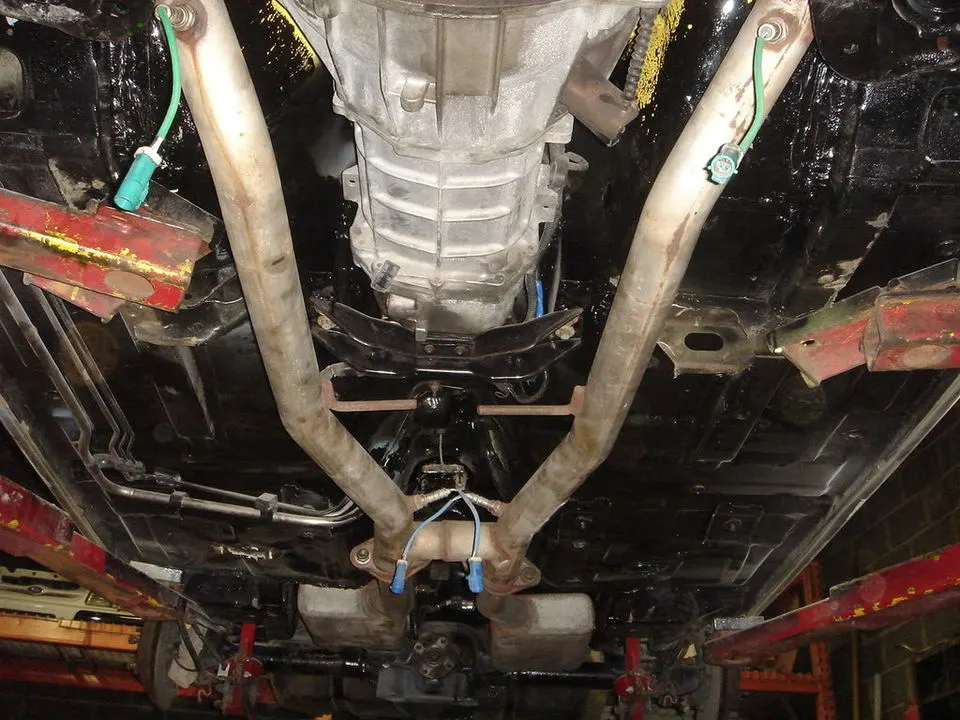

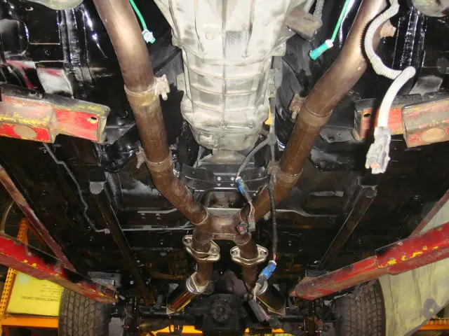

Band clamps here....if you wanna put in cats.
These rear areas are u clamps but I got them apart once already, so I figure I'm good if there is a "next-time".

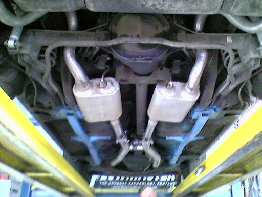

Set up on Hack Job...
This was a MAC tru fit. All bolt together, no clamps, no welding. Best catback.
It was off of a 2001, and I put it on a notch, so I had to cut the tail pipes and I used the bumper rebar hangers from 98-04 Mustangs.
