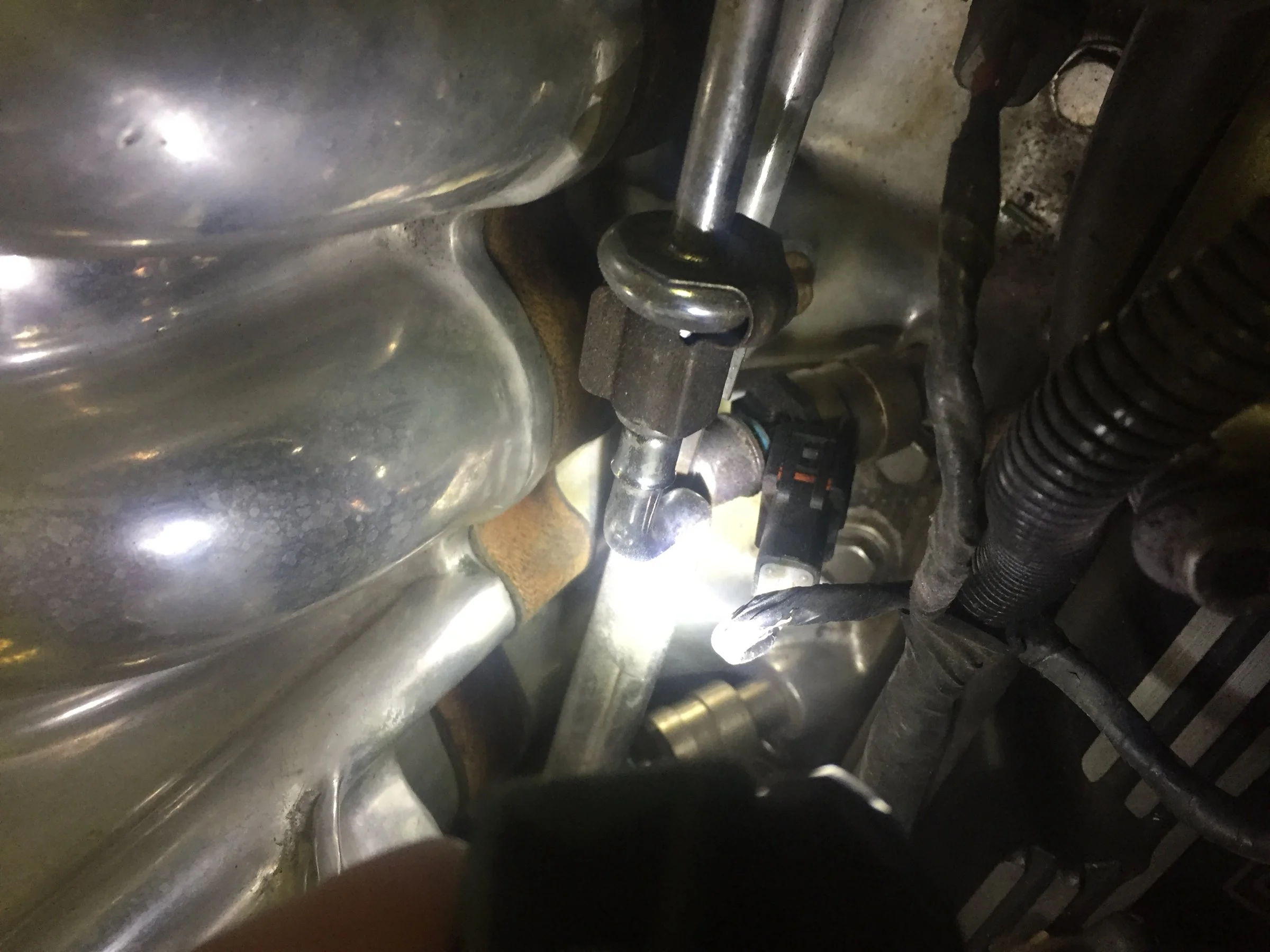

May have found a charcoal canister locally , where on the car is the semi hard line that goes to the tank? Maybe a pic?
Found it! Great help.
I don't have a pic but it will enter the engine compartment on the passenger side along the framrail and past the shock tower, meet up with the canister at the radiator support.
You may have to look under the car where the frame rail and the toe board (footwell) come together
Should be a hard plastic line I think.

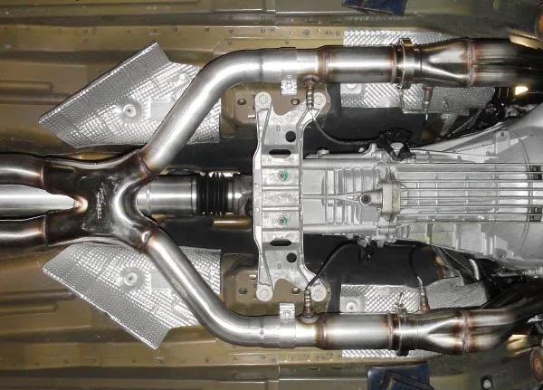

@madmike1157 I'm sure the Cat will get very hot, but doubt it will be hotter than the turbo! You could look for some heat shielding like they put between the floor and cats on the newer mustangs and use that?
like this.
like this.
I've decided to steal the method that motor cycles use on their exhaust pipes, and make a heat shield that is attached to the exhaust tubing itself w/ small stand-offs.

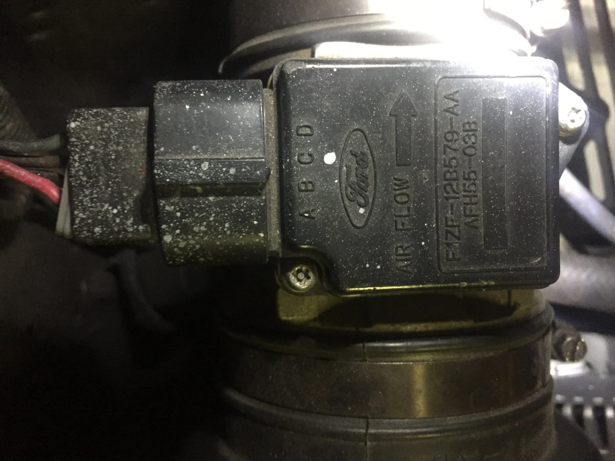

What would the better move be if these are not fancy stock ones, get a maf that matches or get some stocks? I know I gotta pull one to confirm what they are.
But stock heads, cobra intake, b cam, probably don't need 24's
