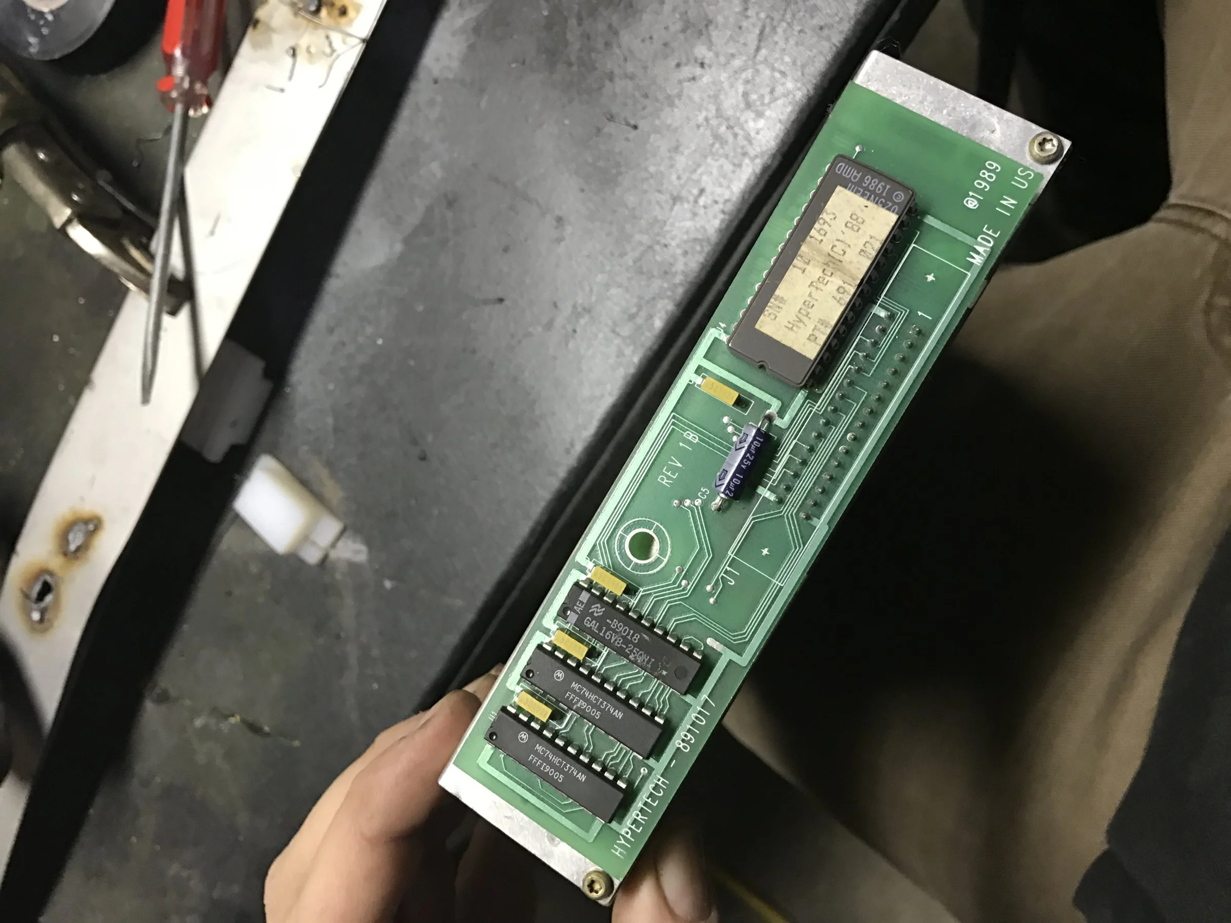

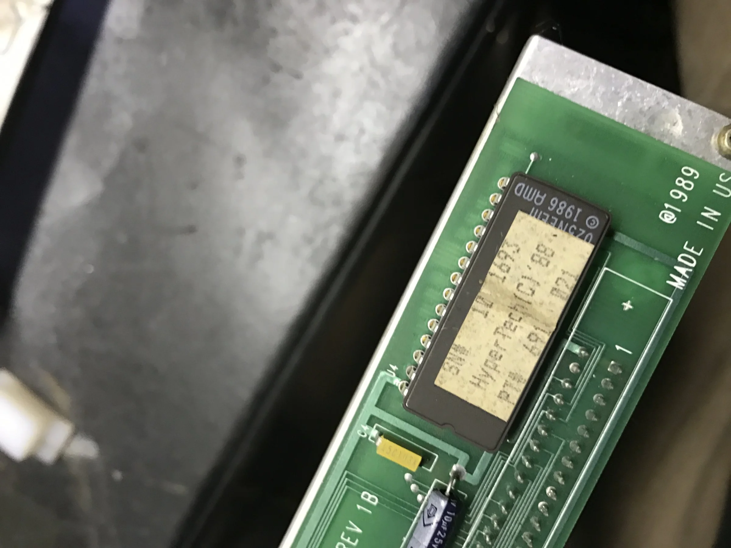

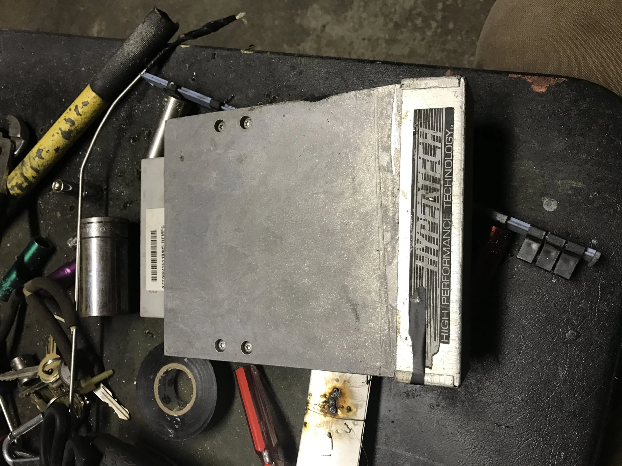

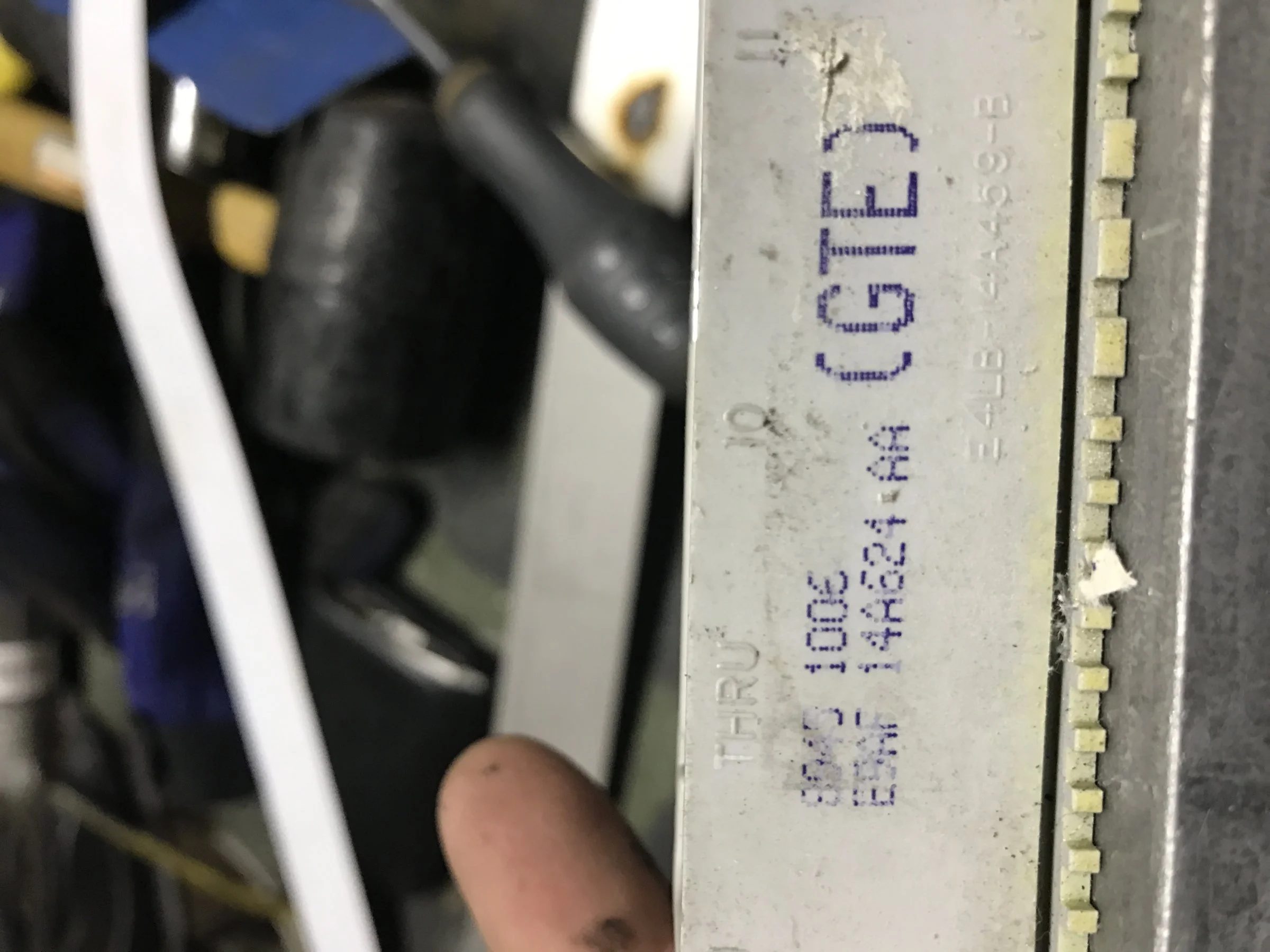

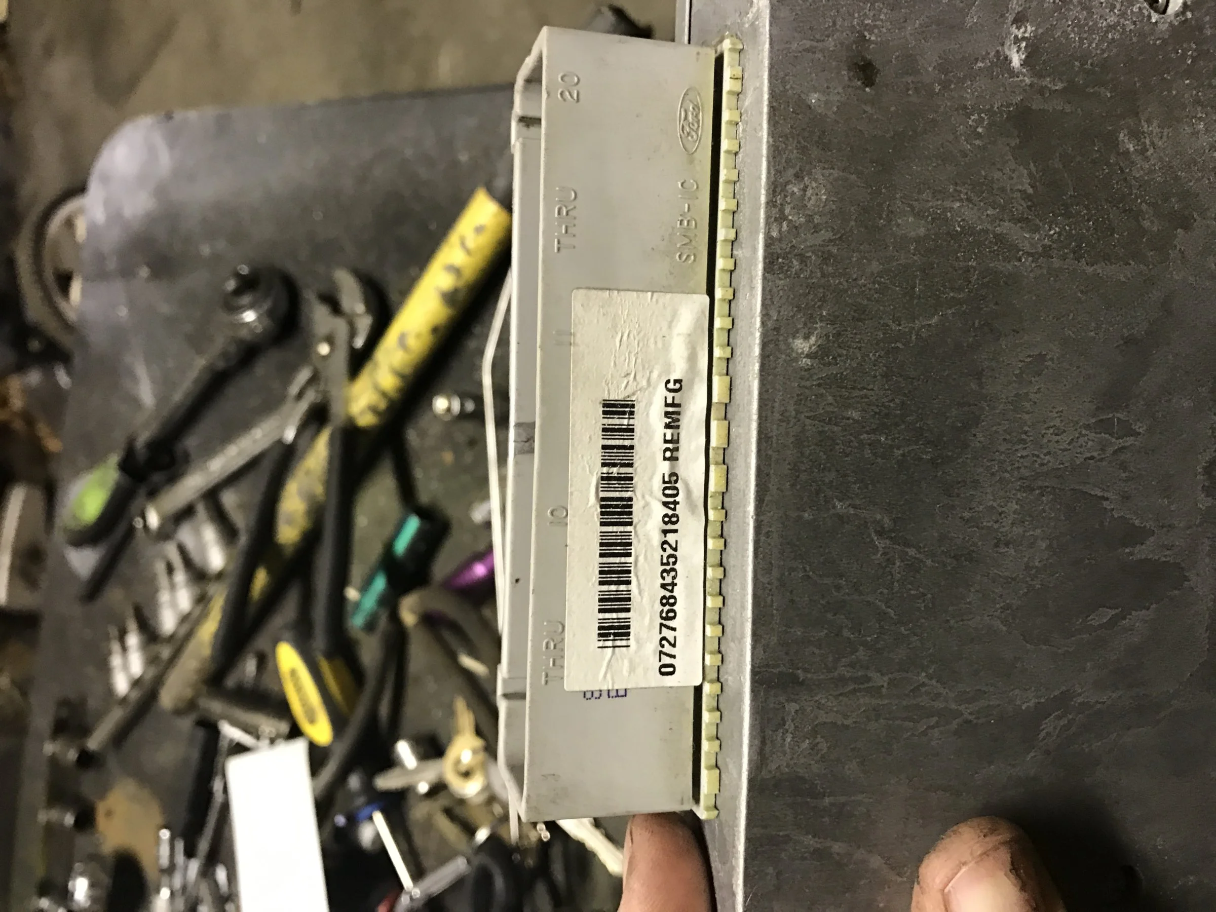

Went to check for power to pin 1.
Found this. Please advice.
