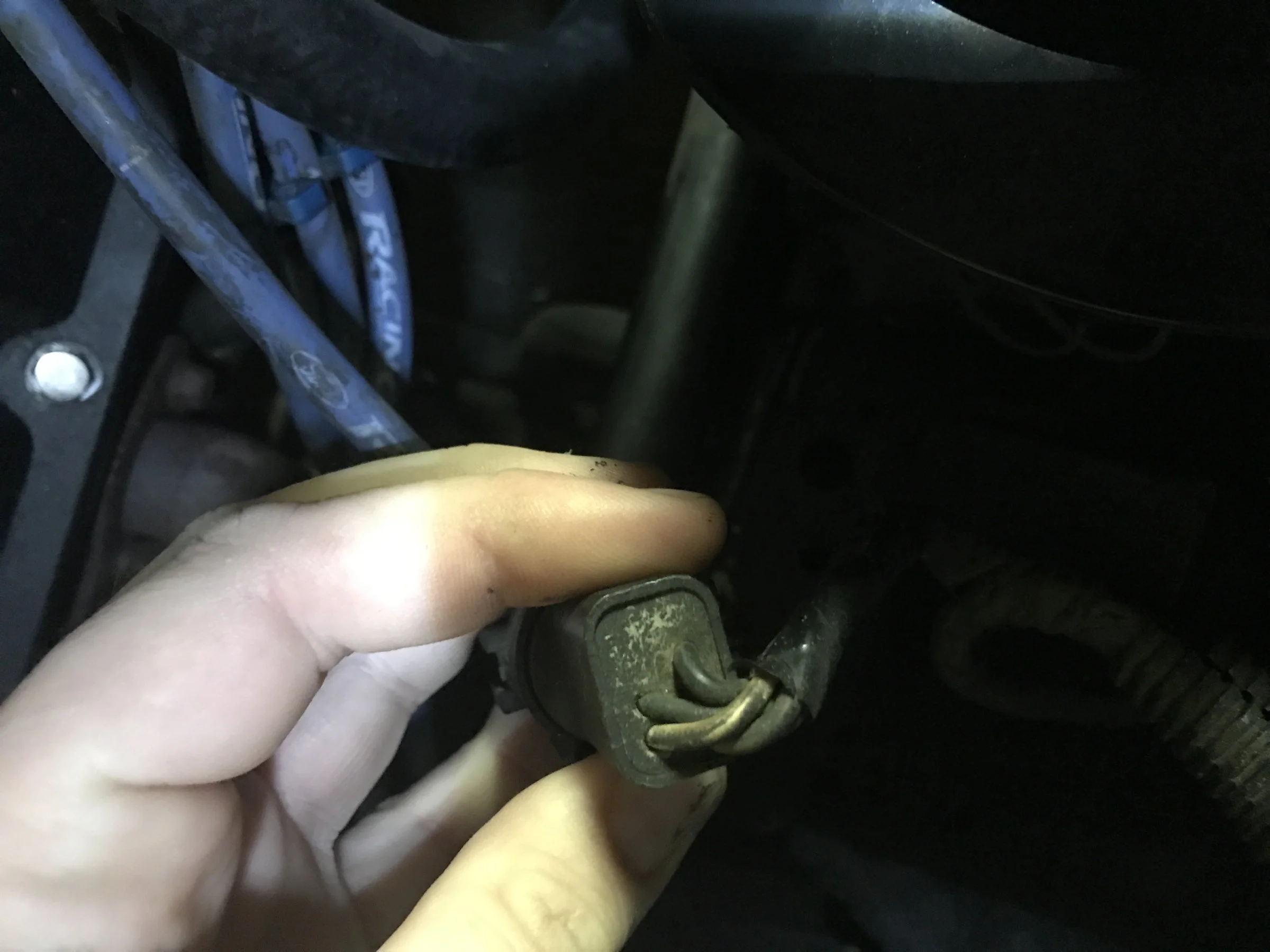

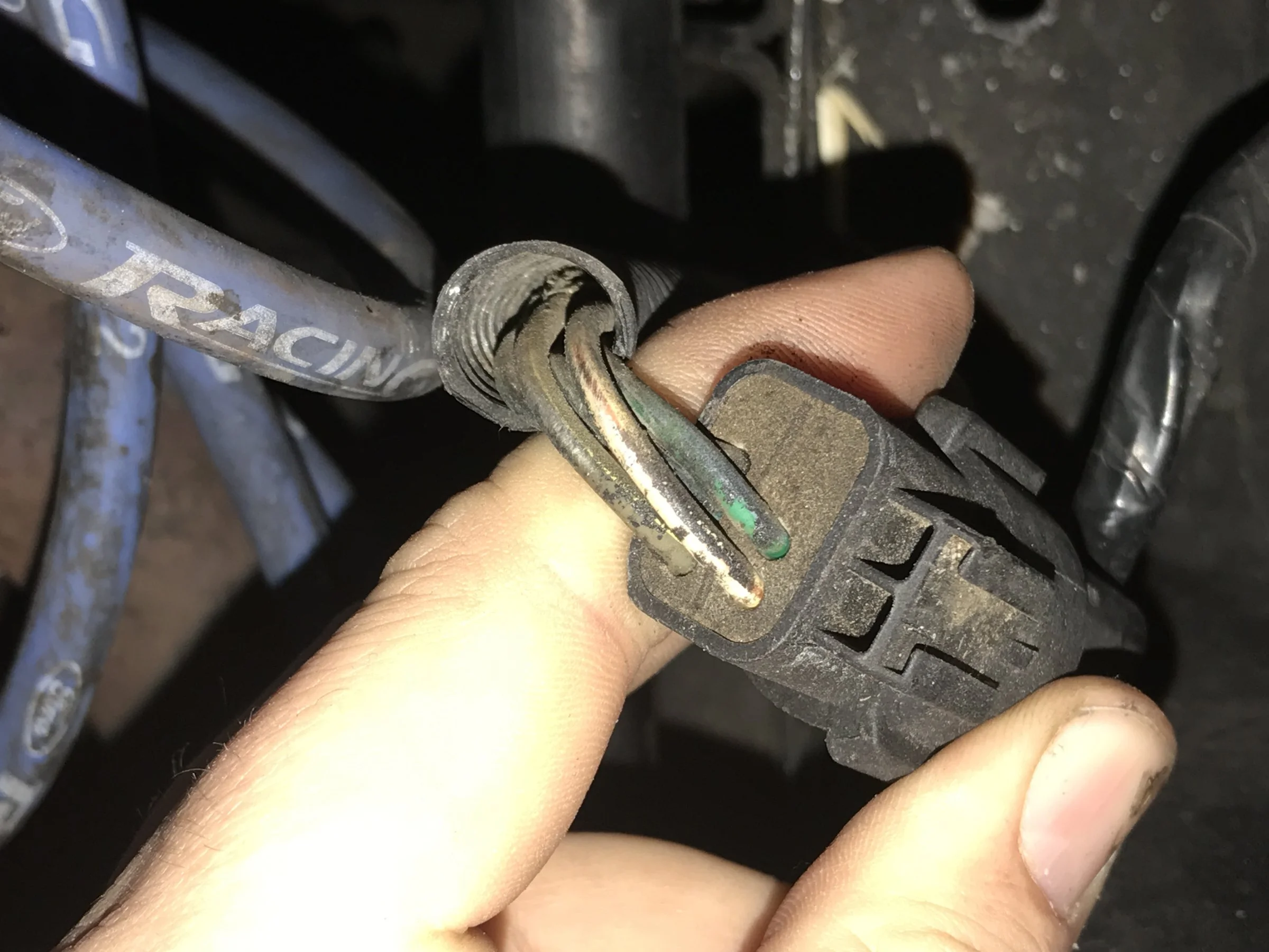

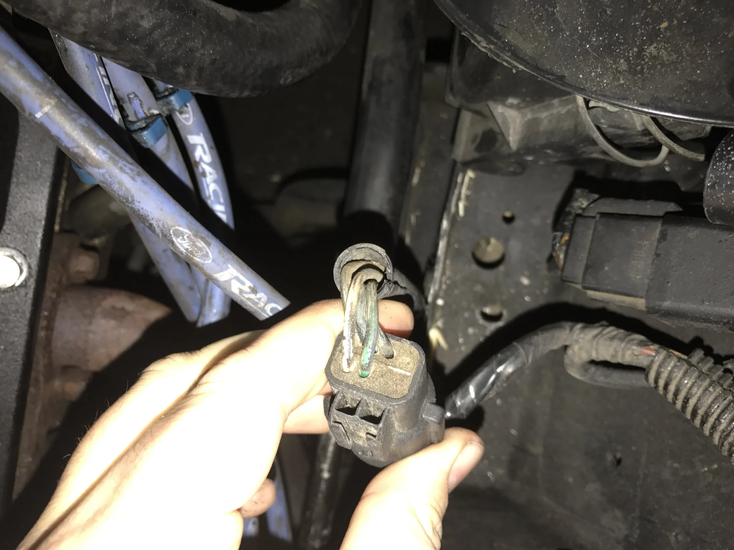

Any clue what o2 sensor harness this is? Was looking for the loop figured that would tell me what computer it was..
Didn't know if it was different cuz of the long tubes. I know they have the extended harness.

5 wire o2 harness.
At this point my concern is that my o2 sensors are not working from needing a different o2 harness, but my concern is if I get the wrong harness I fry my ecm.
That jumper has nothing to do with the o2 harness. On the later cars, it's how ford wired the nuetral start circuits. They just placed the jumper in the o2 harness but it has nothing to do with the actual o2 sensors.
1987s are wired differently, so no jumper needed unless you change out the engine harness to a later 1988+ harness

So I don't need to change my harness or I do? I'm reading conflicting info. I wanna make sure my o2's are working properly
If the wiring was fubar, you'd have a code for every sensor that uses the pin 46 sigrtn
