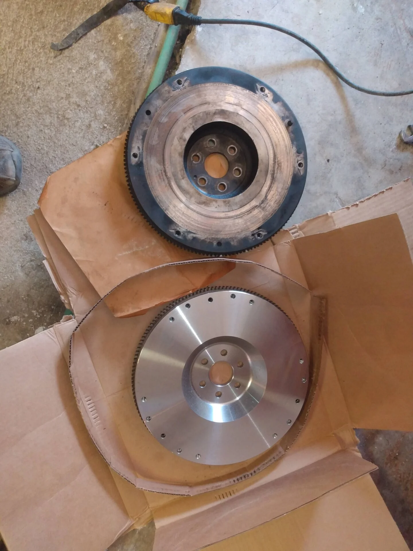

I know we cannot find new flywheels. I am afraid to go to far from home with it damaged. Since I want to eventually do the Power Tour I started to search for a used one. Look what I found. Modern Driveline now has NEW "lightened" flywheels for stock II's !!!!!!!!!!!! They come in both 28 and 50oz. New!!!!! I am betting someone over there has a II.

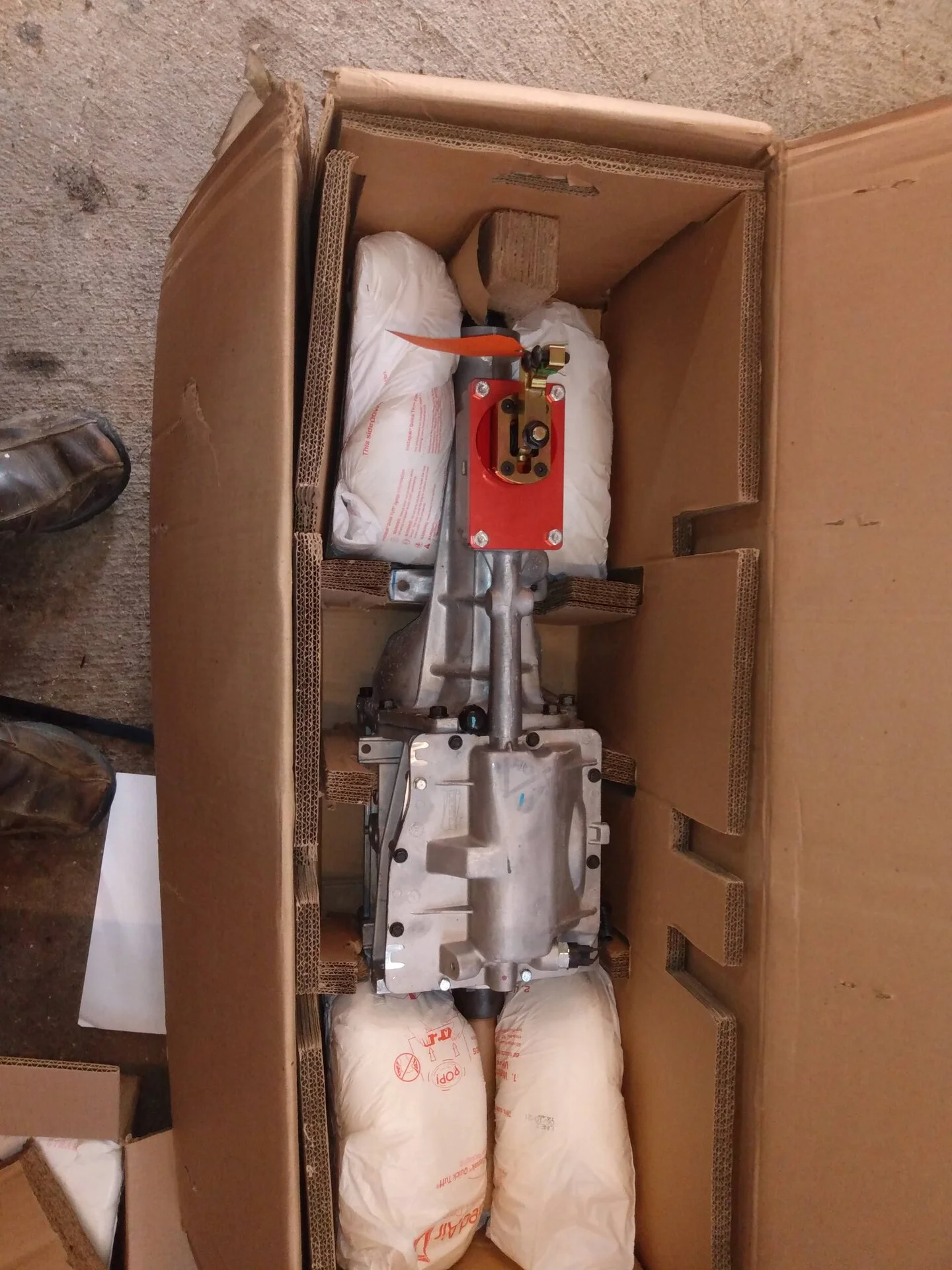

Have most of what I need to replace the T5! Modern Driveline sent me a new T5 including flywheel and clutch. New setup uses shoulder bolts vs the guide pins for clutch alignment. Otherwise the setup appears stock. I am using the sn95 input shaft and a proper pilot bushing now. They machined the steel bearing retainer to fit the rad4 bell.

Getting the old trans out and the new flywheel, bell and headers installed has me laid up again the past two days. Hoping Monday I can get back under there. A lift would be so nice.

FYI I had trouble getting trans to seat the last 3/4 inch. Pulled it apart to recheck everything and found the pilot bushing very tight. I had a rad4 laying around and pulled it's input shaft to use as a test fit. Had to smack it a couple times then pop it out. Did that 3 times and trans went together.

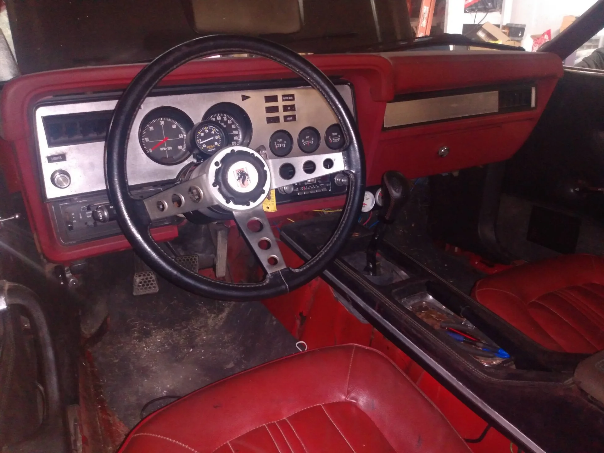

I had Modern Driveline include the Hurst 8" curved shift handle. It is tall. I am guessing a 5" shifter would be appropriate for our cars. They included a shift ball but it's thread is too small for the shifter I have. I reused my old shift knob but its a couple inches tall and makes the shifter feel way too tall.
MD has a II shifter. It places the shifter exactly where it should be using a rad4 bell.
Excuse the interior. It will come around on the wheel of Ka eventually. I wanted her mechanically sound before tackling it. I will have a black dash pad, carpet and seats but undecided on dash itself. I am tempted to snatch a black one from a parts car but wonder how the black/ red combo carried over to the interior works.
Reactions: 2Blue2 and LILCBRA
I retained a stock shifter, but clamped the handle in a bench vise and used a piece of pipe to bend it back some. It gave it a more appropriate reach and the throws aren't a mile long. The other thing I did when I installed my transmission/shifter was that I did away with the rubber isolators and made a couple aluminum inserts for the shift handle. I do have a short throw shifter of some sort with hard stops waiting to be installed, but the stocker works well enough that I've not swapped it out yet.
