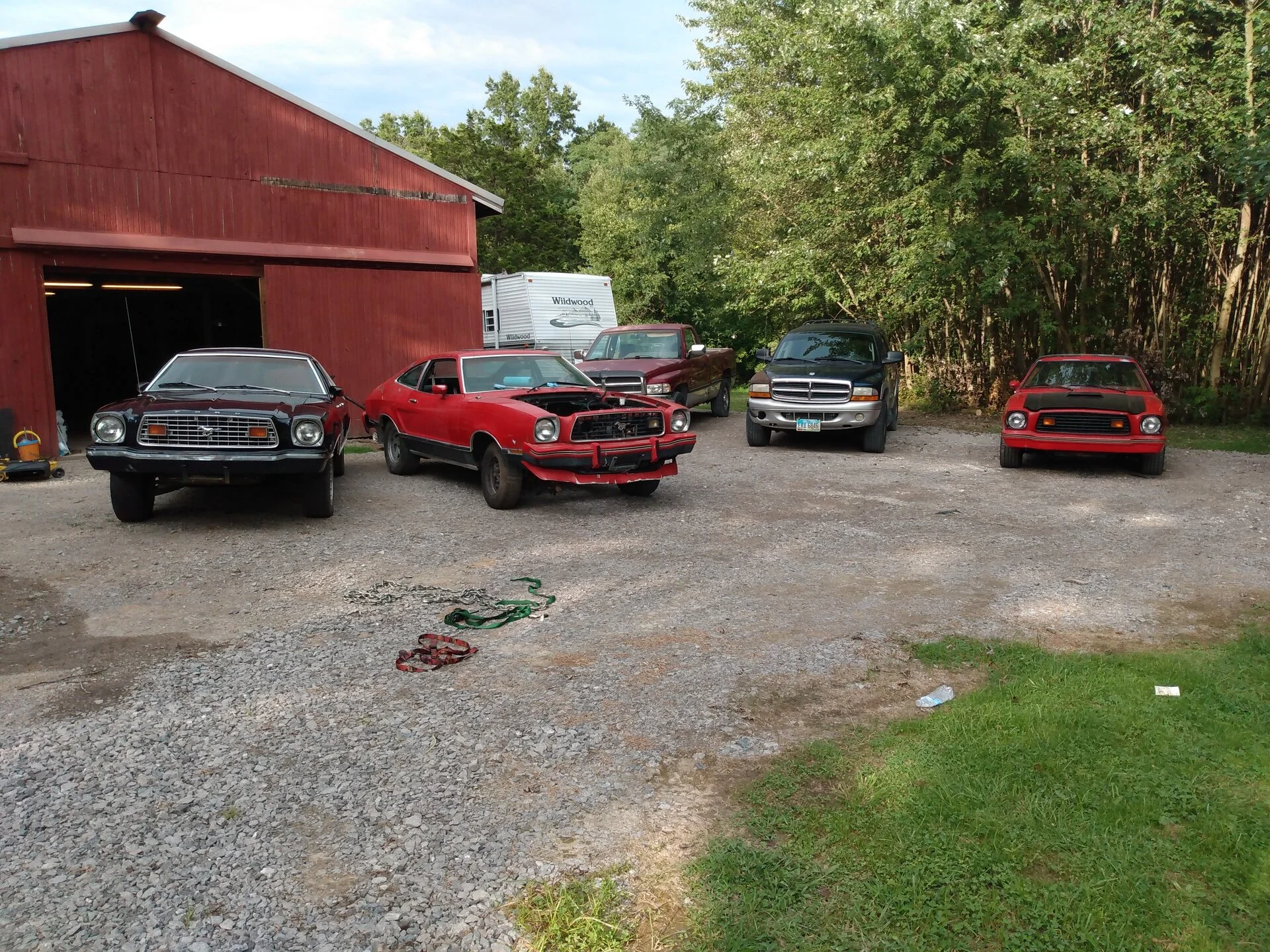

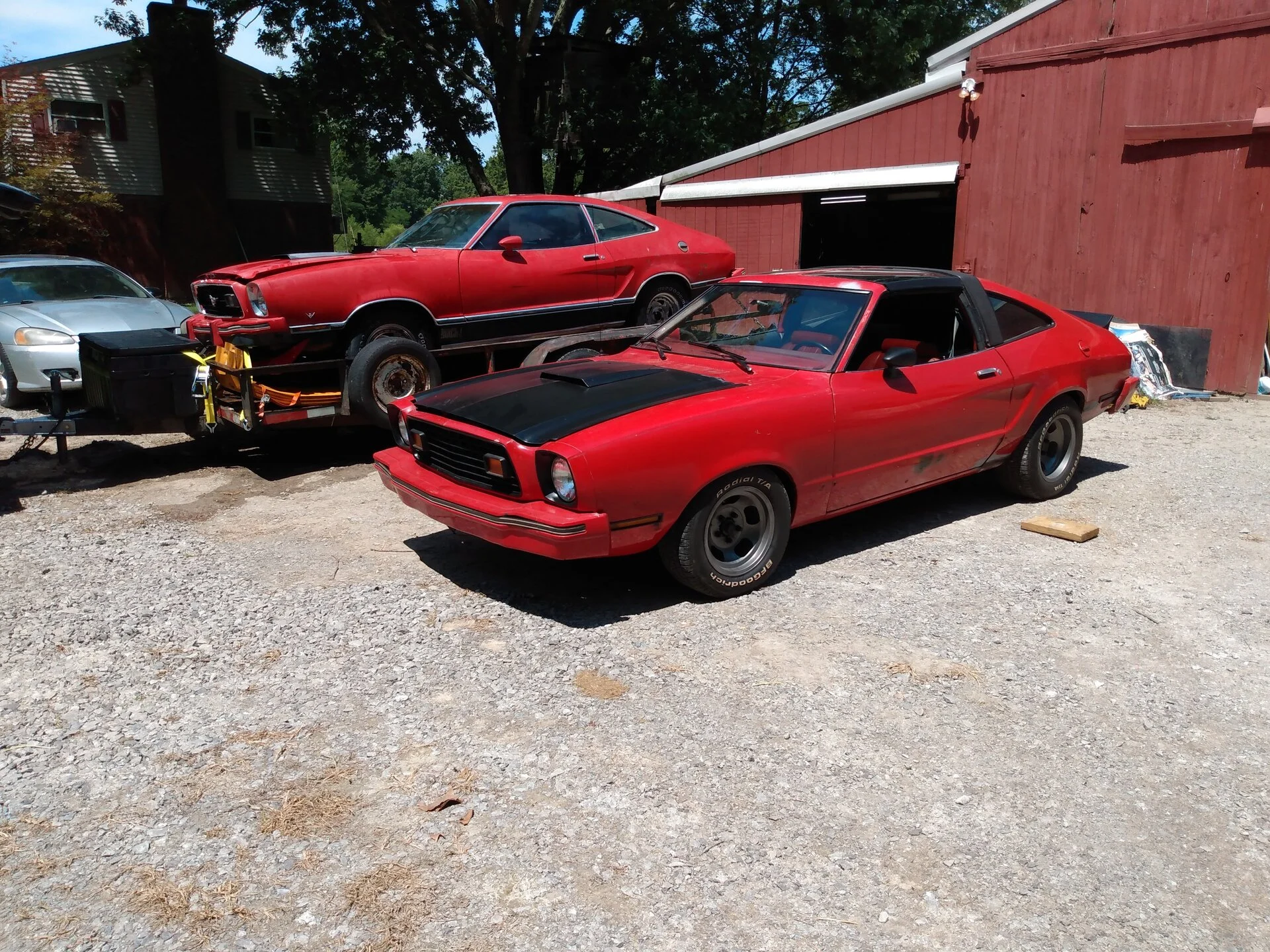

We have been on road trips the past 2 weekends. Two weeks ago it was for the Red Mach I from my other thread. This weekend was in pursuit of "parts out the ass" as the message claimed. I didn't spend what the new t5 will cost between the two weekends. I also hooked another person to the ways of the II's.
The Mach I was abandoned 22 years ago over motor mounts. It jumped railroad tracks or drove into a ditch in it's previous life. The chassis is bent up a little. The pillars are cracked. Yet it is almost a complete car. Only items missing are block plate, fluids, radiator and hoses as well as functioning motor mounts. It also needed a carb and headers so we made another road trip for a good deal on some used parts.

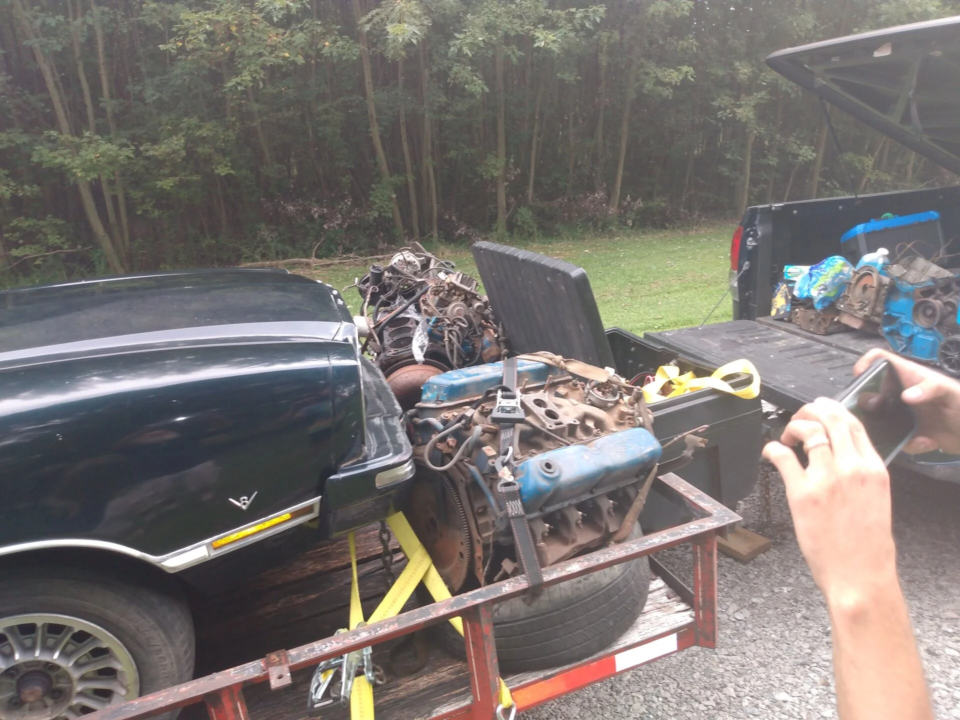

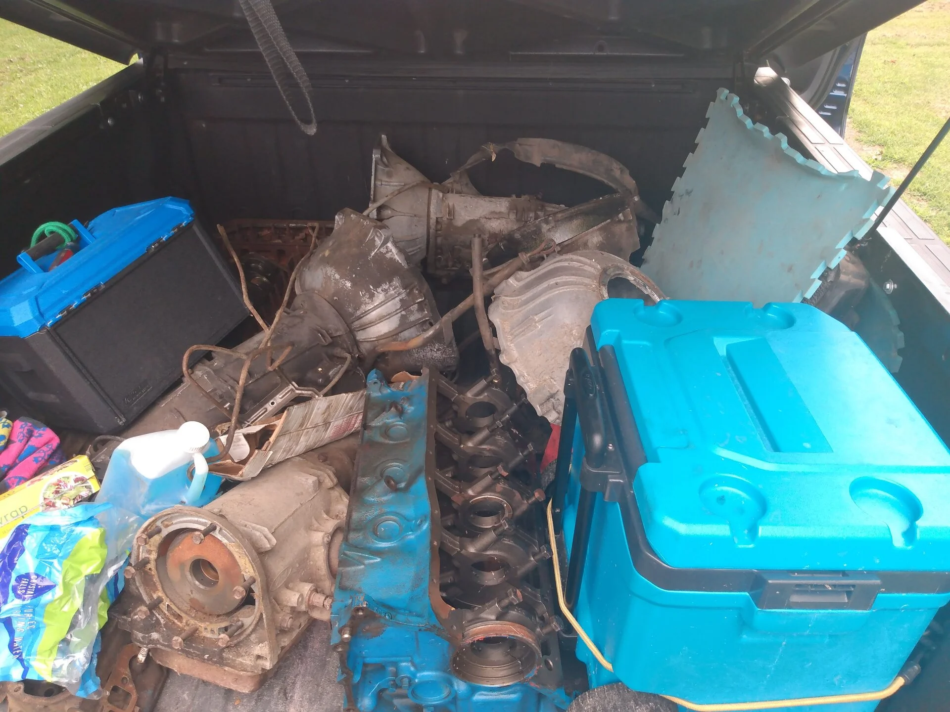

We ended up with brand new headers, MSD dizzy, a couple cams, 3 engines, one a roller block disassembled, Rebuildable D2OE Police Interceptor heads and running '68 351 heads. All kinds of little :poo:. Ps pumps, ac compressors. Two supposedly working carbs, a used Holly 600 and a freshly rebuilt Eddy 600, 2 performer 289 intakes. 4 C4 transmissions including one that supposedly is good and the one that originally came in the car. A truck bed, trailer, trunk and floorboards full of stuff. I think everything but some bolts to reassemble the car.

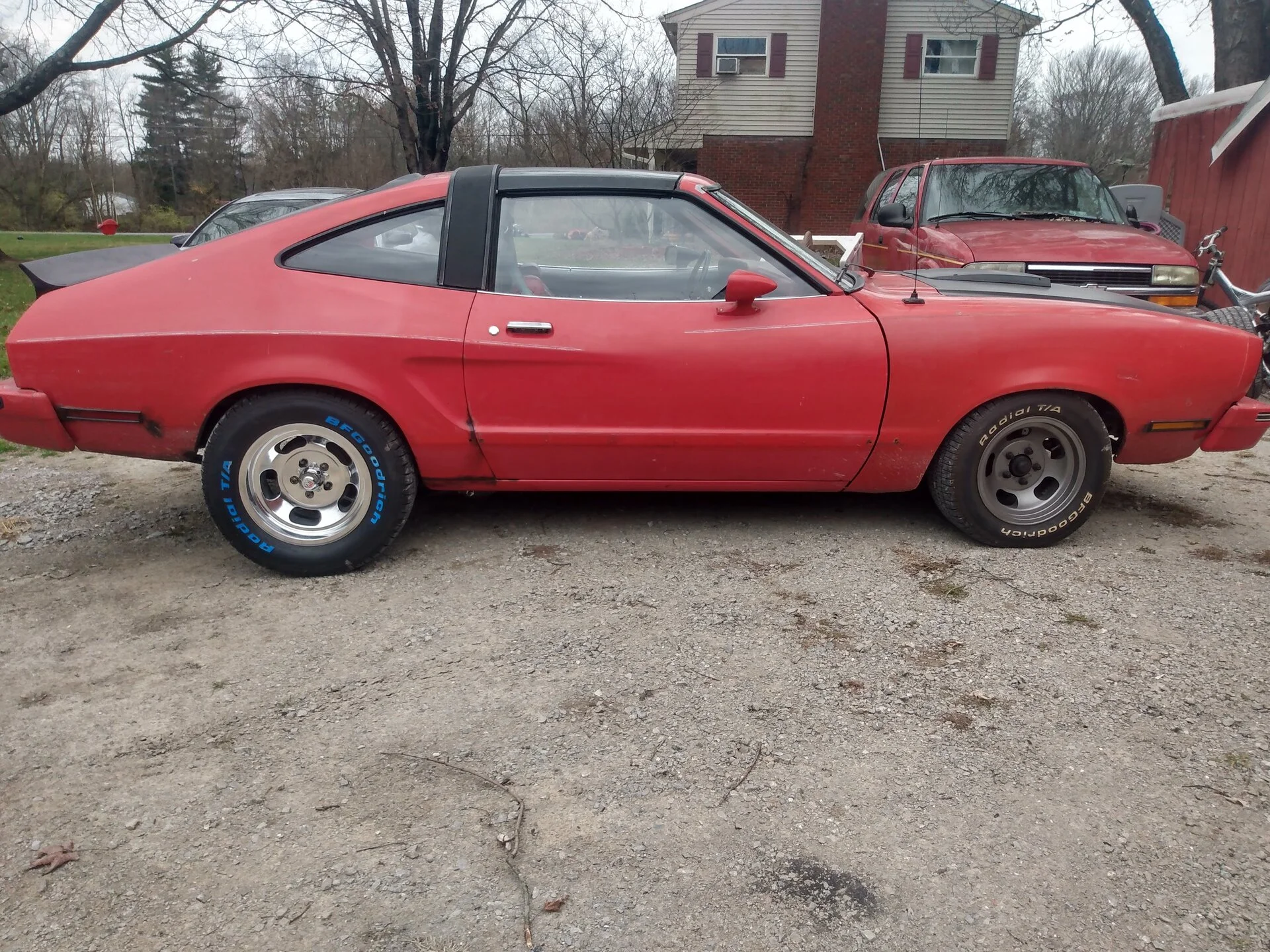

Oh yeah I said car. We got one of them too. It's a dark blue '76 coupe. Repainted years ago. She is a nice 20 footer. Has a couple rusty spots but was a texas car and the bottom looks like it was rhino lined. Someone had the interior redone probably 20 years ago. It's so so today but may clean up. It has a 3/4 vinyl top I am not super fond of in pics but it does work ok in person.
The story as I understand is the transmission went bad on the then owner. Car was left at a friends house which is the gentleman I bought it from. After a few years of sitting they pulled the engine to drop in a roller 351 and drag race it. Time elapsed between the removal of the old and the new engine being ready. The old running engine was sold to help fund the project. See where I am going here.
He didn't realize the oil pan problems these cars have. They sold the running engine oil pan and all. I saw 7 F150 or F250's's from the 50's to 90's at his place. Some gorgeous and some with patina. He knew them in and out. These cars not so much. None of his trucks have windsors so he gave me everything he collected in pursuit of turning the coupe into a drag car. As well as the running 302 engines he had taken out of his trucks for bigger engines. My trailer was so heavy I had to turn down E7 heads he claimed were low mileage. He just kept pulling out stuff. Anything windsor related. My trailer was so low I had to stop him.
The absolute best part of the trip was my sons wife fell in love with the coupe and was not happy when I said even if we had to part it out we made out like bandits. I have since been informed that parting out is not an option. Turns out it appears to be in really good shape so she is safe. Besides when the wives encourage the insanity what are we to do?
Today we started prepping to install the engine and trans into the Mach I to see how she runs. We turned an older block plate into a II block plate. Had the flywheel turned and mostly cleaned stuff. Hopefully the Mach is running in a few days depending on weather.
Here is the Mach I next to Christine with a couple pics of the coupe following. I will get more once my kid finally sends them to me. He took some after she had a bath with his phone since it does better pics.

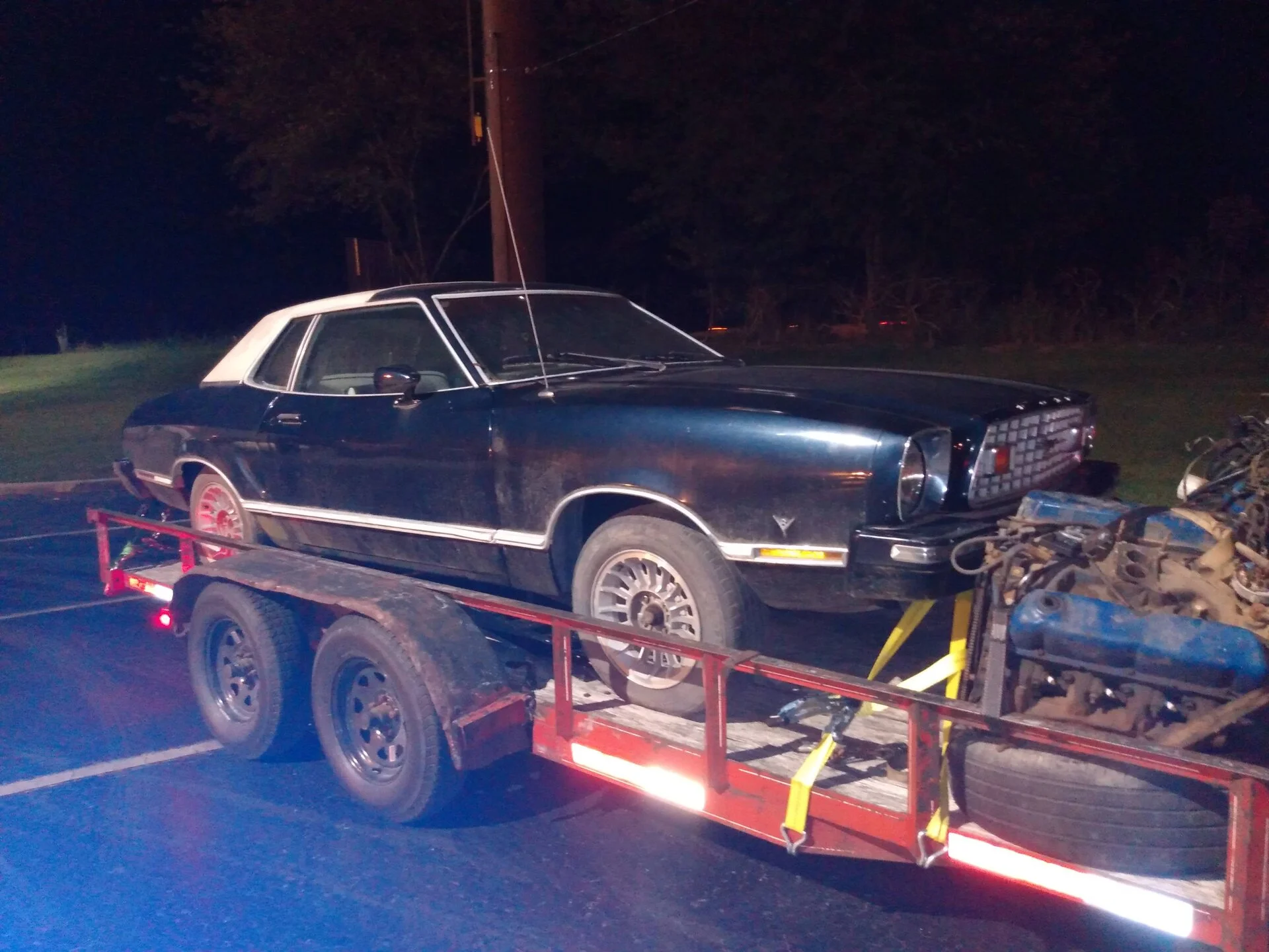

The blue coupe is next in line. I have a 79 302 short block as well as 2 sets of used heads. Picked up a Cobra with a blown 302 that was supposedly freshly rebuilt. We needed the oil pan, mounts and old school headers. The PO claimed the trans was freshly rebuilt as well. The hope is to raid the parts bin and make the coupe run. On the Cobra I found a nice hole in the oil pan, a rod cap with a bolt loose. Also found another cap and bearing destroyed in the oil pan. Engine looks very clean. Well except for metal shavings in the pan and shrapnel marks inside the pan and on the crank. My amateur sleuthing indicates they reused hardware or more likely failed to torque the rod bolts during the rebuild.
We also picked up a running orange v6 rust bucket t top car. Actually drove it onto and off of the trailer. The sub frame is rotted out and the car is starting to sag at the a door. Rotted floor boards were replaced with some kind of tin. Will be a parts car as it's a 4 speed car and the interior is in great shape and roof is still good.

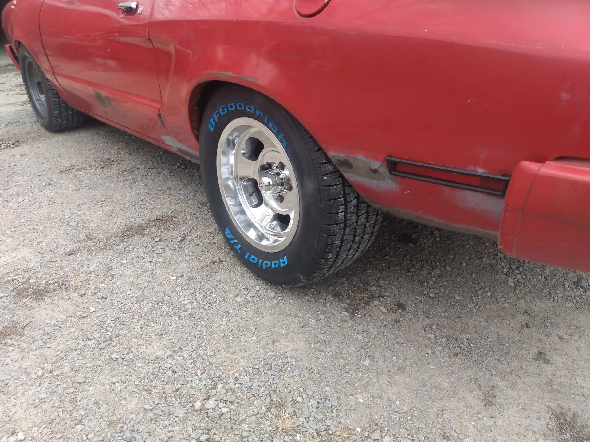

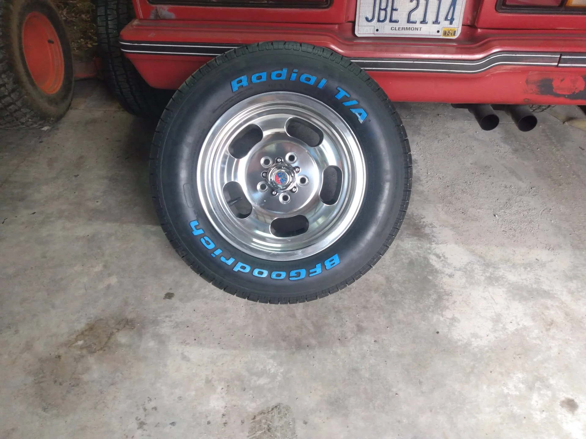

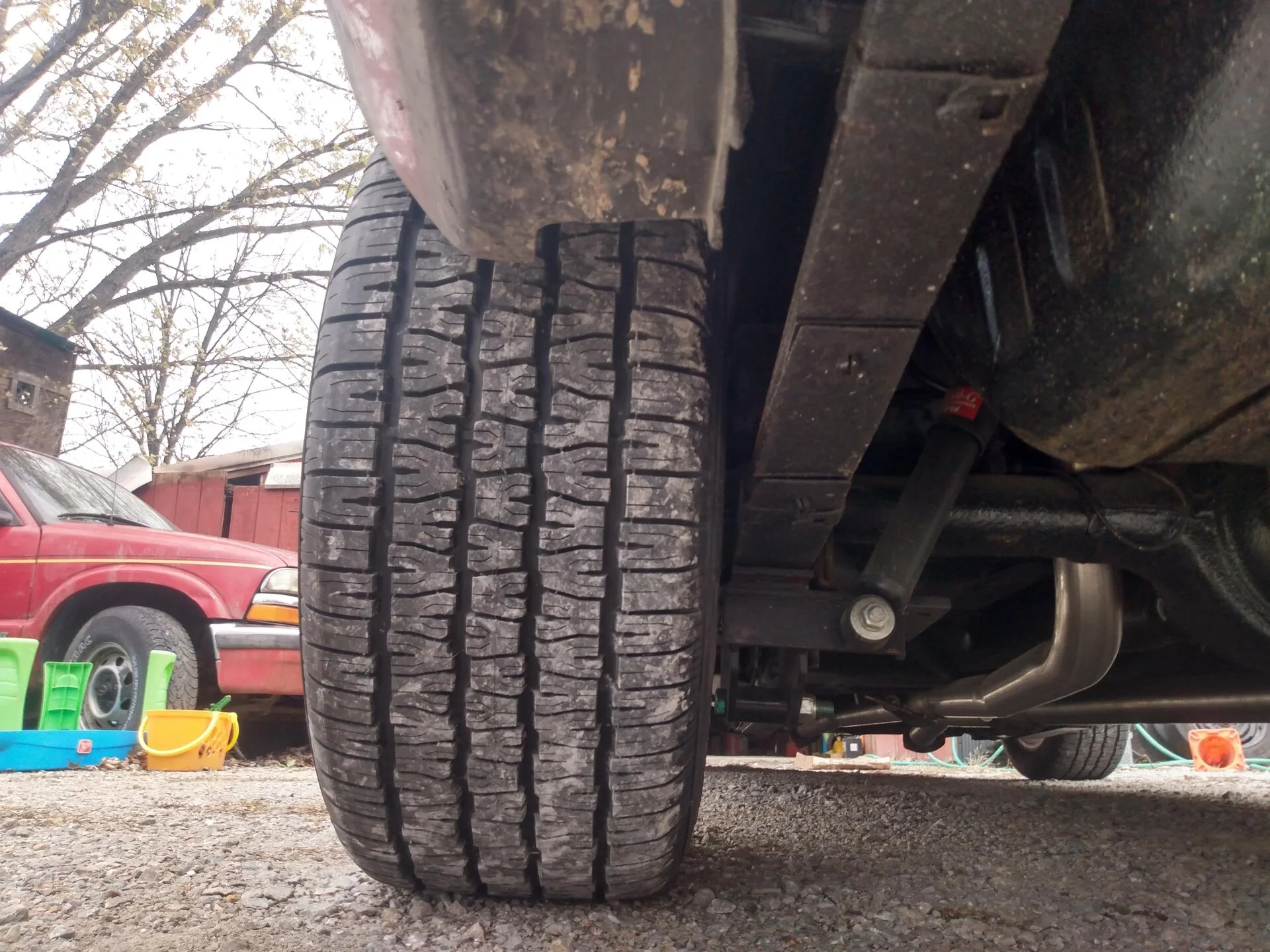

Picked up new rear wheels and tires. Went with US wheels 101 model. 15x8 with 4.5 backspacing. Picked up BFG 245/60R15. They rub at the quarter panel lip over bumps. I just received a fender reforming tool and will roll them over the next few days when my kid returns my heat gun. Inside I have plenty of room. IMO the 245/60 is a little too tall for my build. Width is perfect. I think a 245/55 or 50 would be perfect but none were available. 235/60 would be my next choice but I wanted as much width as possible.
The little local shop talked me into using balancing beads vs sticky weights. Time will tell how well that pans out but....
I only drove it a couple miles since it was rubbing on compression. Ran her to about 65 mph with minimal vibrations. The horrendous vibration at 1800 rpm in 5th is GONE!!!!!!!!!
Do I paint the new wheels or try and strip old fronts? Or better yet get new front wheels? hmmm.....
Don't laugh at the lug nuts. I am waiting on new ones and used what I had laying around here.

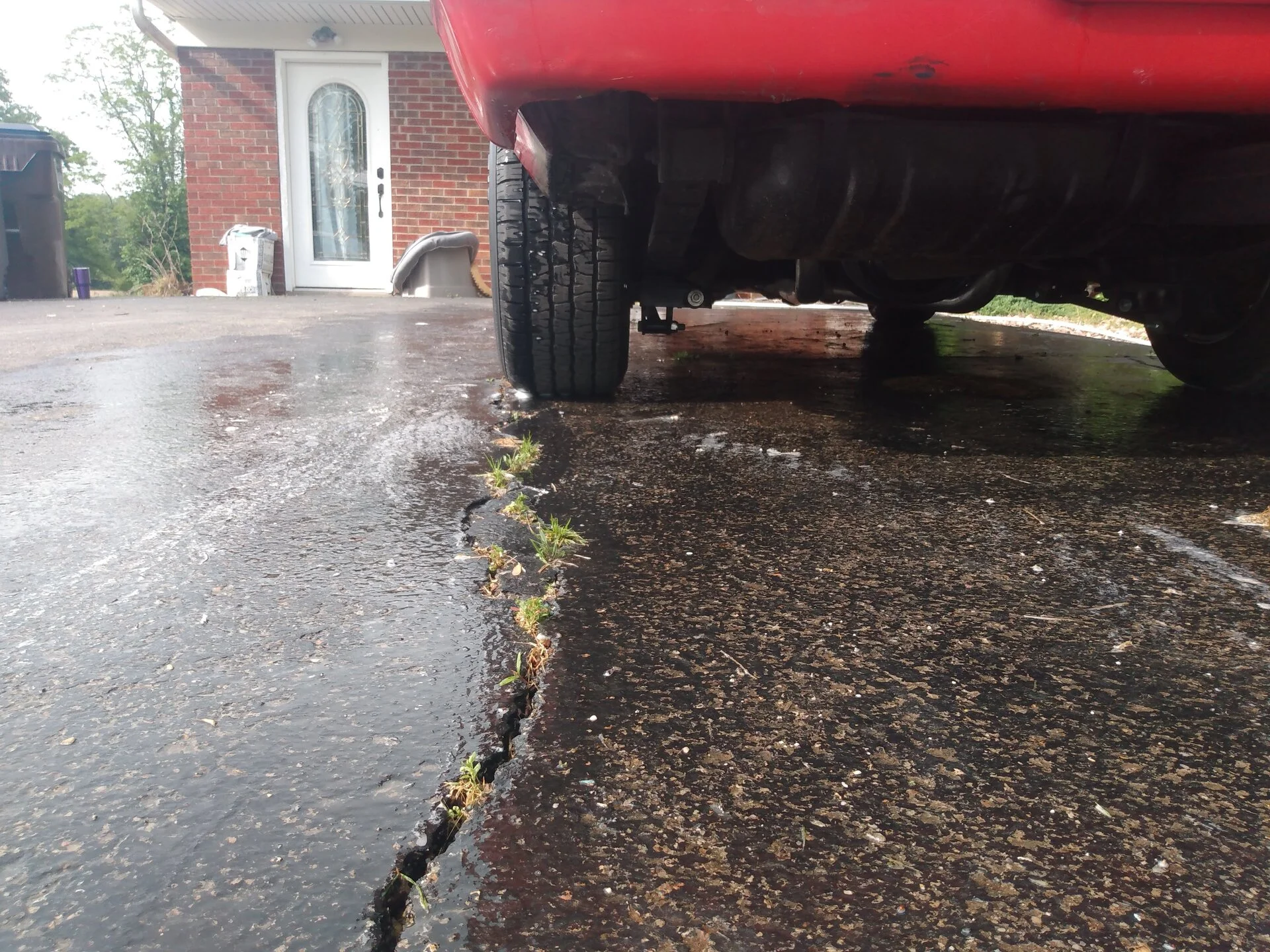

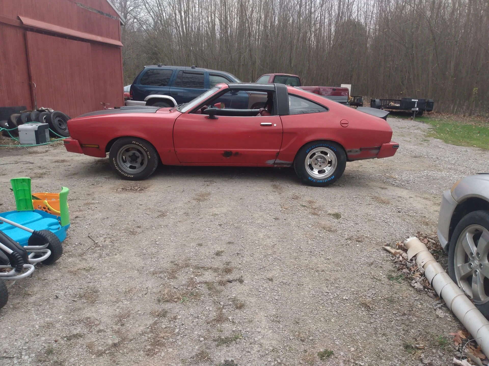

Yep. Stock springs. These pics the driveway slopes down. It's rainy here so I haven't gotten it on flat ground for a pic. I think I want to lower the back now. The old tires were 24.6" tall. These are 26.6. That's only an inch in actual car ride height but visually it appears to have risen a couple inches. I wasn't after the jacked up look. I will roll the fenders and drive it a bit but at the moment am thinking it's going to need lowered back down.
On the other hand..... I wonder if it's the color difference that makes the front look subtle vs the rears jumping out at me. They just look too attention grabbing for the theme on this car. hmm.
